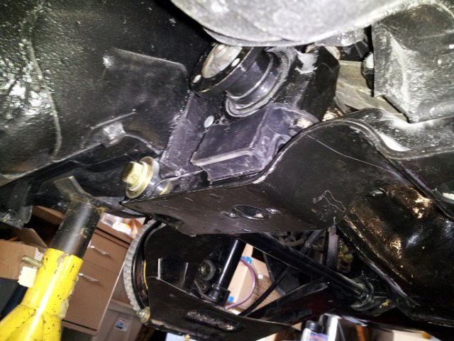

Keith, I may take you up on the call. I ordered the mount and insulator today from Brian at TechnoVersions. this is the same bushing your talking about correct. (PIC of bushing)
what about using the bumper stop that comes with the RT Mount? bad? as opposed to the top mounted one? also is the RT with upper mount a straight bolt up on a 70? no fabricating? I also received an email that 72 and later used different strap brackets that allowed the stock strap? Thanks for the info..

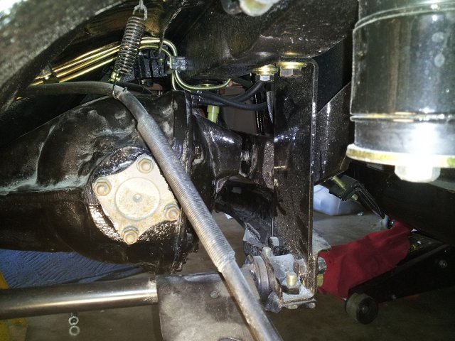

If the RT mount will solve my problems, I will buy one, but which is the correct way to mount this? I have read different things about turning the M-bar around. reversing the bottom mount moves the differential towards the back of the car. I have never heard any mention of removing the strap all together in all the stuff I have read on any sites. Can any one confirm wich way the stock mount mounts. the wider side towards the back or the front?
I am restoring a 1970 Z , I am doing a R200 swap, I bought the M-bar, Control arm Hanger, Front Crossmember, and the r200 differential from a 280z. I am having an issue figureing out the mounting procedure. I installed everything and the strap that goes on top of the differential wouldnt fit over the bolts that holds the insulator on the front differential crossmember. so I figured it was incorrect so I dropped everything back out, reversed the insulator because i thought I had it backward( I had the bigger part towards the front of the car) so I flipped the insulator around and the strap now fits, but the differential is a half an inch from the mustach bar. and the drive shaft doesnt fit now.(too long) I can not figure what part of this I have incorrect. Ive searched for info and found basic info, but nothing that address these issues. Chris

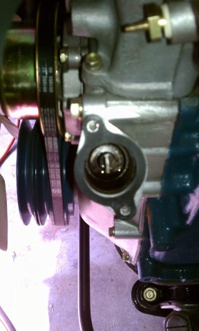

OK, Not sure why this made a difference, I move the distributer shaft over a tooth and reset the distributer to center. it stopped sputtering and with the choke on it will run 2000 to 2500 rpm. it will stay running now but will not idle or run at all with the choke off. -

I Checked all the above recomendations and nothing. Does the distributer drive look like it could be a tooth off? -

found the issue, the condenser that came on the rebuilt distributer was defective. now i cant get the car to idle below 1200rpm... -
