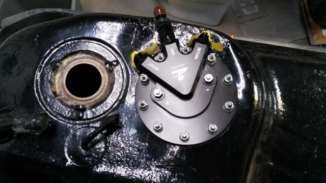

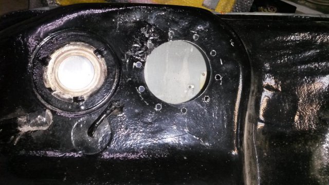

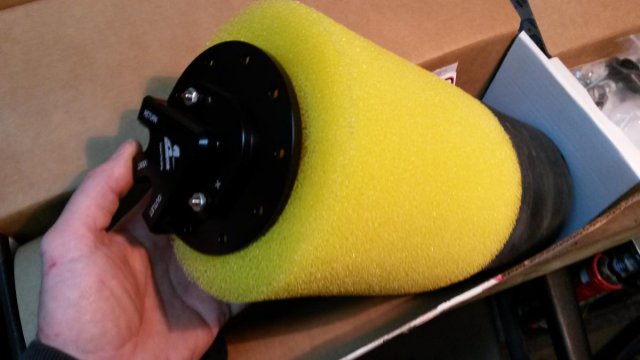

  2. I forgot to mention that the extension kit was not required, I mounted the pump in the deepest portion of the tank (save for that odd elongated hump at the very front of the tank ahead of the sending unit) and it was just the right length without trimming. Some slight compression of the foam at the very top.
  3. Not an EFI conversion per se, just eliminating the external pump in favor of the internal phantom system. This was in a 280z stock tank, and wasn't the easiest to fit. The best place for it required rotation and slight modification of the sending unit to clear the foam baffle, some reshaping of the small hump present in the tank just where the pump goes, and plugging the original supply/return lines. I also removed the supply/return lines and the swirl pot from inside the tank. Only the vent lines remain. This left the supply/return/vent from the aeromotive pump facing rearwards, so I made some hardlines to route the connections around the tank under the filler neck to the front of the tank and connect to the new 3/8 fuel lines under the floor pan. I can't find any pictures of that at the moment. It performed well when tested, but haven't driven the car yet with this setup partially because of other work I'm still doing with the car and I have the great misfortune of living in a winter climate. I'd be interested to see what others have done with this pump arrangement as well.

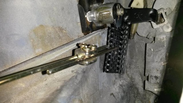

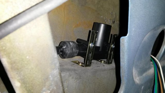

  5. I used a generic Autoloc two door kit for my wife's 280Z. Welded some 1/8 inch steel mesh to the bottom of the key tumbler arm to connect to the lock solenoid. Gave lots of adjustment options. There was so much wear and slop in the joint of the key cylinder and the actuator arm that i had to weld a shim in place to avoid movement in unwanted directions. Also had to reverse the wiring to the soleniods as in this setup the controller default operation was the opposite of the lock/unlock operation. Sorry if the pictures are unclear, I could only get my phone inside the door as there was no room for a quality camera.
