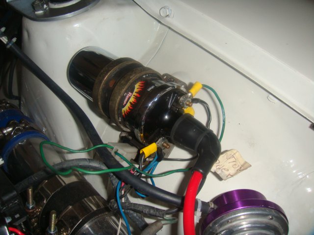

guys my mystake the cable does have power with the key fully turned. but i did noticed that i got power of both side of the coil - and +??? Im using 280zx turbo ignater with megasquirt. -

hi guys, yes no spark yet, cant figured out whats wrong, but i do remember having power to that wired few days ago, and now nada, nothing. -

Hi, I remember having power on the black/ white stripe cable that goes to the + on the coil today no power at all can some help me please? thanks, J.

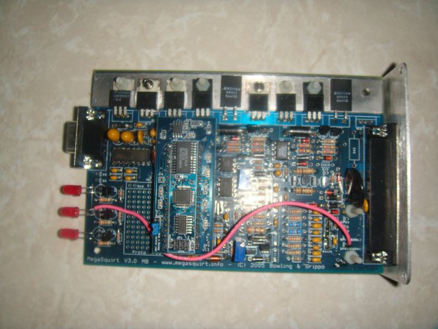

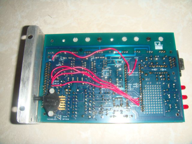

I just intalled a ms2 v3.0 mainboard with the the 280zxt ignater and got no spark please help...
I got no spark any ideas?
