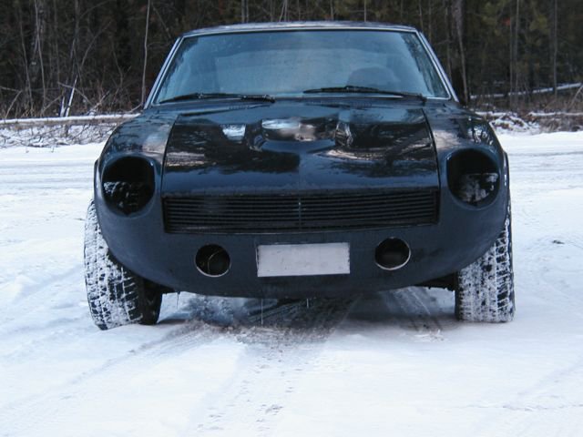

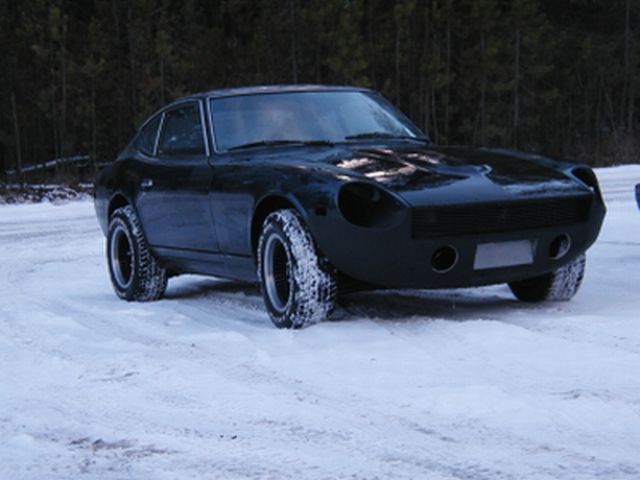

I started with it open with split bumpers but couldn't build a grill that looked good. This is where I ended up. I really like the frontend pic on the hybridz entry page. I wanted mine to look like that. I ended up with some fiberglass and steel to come up with this. I thought that maybe if I add lights it would break it up a little. anyway I would like to break it up, but how thats why I started this thread. Thanks for the comments
Do you think I should break up the front end with some lights? I have some outlined on the front.
Well I need some help with the front of my car what do you guys think. I sorta think it looks like a boat. I also included pics of the rear and pics of engine. help please!!!
