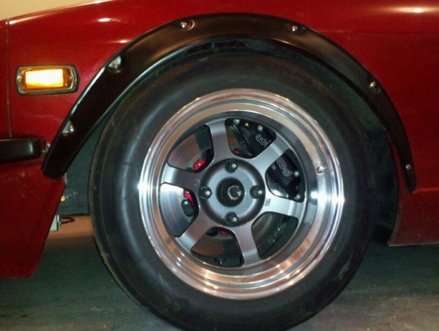

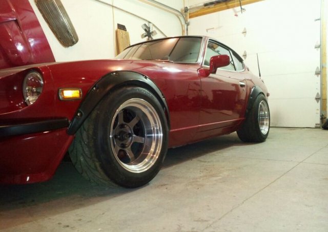

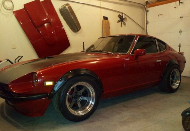

Not sure if I ever posted the pics of the volk te37v wheels or not. 15x10 with 4" backspacing and toyo r888 235/50/15 all the way around. I know I was doing some work and the front tires need to get swapped, they are on the wrong side. oops, tgried to edit and ended up with 2 posts -

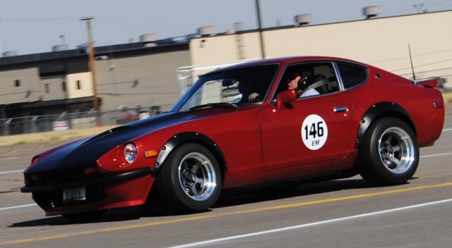

Thanks for all the input. The car was initially built for street fun and a friend of mine turned me on to autox, damn him. I've got about 700 miles on the car since finishing it and 650 of those have to do with racing, either driving to or racing. I'm confused about the XP class. Me and a buddy built z cars, his with a traditional SBC and mine with ls1. After our 1st season we were told we HAD to go to EM class by a veteran member because we were not running corperate motors? I have adjustable A-arms so I believe that may keep me from SM class? Being new we did not question the switch but I would certainly prefer XP. I'll have to do some research to prove this guy wrong I guess. As far as the car goes I don't mind it being for race mostly, I've got other projects for street duty. The picture there is while slowing down and that is when I experience the loss of control in the rear. I did have about an 1.25" rake in the car front to back measured at the seams. I've adjusted that to 1/2 ", lowering the rear. The car is pushing a little over 500HP One of the surfaces we run on the most is concrete like shown in the pic, this is where I notice the problem but it is also alot faster track. The poly bushings are only on the inboard side because I'm running TTT control arms and tension rods. Thanks everyone -
I've finally got a couple seasons of autocrossing under my belt and am looking for suggestions. The car has been one progression after another toward racing. The car started as a street driver, as a result I've done everything twice. It's an ls1 car with 6 speed and a quafie r200 with wolf racing 1/2 shafts, adjustable a a-arms all the way around and adjustable tension rods. I've sectioned the struts and am running coilovers with 225F/250R springs. Also wilwoods all the way around, weld in camber plates in the front and none in the rear but run about 2.2* camber in the rear with a arm adjustment. I'm looking to increase the spring rates. I've noticed that some are running more spring in the front and some are running more spring in the rear. What makes the determination? I haven't stiffened the frame yet and was wondering how stiff you might recommend? Also am I doing the right thing by running poly bushings? The car weighs right at 2850 lbs with driver and is 1475 in the rear with me in it and 1/2 tank gas. Any input would be appreciated. This photo shows some of the issues I'd like to address. The picture was taken on a 50 mph transition. The car has way to much lean. I also experienced the rear of the car breaking loose at higher speed corners. I'm running Tokico adjustables all the way around. 1" sway in the front and 5/8" in the rear lossened up a bit.

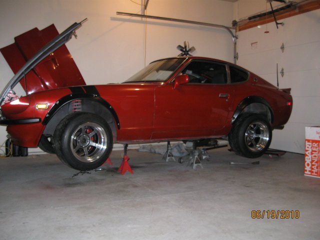

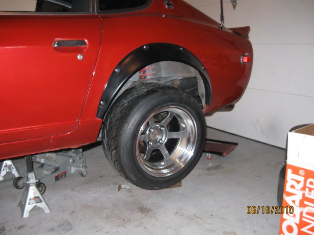

Yes, I was test fitting the 235 on the front with the other rear tire -

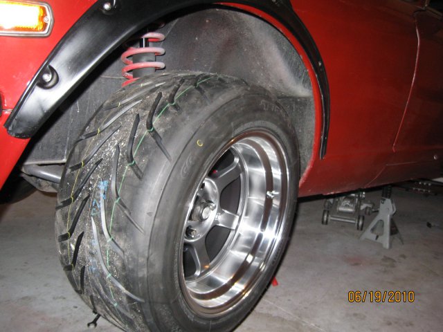

Couldn't resist the new Volk TE37V. I'll post more when I get it on the ground.15x10 4" back spacing with 235/50-15 r888's front and rear. I had it there the other day but I'm working on changing to 3.90 gears this week before next sundays race. -

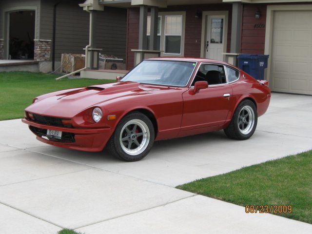

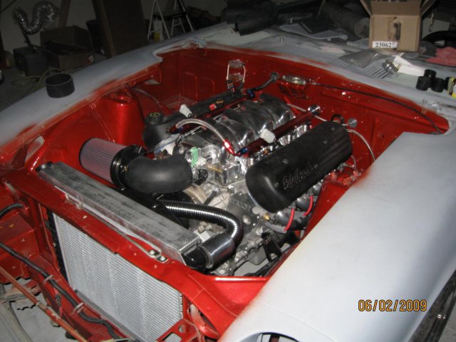

1. This is a 1975 280z with an LS1 and T56. 2. I used Johns car kit for motor/tranny mounts and driveshaft. 3. I used a camero ls plastic tank and pump. The motor has Patriot 205 heads, comp cams 11-424 cam (558 lift), 85 mm throttle body on a Professional Products manifold. 30lb injectors with 75lbs of pressure. MSD Blaster coils. Sanderson headers 2.5 inch into a single 3 inch. 4. I started on January1st 2009 and just finished in August 2009 5. Other mods include tokico adjustable shocks and springs. Toyota 4x4 front calipers and maxima rear disc brake setup. 2+2 brake booster. polyurethan bushings. Quaife rearend and Wolf Racing cv halfshafts. also bigger swaybars.
