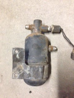

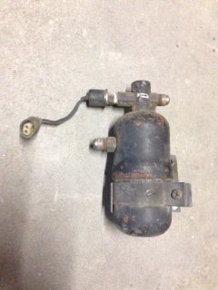

I didn't know that. R12 I believe is hard to find as I live in California and I think it's probably illegal here. Or very expensive at best. Any ideas on a pressure switch that will work with original type drier? If I can get R12 for a fair price I understand it actually is better than R134. If that's the case I will stick with the R12.
Thanks, I'll start looking for one with the 1/4" NPT female port. I really want to keep it original looking. I have the original Receiver/drier and wonder if it can be checked to see if it is still good. Was supposedly just removed from a closed system as all the other components I bought from a salvaged 75 280z. Thanks again for your help.
I have an a/c system for my 1975 280z that is a factory type that cam out of another 75 280z. I've been told that I should replace the receiver drier since it is 40 years old and probably no good. Problem is it has the low pressure switch and all the new ones do not have this provision along with the same fittings for the copper tubing. I did find a few places that say they have the correct replacement but after trying to buy one they are out of stock. None of the dealers have them either. Anyone have a solution other than swapping out for aftermarket and trying to retro fit the copper lines? Also way to add a low pressure switch that will work with the factory harness? I'm open to suggestions but if you have done this I am all ears.......thanks
The problem with the dryer replacement is the connections. They don't line up with the old dryer and the pressure switch is non-existent. Maybe there is a different way to hook up the pressure switch? My a/c system is not in the car as my 75 never had a/c so I am going by all the parts I collected and also the diagram of how they should fit including Nissan part numbers. I have never had any experience with either r12 or r134a. Nor installing a/c in a car. This is all new to me but starting to learn. I would like to keep it original if possible but I don't want to sacrifice cooling. I did do the Kia blower upgrade and was told I need to replace the dryer and try to find a larger condenser. Thanks....
The only issue I have with leaving the hard lines is the receiver/dryer need replacing so I will not be able to find one that works with the existing fittings and lines.
Due to new 0-ring fittings.....
