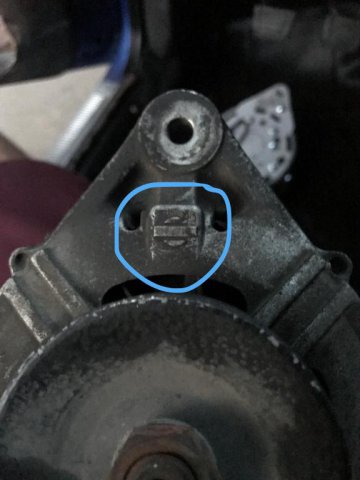

  11. I got the 300zx alternator which was, in fact, an exact match. I just took out the old one, popped in the new one, connected the wires and looks like everything is working great! Thanks again NewZed!
  12. Thank you NewZed ! I returned the 280zx alternator and ordered the 300zx one. I have no idea how you figured out that's what it was but you saved me from doing something stupid and probably downgrading my car. Thanks a lot!
  13. I only had the car for maybe two weeks before I left the headlights on and the battery died. I jumped it, drive it around for a while but the the battery kept dying. The alternator was only putting out 12.4 volts (if I remember correctly) to the battery. I didn't test the alternator before any of this. I would replace it with the same one as was in there but I don't know what it is. I looked it over but i can't find any numbers or anything. All i found was this: Which kinda looks like the Datsun symbol to me.
