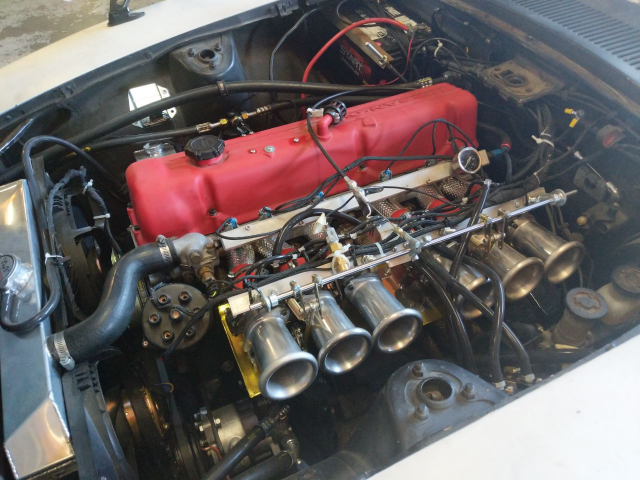

I don't know anything about the bottom end of the engine, just that the block is stamped L26 and it has flat pistons. The head is a N42 that I only had rebuilt and got a Isky L-490 cam on, as well as new valve springs etc. Didn't do any head work. The header is a "Top end performance" 6-2-1, with mostly a straight section with followed by a relatively small magnaflow muffler.

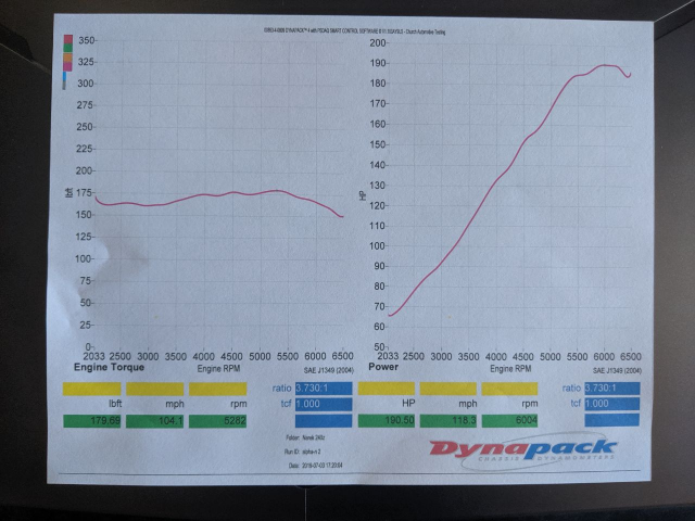

Besides that its just the whole EFI / ITB setup. I'm honestly very surprised how much power it made, I was expecting 160-170ish. -
Finally hit the dyno, made 190 horsepower to the wheels. Very happy with the results.

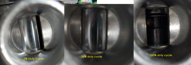

I'm really scratching my head over this. I swapped out the IAC with a new one. Car idles stable at 550 rpms, but regardless of what the IAC is doing, the RPMs don't change. The valve is physically opening and closing when commanded by the ECU. (click the pic for better quality)
At fully closed, the valve is still moving air through it. At fully open, the valve is still moving the same amount of air through it. Blocking the valve with my hand kills airflow to the engine and stalls it. Car is warmed up to temp and idling stable in the log. The only possible thing I can think of is the plumbing from the IAC to the ITBs isn't large enough to move enough air, but I seriously doubt this is it. Any ideas? -
99hz. The valve moves as expected, and responds to ECU commands. I just wasn't getting a change in RPM, which lead me to believe I had a vacuum leak. Which made me check the valve at "closed" and it was still pulling in air.
I got in a new IAC, but haven't had a chance to mess with it yet. I'll try your suggestion this weekend, thanks for the input. My bigger issue is that I wasn't really getting any change in idle speed regardless of the position of the idle valve, which leads me to believe I may have a vacuum leak to hunt down as well.
It's driven from the megasquirt and behaving as it should. At 0% duty cycle, its slightly open. At 35% duty cycle, its fully closed. At 100% duty cycle, its fully open. The 0% slightly open mode is a fail safe mode.

Here is my valve, as you can see at 35% duty cycle, its closed. But it seems to not actually be sealing shut.

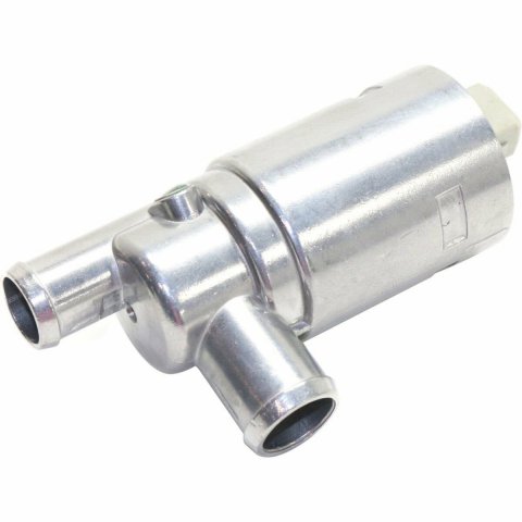

I have a question about Bosch Idle valves if someone might have some experience with them. I'm using a bosch IAC out of a early 2000s VW (pictured below). The valve behaves as expected, and I can see it close at the proper duty cycles. However, it's only effecting my idle by about 50 rpm. If I put my thumb infront of the idle hole, I can still feel a lot of air being sucked in through the valve even when its fully closed. If I fully cover the IAC intake, the engine shuts down. Are these valves supposed to seal at fully closed? Or do they still leak air by? I think I might have a defective valve.

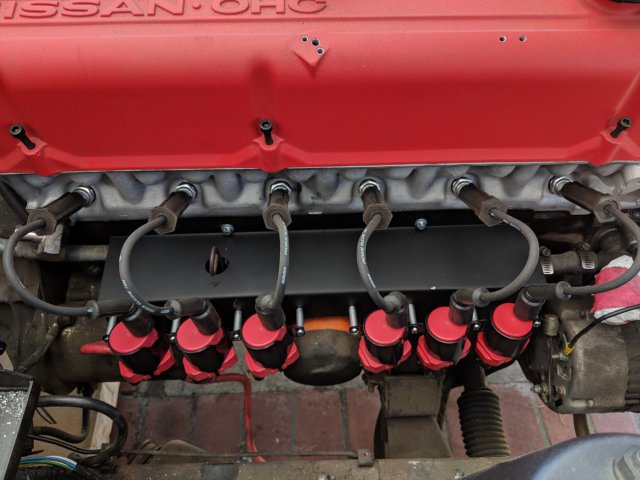

But I had some time this afternoon so I made a mount for the coil packs and got that done. There has also been progress on wiring. chassis re-wiring is done. Need to finish up gauges and tie it all in with the engine harness. Slow and steady.
