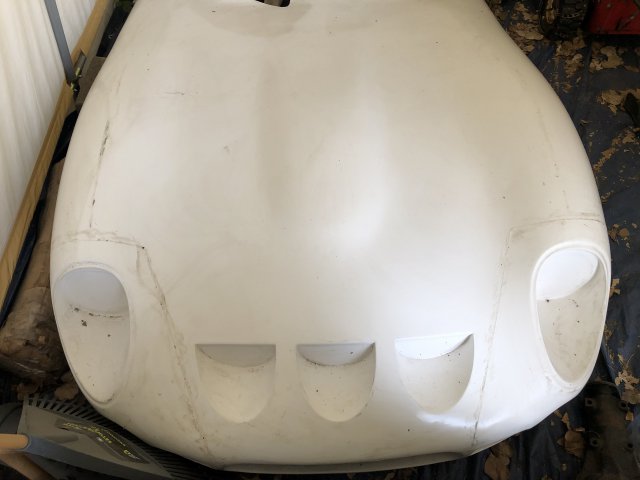

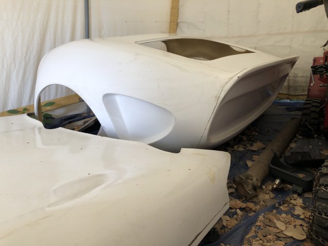

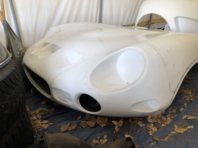

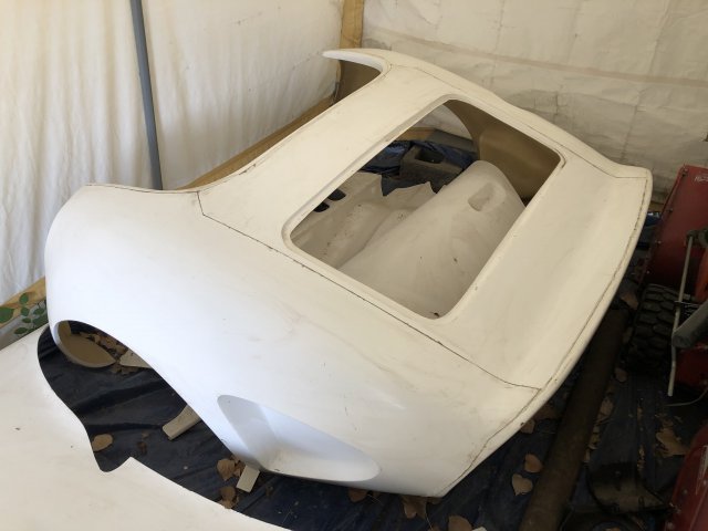

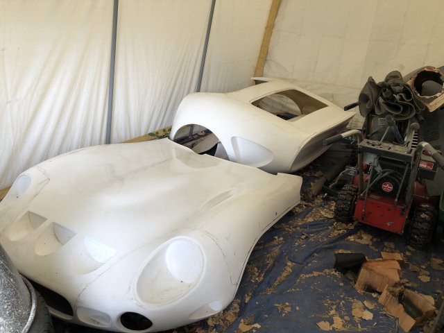

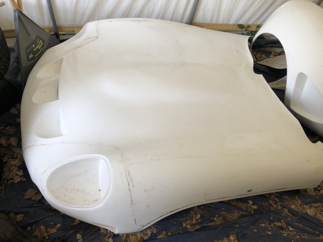

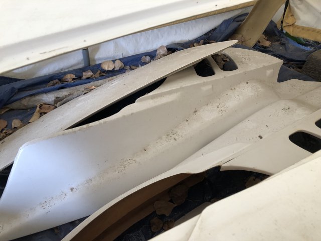

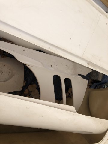

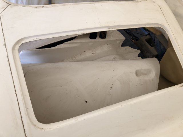

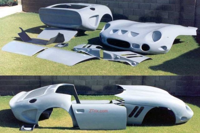

Velo Rossa Complete Fiberglass Kit · one-piece front bonnet · bonnet hinge reinforcing ring · bonnet hinge bracket · bonnet hinge pins · cheek (side) panels · bond-on door skins · bond-on header cap (top of windshield) · bond-on rear clip (aka "tub") · trunk lid with pre-bonded inner reinforcing https://www.ztrix.com/rebody-kit/velo-rossa/ This kit is has never been sanded mounted or cut, everything is untouched. The kit was made to special order the panels were made thicker then ordering a normal kit. **No Donor car kit only** Asking $5300 CAD for the complete package So roughly $4000 USD Located in Regina, Saskatchewan, Canada
