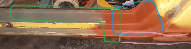

Rocker panel - replace all, or just what is needed?
Roberts280Z replied to Roberts280Z's topic in Fabrication / Welding
Thanks for the interest, Jughead. This is where I am now. I cut out the green-outlined section from the Tabco rocker and welded in. I fabricated the blue-outlined 'armpit' section and welded in. Then I covered the rear, pink-outlined, section with the lower part of a Tabco patch panel. I've spent the last few weeks on another car, but will come back to this after I get another bottle of shielding gas. I've still got the door bottoms and tailgate bottom to do, plus join up the floor bottom frame rails to the remaining front frame rails. -

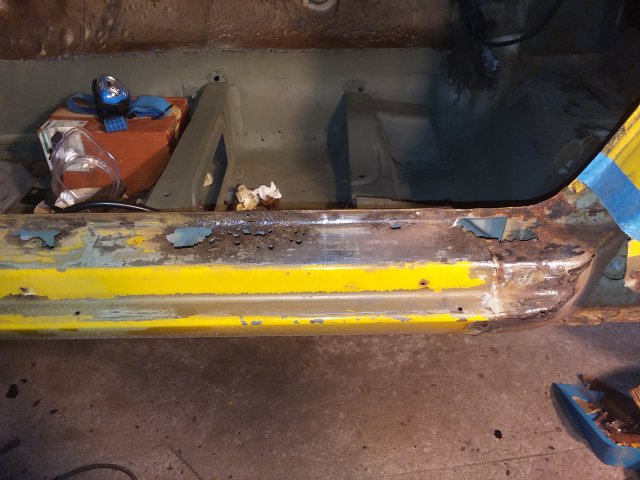

Ha! My welding and fab experience has been gained solely from this Datsun! So far I've fab'ed and welded in patches for the top fronts of both front fenders, and a couple of other places, and welded in the driver's side floor and rail. I think I'll just continue with the passenger side floor while I ponder more on the rocker. I'm not in any big hurry - I've been at it on this car for over a year, and I just retired totally a couple of months ago so I have even more time now. This Z might not be worth restoring, but I bought it new in '76, and feel guilty about letting it turn to crap. It is a bit concerning that the tim.d photos don't show much worse damage in the rocker sill area than mine. I'll cut away more of the sill with the initial thought that I can just patch that area, which will also give me a better look at what's beneath. But so far what I see looks good. BTW thanks tim.d for those photos - I've seen plenty of floor pan videos and photos, but hadn't seen your rocker photos before. -
