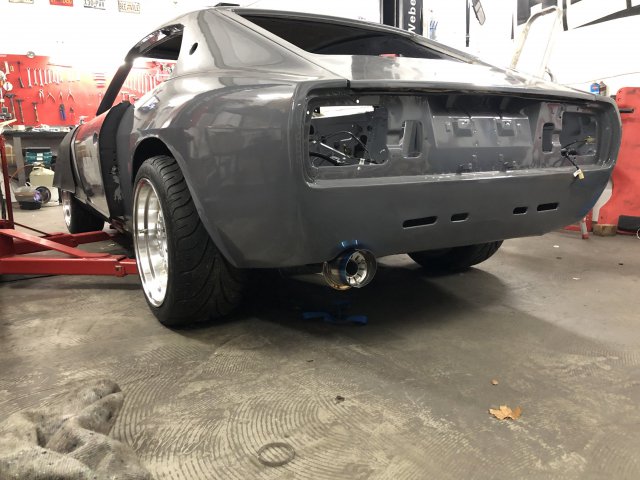

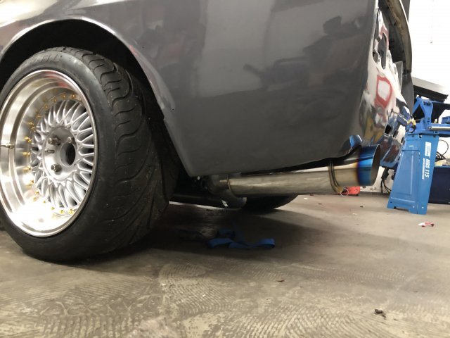

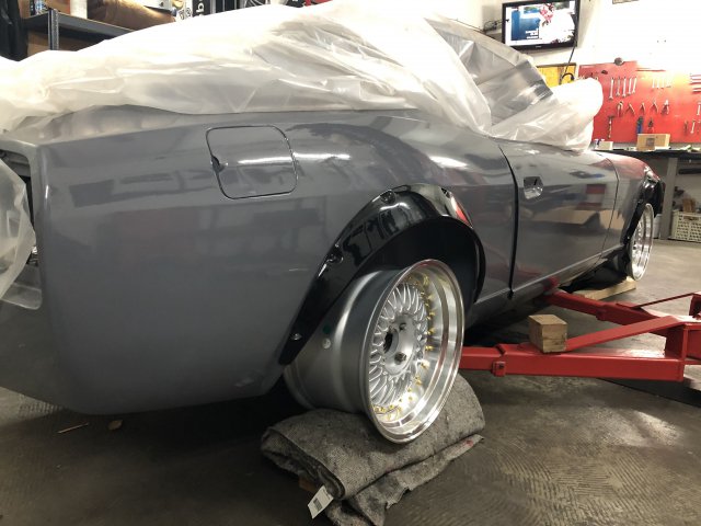

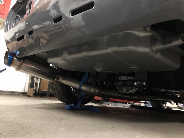

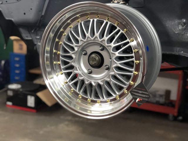

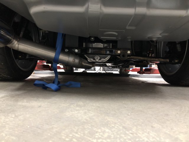

Hi Guys, got my Wheels testfitted and i think i Need some spacers 😅 Also tacked my Exhaust Have a nice Sunday.

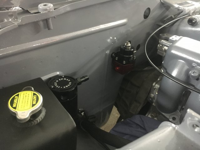

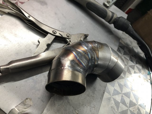

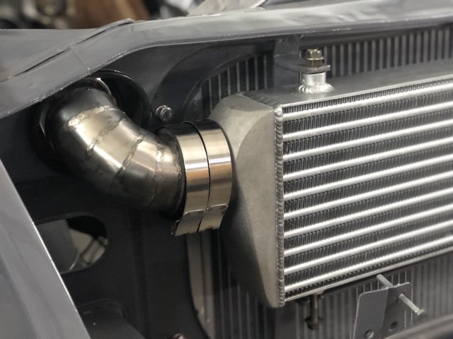

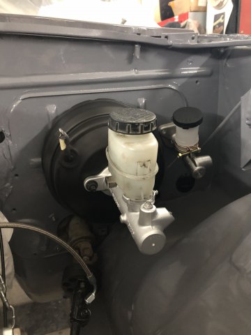

Hey guys, just some Little Updates. Throw in my bake and clutch boosters and make a Little part of the boost Pipes. Not the best Weld in Earth but i‘m still learning.

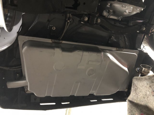

I Had cutted my spare tyre trough because it was Rusty and i had looked for a new one with a straight upside and this is What i found 😁
Hey, i dont think that the car would be too light. There is no too light, only not enough grip😁 Surely the Tank dont fit direkt. My wheels are 8.5/10x17 with 225/255 Semi Slicks. Dont know the size of the Spacers der, will See After tyres are fitted.

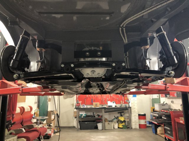

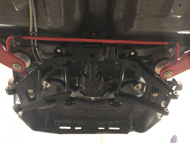

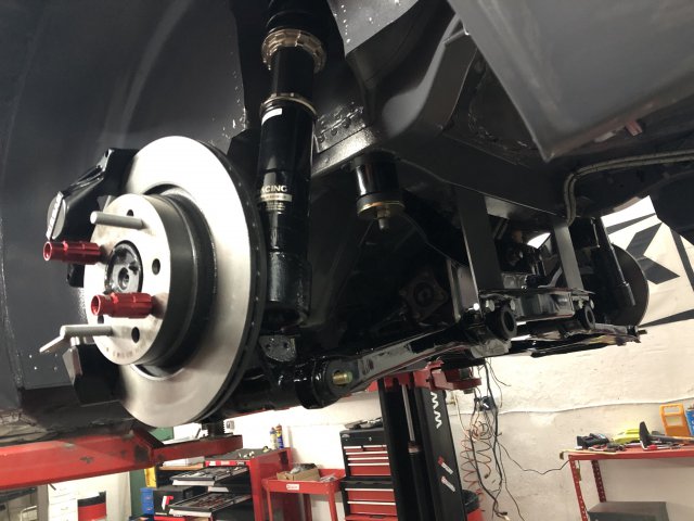

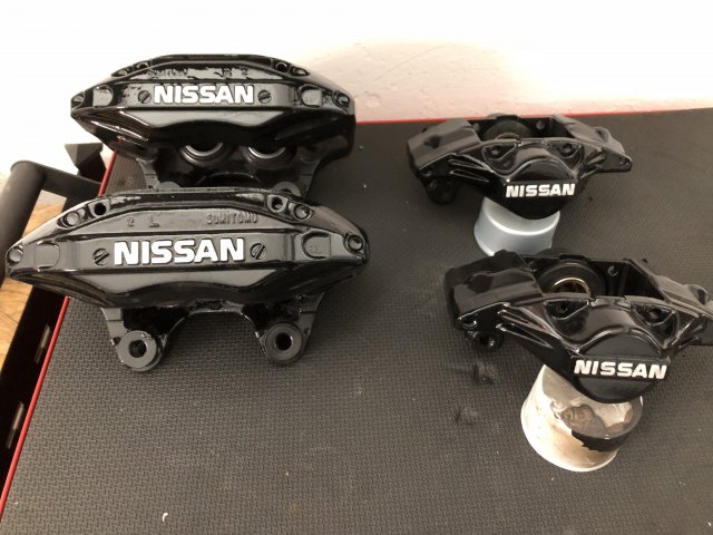

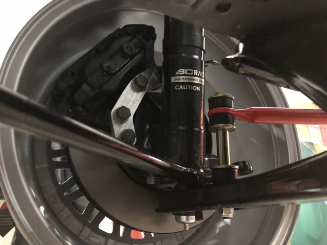

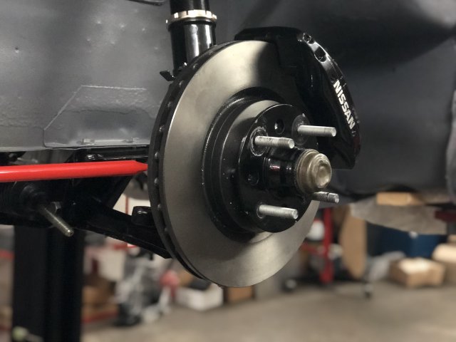

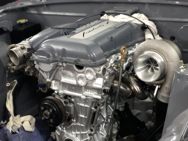

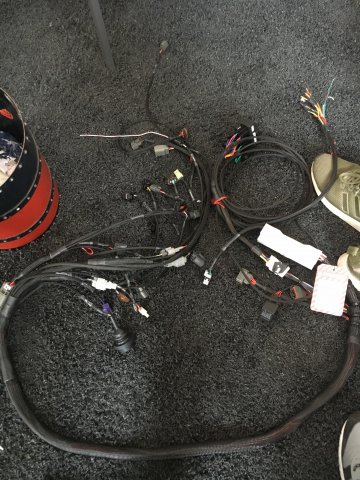

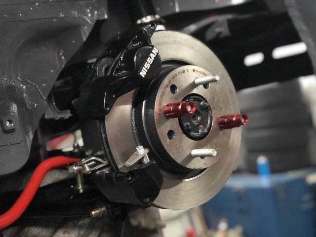

Hi Guys, long some time is gone with no updates but now i found some time for new contend. Got my Car back from the Painter in the 10/10/18, about 2 months later then I thought but who cares.. First things First, drop in the fresh painted engine with the new Garrett Honeywell GT28R Turbo. and some Cooling... Time to throw in the Axles, all Powdercoated or painted with new Poly Bushings all around and a nice BC Racing Coilover kit. To Stop my little Grey Mouse I choose a complete Skyline R33 GSTS Brake Setup with Handmade Brackets. 313mm at the Front / Must be around 12" and 303mm / a little under 12" at the rear with an extra E-Brake Caliper. I Love that look The new Fuel Cell comes from an VW Derby. My new AEM Fuel Pump actually just waits for install. Sone random Shots: Love that aggressive Look.. I think just a little isolation is ok, for my Girlfriend The Wiring Specialities Harness is just PartPo*n.. I think I need some Plates So clean, maybe I just park the car in the living room and look at at... More Pictures and Infos in the next days. Happy new Year 4 all of you Alex

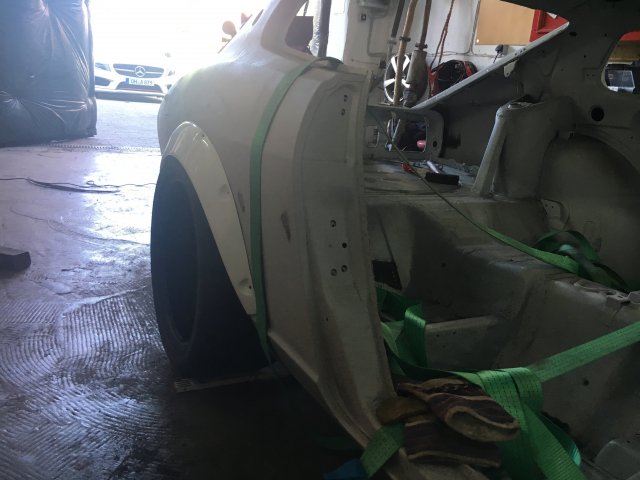

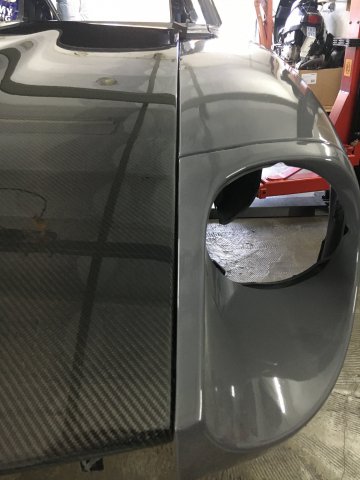

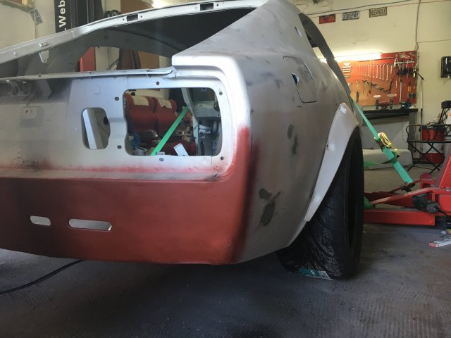

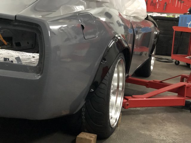

That I´ll take the 2+2 was not planned, it can grab it for a very good price. An I like the 2+2, think it looks a little more massive in the rear. I mounted the Flares by following the shape of them. What you can't see in the photos is, that they are a little bit curved on the top so that way is the only way to mount them "flush" Ich glaube wir können das ja auch auf deutsch machen Ja, du hast da recht, 210/211 Ps ist das, was ich darf. Ich mach den Import-Tuning-Krempel schon 10 Jahre und hab ganz gute Connections zum Tüv, aber seit ein paar Jahren stellen die sich mit der Leistung auch ziemlich an. Jetzt ist es so das ich die Leistung eingetragen bekomme, welche der Dyno ausspuckt und irgendwo zwischen Serienleistung des SR20 und den 210Ps liegt, zusätzlich werden LLK, Auspuff, etc eingetragen. Was am ende wirklich dabei raus kommt muss ja keiner wissen. Das war einer der Gründe warum es kein RB geworden ist, wobei ich mittlerweile mit der Wahl ganz glücklich bin aufgrund Gewicht, Gewichtsverteilung etc. Bei deinem wäre dann, zumindest auf offiziellem Weg, nur der CA18 möglich, wobei ob man den haben will steht auf nem anderen Blatt.

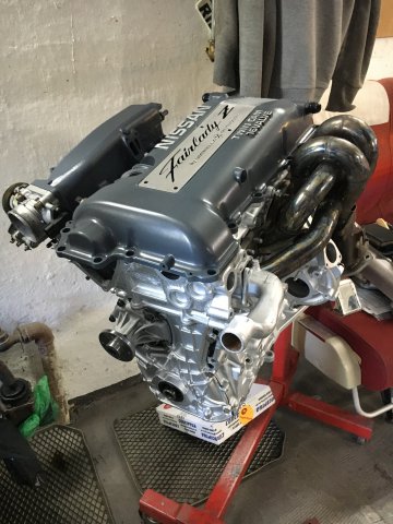

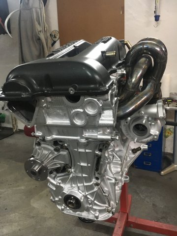

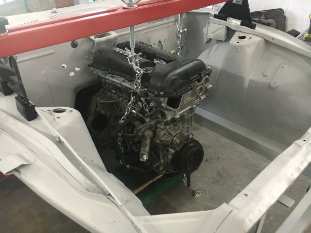

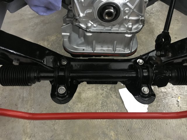

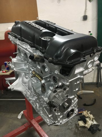

Hi Folks, nothing too interesting cause of other cars but I had started to assemble my engine for the Z. Think it looks not so bad.

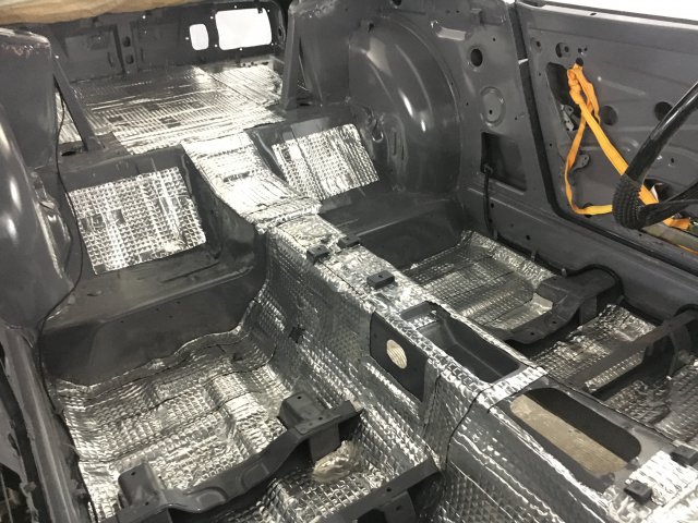

Nothing Major happened, but the car is at the paintshop Will get it back in 3-4 Weeks, I´m so excited. This weekend I will give my 1987 Honda Melody Scooter a little engine rebuild and had some costumer projects but next week the engine build and restoration of the interior will start

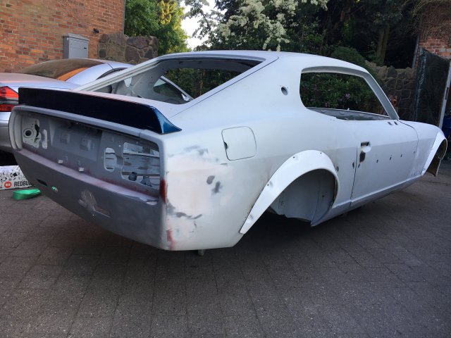

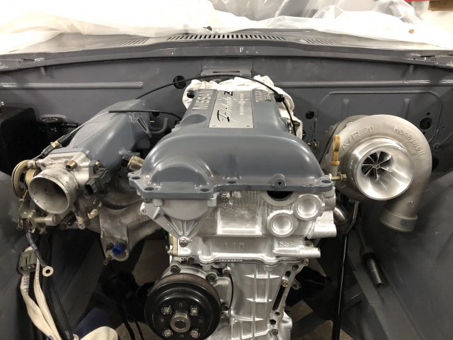

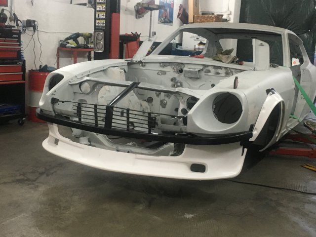

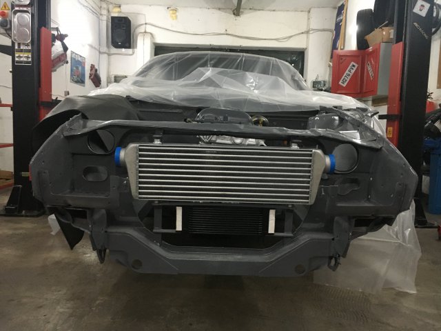

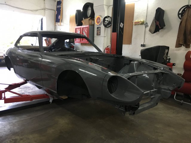

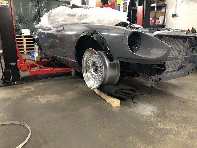

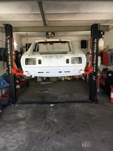

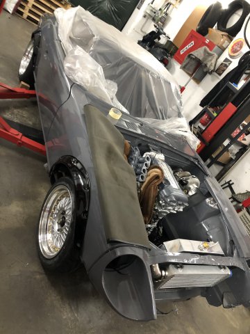

Hi Guys, little update: Had the engine testfittend this Week and install the front flares. Now the car is ready for the new paint. It would be RAL 7015 Slate Grey. The engine looks so sweet in this huge engine bay but with the lines, hoses and ancillaries it would be nice and look very tidy. Tomorrow the car goes to the paintshop and I would start to work on the engine. All the axles are back from the coating so I can trow them together until car comes back Updates from engine and interior will come soon.

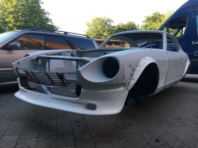

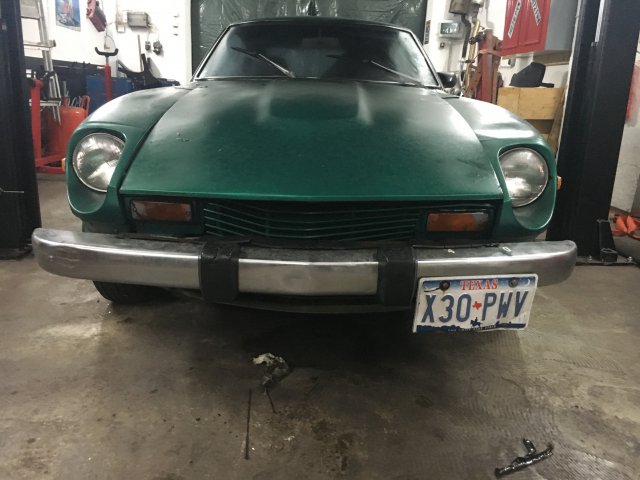

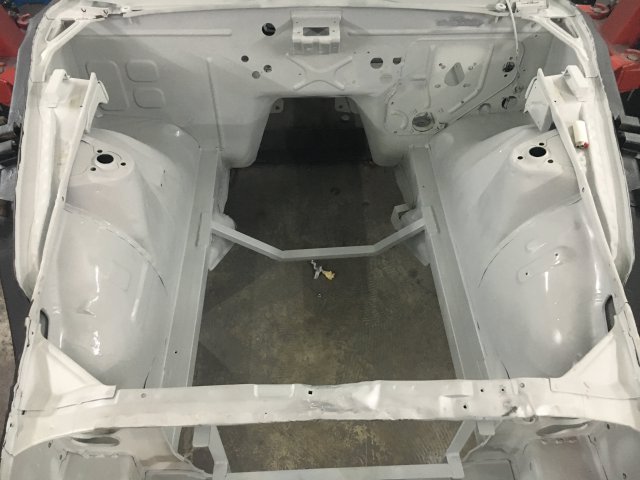

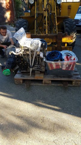

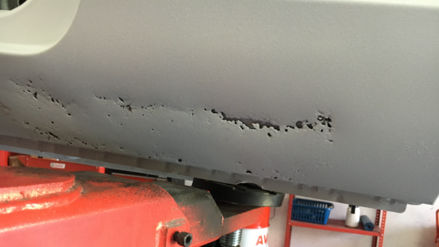

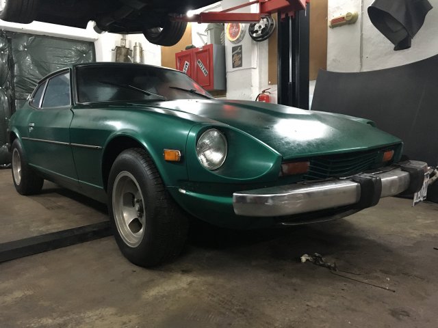

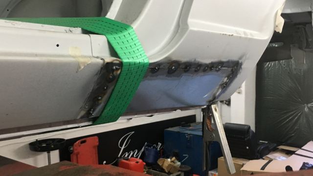

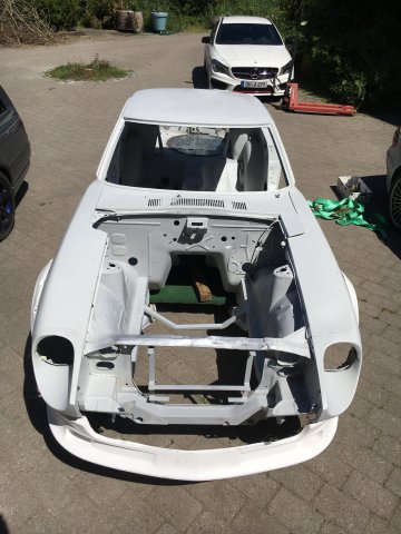

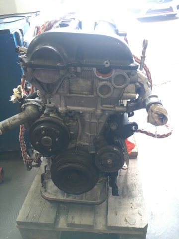

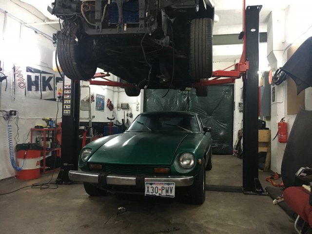

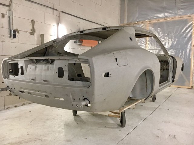

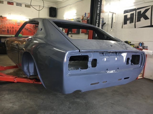

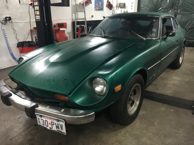

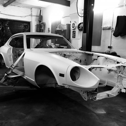

Hi Folks, maybe its interesting for some of you so I like to share the process on my Z with you. Normally I import cars from JP to Germany but my Z is from the lone star state Texas and find its way to Germany this spring. Little curious story: The last TX owner lived 1mi from Gasmonkey Garage and as you all know they had build a Datsun before last Semi. I think mine was in too bad shape so Richard don't bought it for the build, but anyway.. I bought my car at the 19.03 this year from a Moviecardealer in Berlin and get it into m garage a few days later. Because of oo many other project the car sits in my yard for some weeks before I can start. End of April I striped it down and get it blasted and primed. After That I had startet with some welding jobs, but theres nothing to bad so I will finish that next week and the car cango to the paint shop. This is hot it actually looks: Some test fittings. I also cleaned put the whole engine bay and make everything smooth and nice. The interesting part will follow after the car would came back from the painter in Slate Gray. Following Parts are waiting in my garage for the install after the paint or are in transit: SR20DET with Stock S15 top mounted Turbo, complete handmade 3" exhaust, Apexi Power FC and wiring specialities harness Sparco Seats, Black leather interior with grey stitch, Nardi Steering, New Center Console, Speedhut Gauges, AEM AFR All underneath is black or red powder coated with new PU-Bushes BC Racing Coils and 10x17 and 8,5x17 Japan Racing Wheels with Federal RSR Semi Slicks, complete R33 Skyline Brake System with extra Handbrake Caliper Front Aidam, 240Z Style Bumpers and Fender Flares There are a lot more little modifications, will update more interesting thinks after car is at the paintshop and I can start to put the engine together and do some fabrication. Have a nice Sunday. Alex
