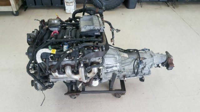

Here’s the old junker. LS1 and 4l60e out of a 99 firebird. 150k on it... allegedly. This is another slippery slope. I decided to not mod it and get it running first. If I actually want more power down the road, that is for future spdrcr to worry about. -
