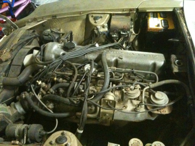

With the pump pulling fuel from a gas can, I was able to get the pressure regulator dialed in. It took about 8 cranks, but she fired up and idled. I couldn't get the engine to rev. So after posting a help thread in the Nissan L6 thread, and feeling a little dumb, I realized that the tube going from the AFM to the throttle body needed to be hooked back up so the AFM can send the rev signal to the ECU. With that done, she ran like a champ for the first time in three years!

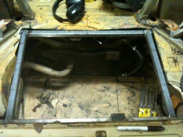

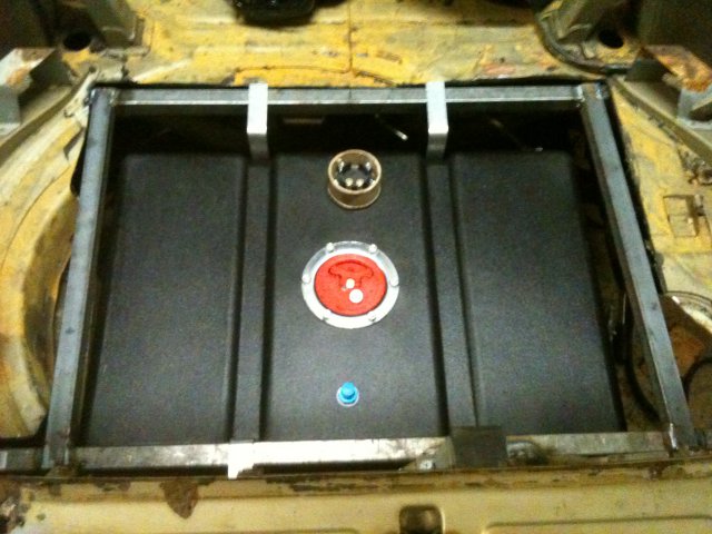

I also got the frame for the fuel cell in and the cell in the hole. After reading all the posts and seeing the pics of everyone else that has installed a fuel cell, I knew i had to make a frame to mount the cell. It adds strength to the rear frame area, since I removed a lot of metal from the hatch area. Now all I need is a 45 deg filler neck and to cover the hole with sheet metal. Don't need any road noise and exhaust in the car.
Instead of buying the fuel cell mounting kit, I made one. I knew my setup would be a little different than the kit. The brackets cost me about $10 and 30 min. Lowe's has 8 foot long pieces of aluminum that are about 1/8 inch thick and perfect for the brackets. I just measured them out and used a bench vise to make the bends. I am sure most of you are saying, yeah that's a no brainier. But for those of you with limited metal working skills, like myself, its not that hard. Just take your time and add a little to your measurements. You can always cut some off, its REALLY hard to add more when dealing with metal.
