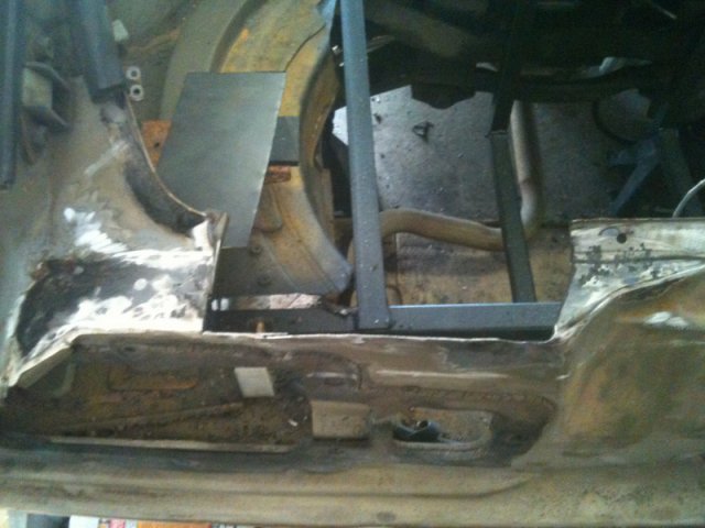

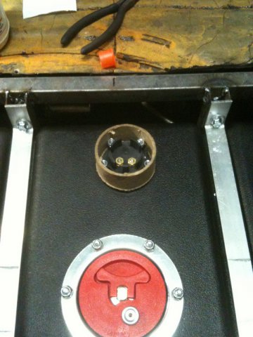

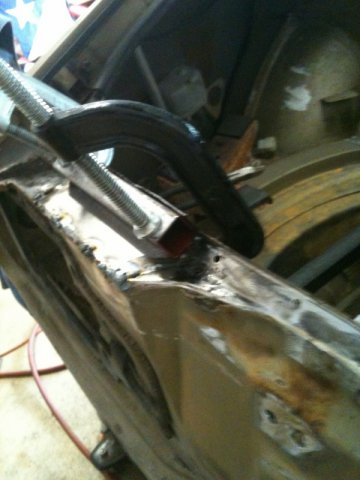

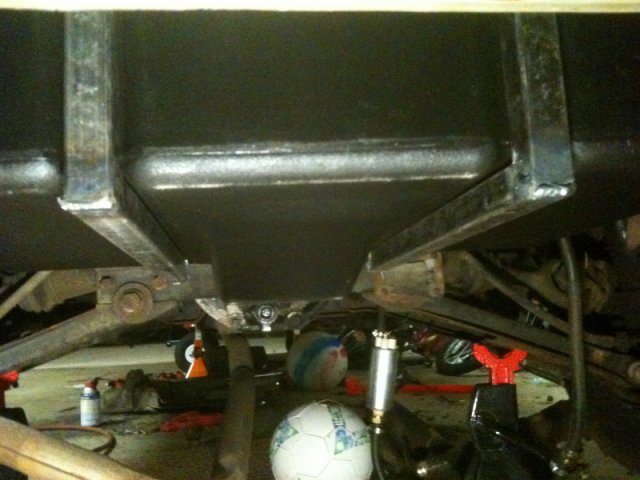

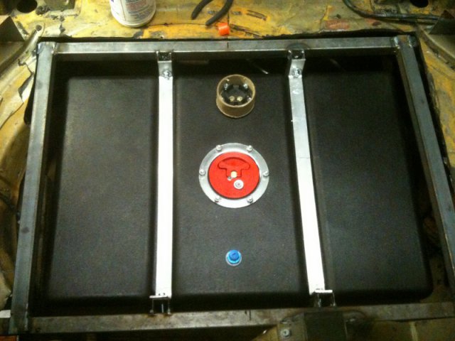

You are correct about the fuel cell being in backwards. It was just set in there mocked up in the pic. I have taken it back out to paint the cage. I did like the clean look of it in backwards though. As for the floor pans. I am going to have to replace most of them. The rust starts at the seat front cross support and goes almost up to the firewall. The trans tunnel it still in good shape though. I am going to cap the rail and then replace the entire floor.
For the filler neck, look 4 posts up. I have explained my plan.

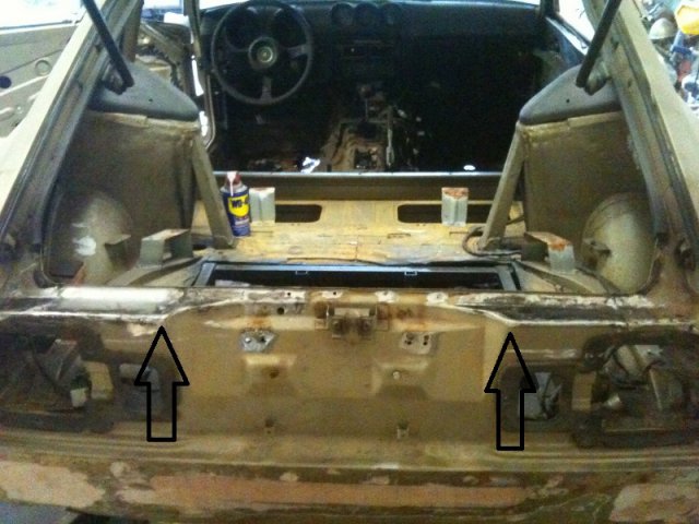

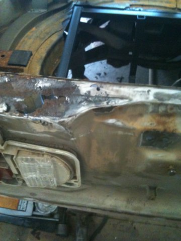

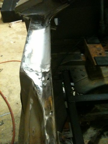

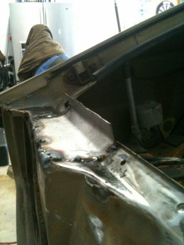

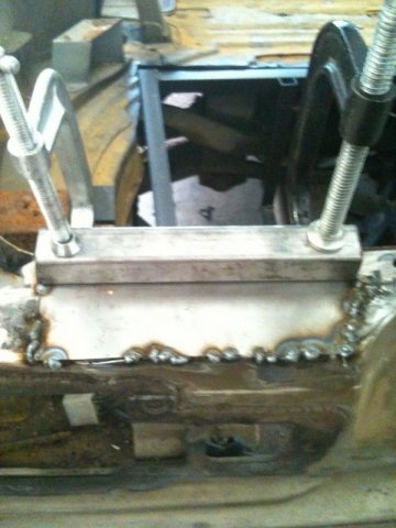

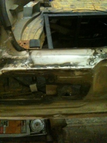

I also worked on the rear hatch deck lid area. I posted a write up about it in the Fab section. http://forums.hybridz.org/index.php/topic/107643-rear-hatch-deck-lid/page__view__findpost__p__1007074__fromsearch__1 Let me know what you guys think and if you have any ideas. This weekends plans are: 1. Pull the radiator and clean it out. 2. Pull off the things attached to the firewall and engine bay. If nothing else, just kinda pull the things away towards the engine, so I can start painting it. 3. Would like to get it all back on the firewall and engine bay walls. My father-in-law (the one I got the car from) is coming up from AL for the 4th and I would REALLY like to be able to fire the engine up for him. So I may have to hold off on the painting thing, at least until he goes back home. I have started to think about doing the floor pans myself. The rear hatch area turned out to be a challenge, but I got through it. It would be really satisfying to be able to do everything on this car in my own garage. It would also give me a chance to work on my metal skills. I am finding out I have a little and they are getting better. Worst case, I can always cut it back out and go another route.
Okay since my last post I got a few more things done. After talking to a guy that I am thinking about have do my floor pans, I changed the fuel cell setup a bit. He has professional race car building experience and is concerned that the aluminum straps I bent to hold the tank will crack under the stress. So to be on the safe side I took his advise, and made a cage out of 1" square stock. I did 45 deg cuts and welded them together, then welded it in the original square frame. I reused some of the aluminum to make the top straps. Ill be taking better pics soon after I take it all apart and paint it.

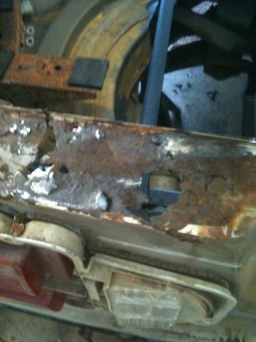

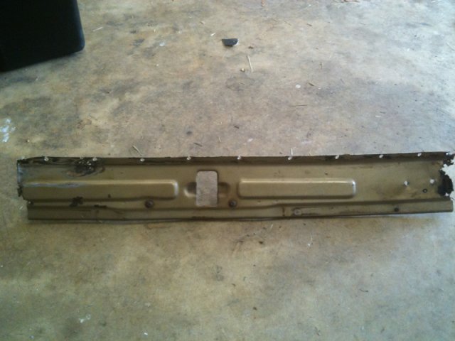

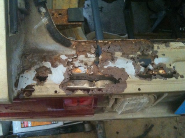

So now I have about 3/4 of the top piece left that is still useable. I am at a cross roads. The way I see it I have three options. 1. Do I buy the replacement top panel from the Z store? 2. Do I use what I have and just add metal to it to extend it to the corners? 3. Do I just cut the top piece so it is even on both sides from the middle and weld it back on. Option three is a little outside the box and I have not seen anyone do it. I could cut it even with the flares for the tail lights That way I still have the stock points for the license plate and lights for it. Then I could just make the rest of the top as flat as I can with body filler without having the lip that protrudes out. Looking for any advise or suggestions.

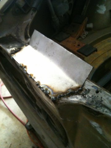

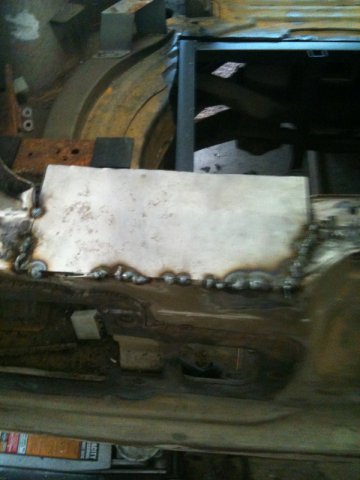

I finally got tired of putting off the rust repair on the rear hatch deck lid area. I had planned on buying the repair panel from the Z store, but wanted to see exactly what the damage was first. Thought this might help those on this site with the limited metal working skills like myself. This is what I started with. I was able to cut the top piece off by drilling through the old spot welds. I found that most of the metal under the top piece was still pretty good. There were a few spots, mostly towards the corners, that really needed attention. So I gridded down until I saw clean metal all across the top and around the edges. Looking at what I had, I realized that even if I bought the repair panel, it would only replace the top. I had to do something about the underside. So I got to it. Here is how I repaired the left side that had rusted through. The rust went all the way from the outer edge to lip that the weather stripping attaches. I started by cutting out the bad metal and tried to keep the cuts in a straight line. Then I made a template out of cardboard and used it to cut the patch piece out of 22GA steal. I got a piece about 2'x2' from Lowes for around $20. Please excuse the welds, I had a hell of a time getting the weld hot enough to penetrate the new steal without burning a hole in the old sheet metal of the body. I welded from the outer edge up to the first bend. That would give me an anchor on either side to bend the first section. Then I took a scrap piece of 1" square stock that I used for my fuel cell cage. I cut it down the same width as the top of the patch panel to give me something to bend the entire piece as straight as I could. Worked surprisingly well. I used two C-clamps to secure the square stock in place and to bend the steal. I did the same for the very top lip section. Welded up to the next bend and used the square stock in the same way. When I cut the patch panel I made it a bit longer than I needed so I would not come up short and would have something to grab and bend. It would have been a pain to try and bend a 1/4" lip. And here is what I was left with before trimming it up, welding the rest, and grinding it down. And now the finished product, sort of.
