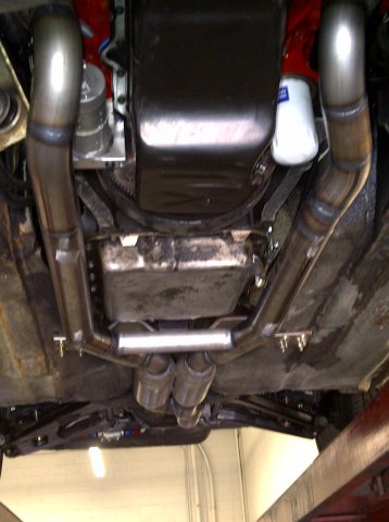

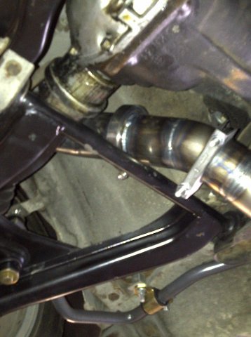

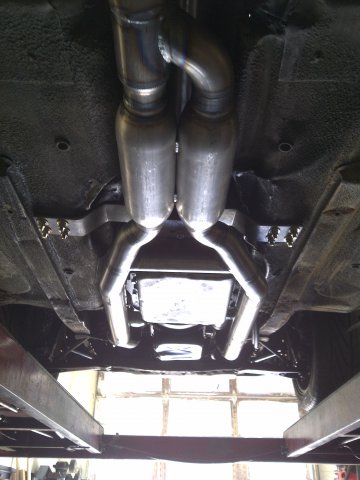

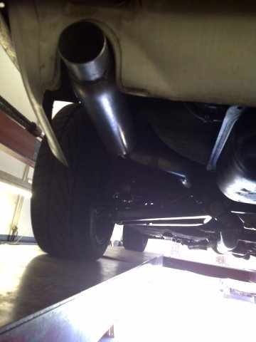

The two in the front are dynomax 2 1/2" bullet mufflers and a 3" bullet muffler in the rear. The work was done by Fabtech (chatsworth, CA.)
I tried to do what everyone else did, but sleeper it is not. After i get the breaks in order im headed back to the welder.
