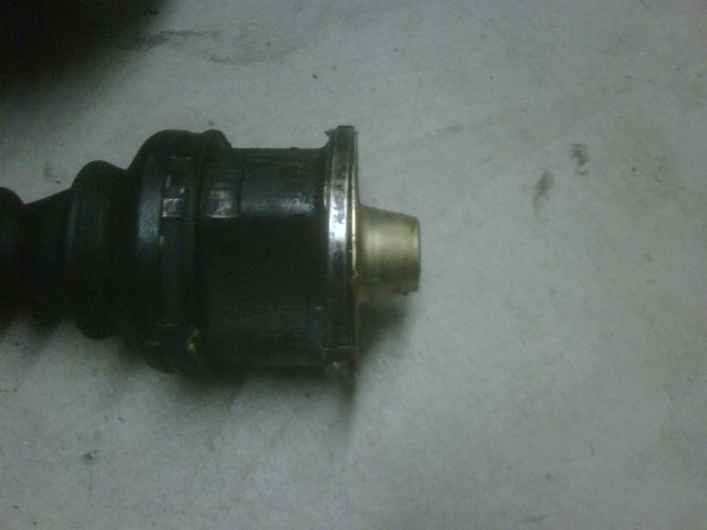

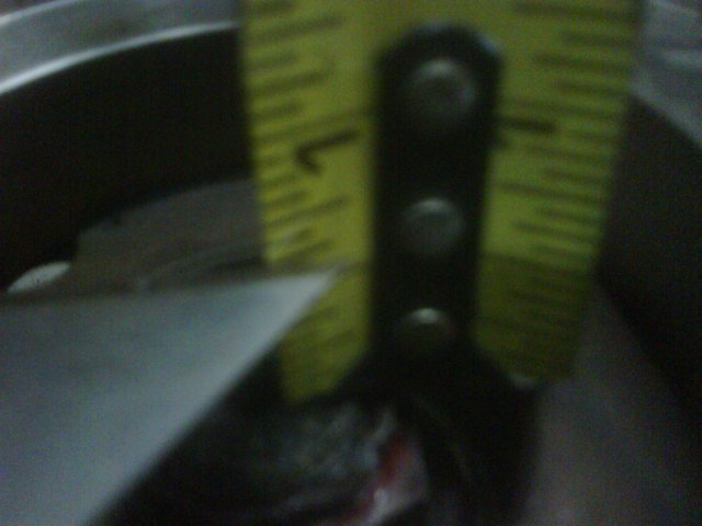

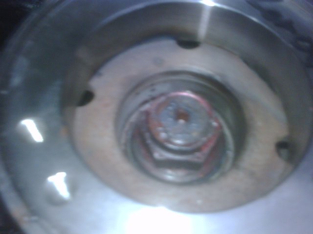

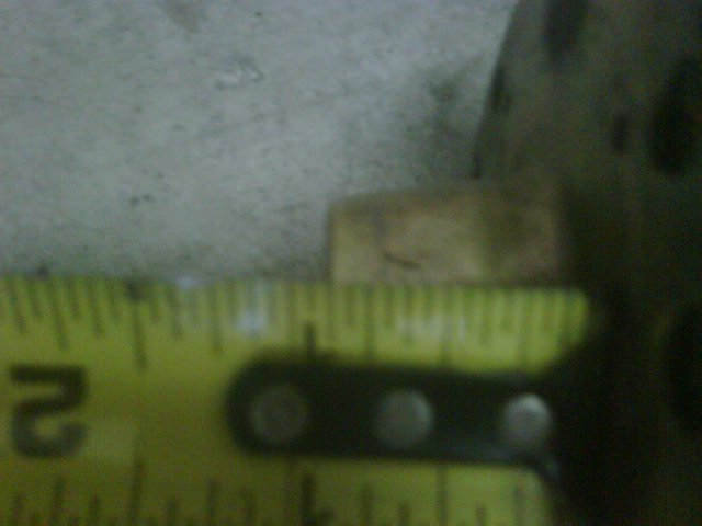

I installed the modified companion flange on the stub axle and now the base cap on the CV axle hits the stub axle/nut when I mate them together.
The depth from the mounting surface of the adapter to the stub axle/nut is 5/8 inch.
The length if the nipple on the base cap of the CV axle is 7/8 inch.
Therefore I cannot seat the CV in the adapter.

I have a 72 240. Im changing to the 280zxt CV shafts.
I got the 240 companion flanges done by Modern Motorsport.
Now the base cap of the CV shaft hits the the stub axle inside the adapter.
Am i missing something
What to do? Please help?
