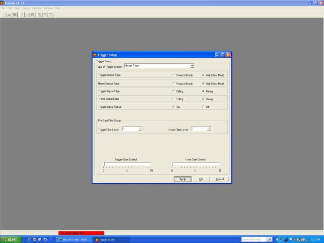

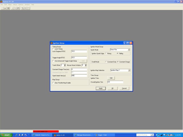

Ok, here are some print screens of my settings: The ECU dignostic error is clear, but I still get no spark.

Ok, I've double and tripple checked the wiring to the ignition system, injectors and home/trigger system. It all seems correct. I have the W to the trigger wire (G/B on distributor), and the W/G to the home (G/Y on distributor). I have 13.8v to the B/W wire on the distributor. turning the distributor will start the fuel pump, but it only registers a fraction of the true RPMs on the ECU. On the injectors, I am getting voltage on one side, but not on the other. Shouldn't I have voltage on both wires? On the ignition wires, I am getting no voltage at all. I have a feeling my ECU is screwed up. It doesn't fire the injectors and it doesn't fire the ignition when I spin the distributor. I do get readings from all of my sensors, and the TPS will calibrate. I would post my screen shots of the setup, but I don't know how. Is there anyway to diagnose the problem here. I got the ECU second hand. I hope somebody can help.
Right now, I only have internet access from work, so I will try to send a print screen of the settings to my work email, then post it here. I haven't tried to use the trigger diag. tool. Where is that located? my ECU is only reading 2 to 3 RPM during cranking, so maybe I have my trigger and home wire hooked up to the wrong wires. I have 4 wires going to the distributor:12v, ground, home and trigger. The harness has 4 wires bundled in to two separate home and trigger wires. I just used the one bundle, with one wire from the other bundle for the home signal. I hope that was okay to do.
Can somebody help me with a direct fire setup of a haltech E11v2? I am not getting any spark. I am using the LS1 4 wire coils, and have it wired as such: D – 12V from ECU (org/blk wire) C - Ignition wire (individual colored wires) B - Ground wire from ECU (blk/wht) A – Ground (blk) I can get spark if I apply voltage to “C†manually, but the ECU is not supplying any voltage to “Câ€. Did I setup something wrong?
