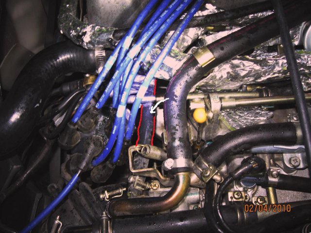

Thermostat Bypass Hose for the 280ZX is a 3/8". -
Thermostat Hose for 280ZX 1982 Leaks
oldschool2 replied to oldschool2's topic in S130 Series - 280ZX
Looks like this is referred to as a Thermostat Bypass Hose. Anyone know "for certain" what the "inner diameter" (ID) is? Thanks -

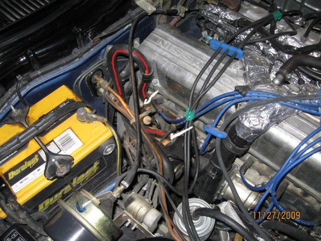

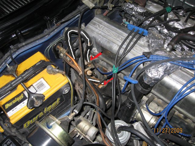

	The water hose is not plugged. The water travels from the engine "heater hose out outlet" to the "heater hose water return inlet" on the engine. The net effect is that the heater is bypassed. The reason for the above is / was to avoid having to dig into the dash area to replace the worn-out heater hose that traveled from the engine "out" to heater assembly (under the dash). If the hose was simply plugged there would be no water (coolant) circulation in the engine. Not a good thing!
	The attached pic shows how I by-passed my broken heater hose set-up. May not be the problem here, but if so the pic shows how. Of course the heater will not work as noted in the pic (heater is basically disconnected).

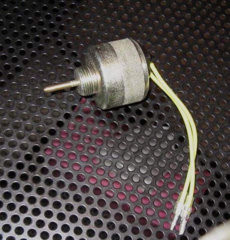

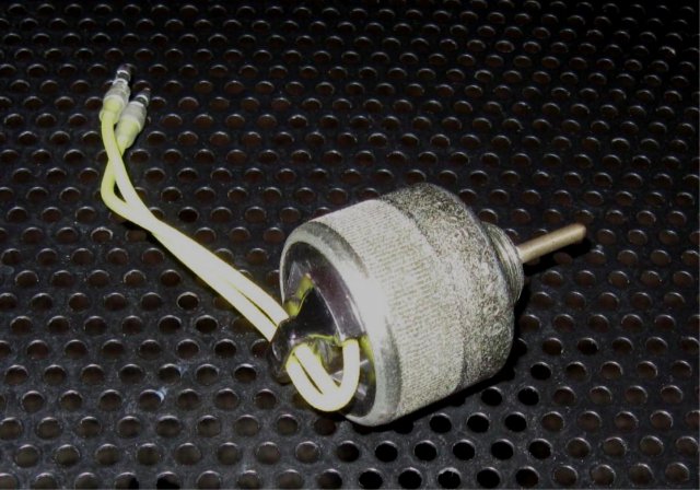

	This is an FYI only posting. These solenoids are getting to be hard to find. Part Number is: 31941-X0103 Mine was seeping trans fluid for years. I finally got a new Nissan part solenoid as pictured.

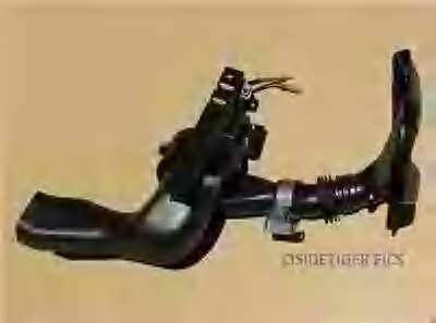

Thanks for the question: Yes I do! Reason; 115 degree days (in the shade). 150+ degree pavement. Black car. Engine bay over 200 degrees. All this equals heat soak. Although it is doubtful that the Aux Fan will help in OEM form, I am interested in modifying the Aux Fan to draw in cool air from the front of the car (maybe). Before I do anything I am trying to understand how the Aux Fan works in stock configuration. Further research indicates that the fan is triggered by a single wire sensor coming from the thermostat housing (near thermo time switch). I see a single wire in the vacinity of the thermostat housing, but am not sure as it does not look green as I have read in some posts. -
	Anyone have actual photos or good diagrams of the correct wiring connections for a Non-Turbo (NA) 280zx FI Auxiliary Cooling Fan? Also, what tells the fan to turn on at 216 degrees? Is the fan motor connected to a temp sensor, or is there a built-in temp sensor within the fan motor mechanism (BiMetal) ? The Haynes Manual is not very helpful. I guess the timer assy is under the interior glove box. Does the "extension duct" that pulls cooler (?) air from below help. I have read that the Turbo ZX cars had the extender duct that attached to the fan intake. My fan motor does not have the extended ducting, therefore the question. Thanks
