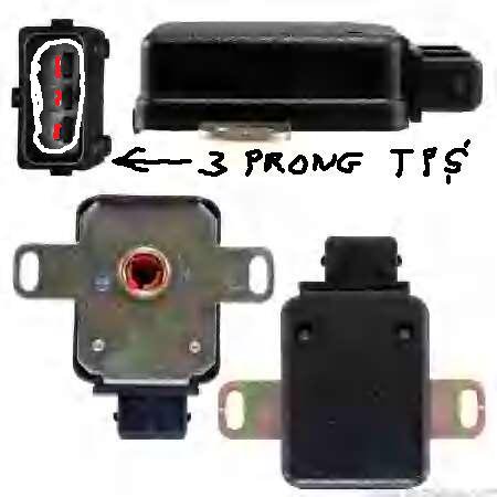

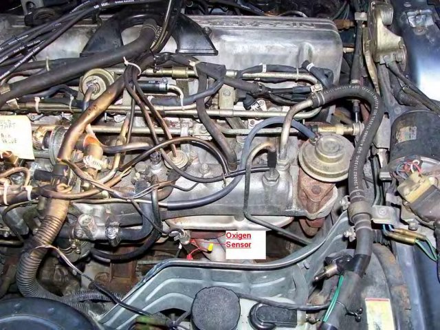

Throttle Position Sensor / Switch Mount Position
oldschool2 replied to oldschool2's topic in S130 Series - 280ZX
Specifically, my TPS had heavy coolant pooling in the "cup" area that the 3 prongs are in (circled in white in attached pic). If I fill the "cup" about halfway with Dielectric grease, then insert the female connector onto the male fitting TPS, will the process be correct? Otherwise, the TPS cupped area (that the 3 prongs are in) will be open to future water invasion. -
Thanks for the input! I have a new TPS on order. Trying to locate a new Connector. When I get the new parts I will look closer at the fitment. Any alternate suggestions for sealing the top of the connector and TPS? I guess at the least I can wrap foil around the TPS/Connector assembly. -
After fixing a "Thermostat Bypass Hose" leak I discovered I had the dreaded 2400 to 2500 RPM rev limiter effect. TPS posts quickly sent me in the correct direction. I discovered significant coolant pooling in the top of the TPS (under the connector). Pooling was removed by using a "Can of Computer Air" to blow-out the green coolant. Now car runs excellent. QUESTION: Has anyone mounted their TPS in an upside down position (flip it 180)? Any known reason to not try this? I am not sure of clearance due to piping under TPS. Otherwise, any functional issues with this ideal?
