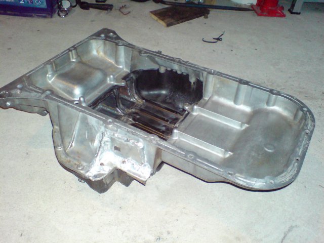

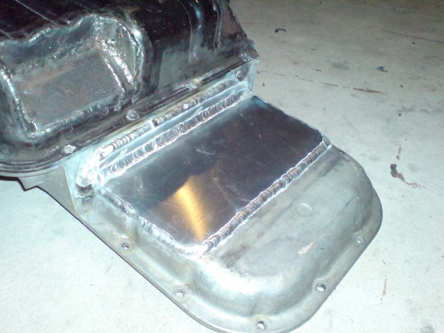

I've had to modify the sump as shown in some of the earlier pics, although the pickup is untouched at the moment and hopefully it can stay that way. I didn't really want to fabricate a sump from scratch as the gearbox bolts to it and has a lot of reinforcing and looks as though it braces the bottom of the block. Yeah I can understans not wanting to outlay the extra cash for the manual.... I was able to sell a whole bunch of 280zx parts off that I had collected for a turbo build for about $1800, then the half cut only cost $1000 so I'm not too badly out of pocket at the moment. The next steps for me are custom headers (have the flanges and bends, collectors etc just need to get it together), then wiring and all fluids like heater, radiator, power steering etc... I think I've got the wiring fairly sorted so hopefully that shouldn't take too long. The most annoying thing is I'm stuck in Perth for the next couple of months and the car is in Sydney, so probably don't expect to be done till about half way through next year....

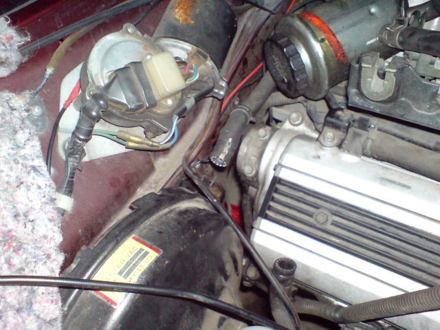

Hey mate, thanks for posting the pic. I looks like mine is mounted much closer to the firewall, from memory I think it is about 90mm from the firewall to the head (where the clutch master needs to go anyway). I've attached a pic which give a little more idea of the clearances. I can probably move it forward a couple of milimetres but anymore than that means a new sump, pickup etc. Although I think I might have found a solution I was looking on the Tilton website and found a master cylinder that is pretty short. I come to 81mm in length which means I need to get a fitting to turn on the end within about 10mm but that seems more doable than having to go underdash pedals.... Sure there was another fellow about the place who did this conversion into a 280zx - wonder how he solved it? I've seen pics of one other guy that installed a 1uz in a 280zx but he was using the auto so didn't have these problems and I'm not sure if he ever finished it. I'm pretty keen to stay with the manual so I'll find a way to make it work! Tilton Master Cylinder.pdf

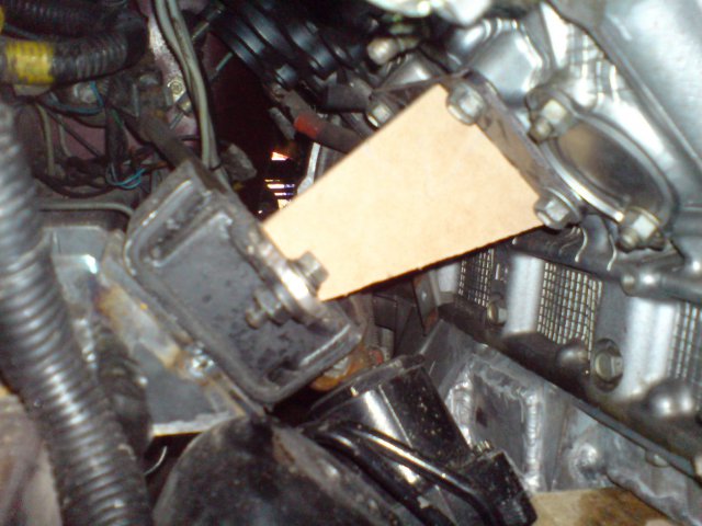

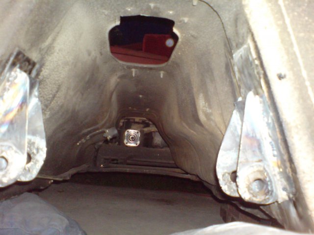

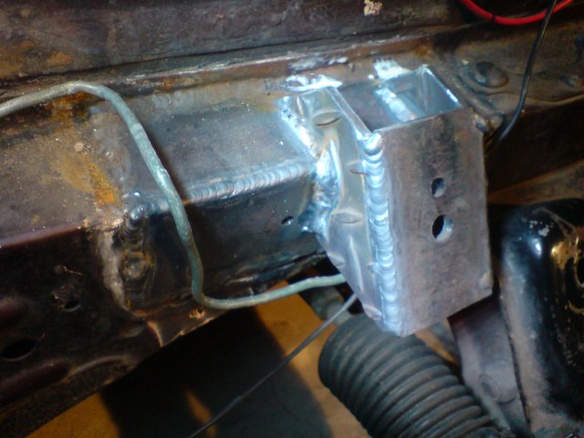

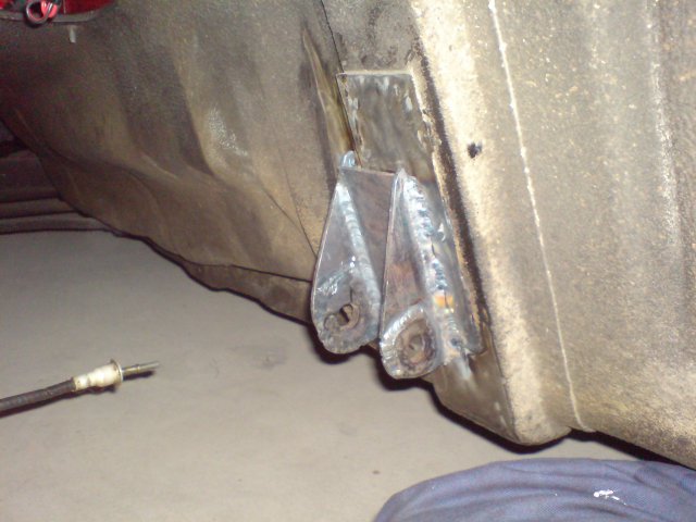

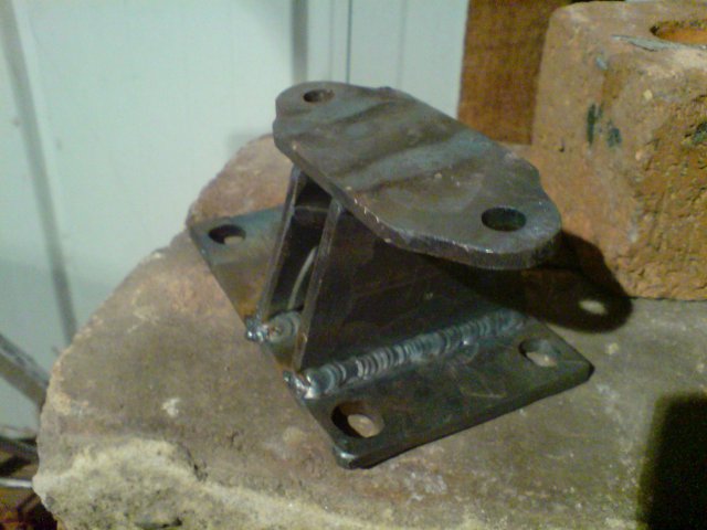

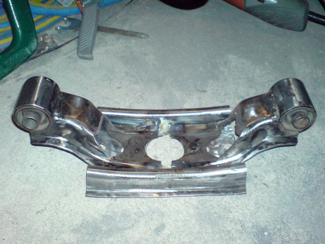

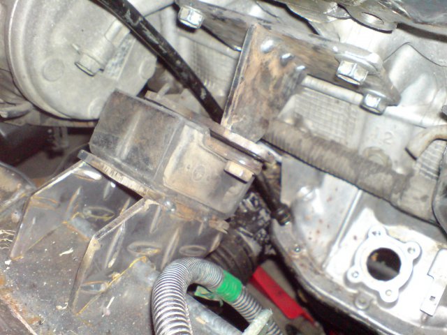

I thought it was about time to give an update on the progress so here goes. I've now got the sump finished off, the engine mounted and most of the gearbox mounts complete. The belhousing is from a company here in Australia called Dellow Automotive, so the W58 box bolts straight up. As you may be able to see from the pics the engine is mounted slightly to the passgenger side (by about 50mm at the front of the engine). This was done to clear the steering box and brake booster although this works out ok as it points the driveline directly at the diff which is mounted slightly off centre too. The main problem I have now is there is not enough room for a clutch master cylinder as it hits on the head/rocker cover... Moving the engine foward anymore will mean I'd have to build a completely new sump and also this gives some drama with the gearbox shifter lining up with the hole. I've already had to cut a little from the front to get it to fit. Although after speaking to another member on here (Tonycharger72) it appears if I get a shifter assembly from an N/A 2jz it extends back much further, so this might solve some of the problems. Unfortunately I won't be able to do any more work on it for a while as I've had to move from Sydney to Perth for a while due to work...

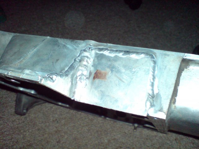

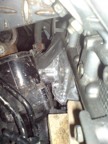

So after removing the clutch master cylinder, the sump had still needed a bit of chopping and welding to get it to sit where I want it. An entire S14 front end does sound nice... and would probably solve some of the fitment issues, although for the moment I'm trying to keep it fairly simple. The changes to the sump have taken a while as there was a lot of cutting/grinding/welding although it is almost there now. Only one more piece to weld on... I've attached a few pics to show where I'm at. Then it will be time to play with the mounts.

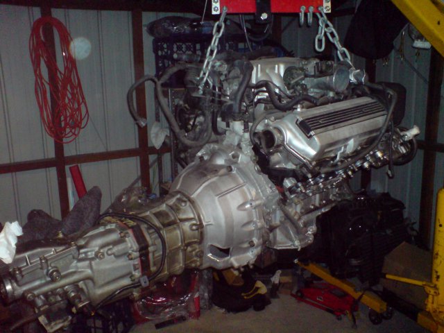

Hey everyone, thought it was about time I shared a little of what I'm doing (and plan to do). I've got an '81 280zx and am in the process of beginning a swap using Toyota's 1UZ engine. For anyone that doesn't know these are a 4.0L V8 that came in the Toyota Soarer (Lexus SC400 in the states) and a few other cars. I've included a couple of pics starting with the engine fresh from coming out of the half cut and a couple of it sitting almost in place. And this is where I'm starting to have problems... If you see the attached pictures the drivers side (here in Australia) head is hitting the clutch master cylinder and the engine cant really go low enough to fit under the master cyliner. I'm already planning to modify the sump although even with the sump pan off and only room for the pickup I still cant get the engine back enough. Obviously the further back and lower the engine the better although the only way I can see this happening with the clutch master cylinder in place at the moment is to dry sump the engine or work out some other way of doing the clutch.... that is unless any of you have some suggestions that I might have over looked. Anyway would love to hear your thoughts.
