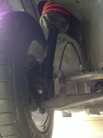

So we looked over the front suspension and everything looked to be installed correctly. Those ate really beefy bilsteins. They must be doing their job there is no bouncing. So looking things over I noticed the engine mounting nuts are missing and the two bolts from the compressor is not on and the starter bolts are loose. Oh man .the guy who installed the engine really did not pay much attention . After tightening things up. The car drives much tighter and there is no longer the "crash bam' feeling and noises that I thought was caused by issues with the front spring and shock setup. I feel much better now -

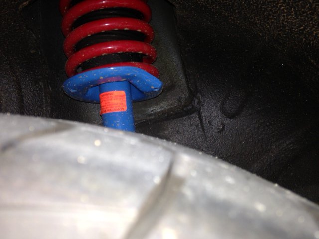

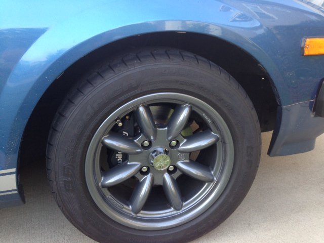

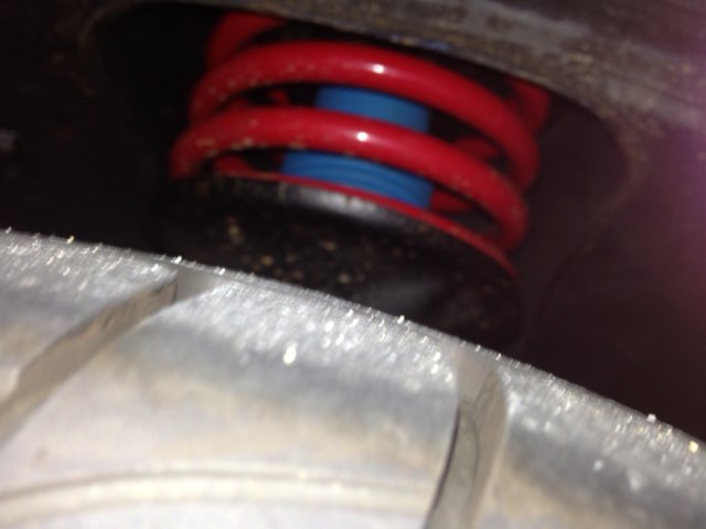

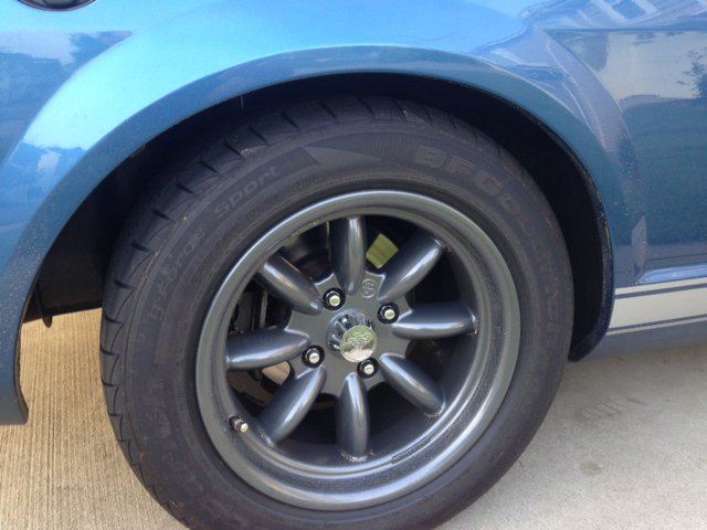

sorry I don't know why all the pictures turned sideways or upside down when I attached them to the post. It is just to give you a visual of how much clearance there is. -

the bilstein rear shock is part # 24-000574 and front insert is part # 34-002643 I took a few pictures this morning -

I am still not certain if lowering springs, and not shortening the strut, will impact the wheel offset requirements? I think it does because I have more negative camber and it looks to me there is less space now between the inside shoulder of the tire and the spring perch. And this is with the lower 205/55 tire on 7 in and 0 offset wheels on the front. So has anyone experience with the Tokico springs on the zx with the 15 in wheels and the 205/60 tire, will it rub or would I need a spacer? the car before the conversion used the stock shocks. Both sets of wheels (the 14 in oem 6 spokes) and the 15 in Compomotives in 0 offset did not have any clearance issues. I went with the bilstein decision for the front inserts becuase that is what many folks in Australia run these cars with, the insert fits well and only require a small spacer, and I was told it is overall a more durable shock that the tokico inserts. Bilstein also still makes a rear shock for the 280zx, as OEM replacement. I got hold if a brand new set and just need to install them. I had to wait a couple months for them while on back order so in the mean time I went with the tokico blue shocks on the rear. I checked the front and have 5 coils in the tokico springs. top and bottom seated and then 3 inbetween. there is about 1/2 in clearance gap between them with the car stationary. John said the fronts are the wider OD, so if I look at the MSA product picture it then looks like the fronts are the ones with 5 coils. The rears are then the longer and narrower coil, so my installation seems to be appropiate. Then the question is just, is 1/2 clearance between coils on the front seems ok? Maybe I just then just need to let the springs settle and see how that goes, and get used to the harder ride. I still think the BFG 205/55 are a hard sidewall tire, so perhaps a softer sidewall for the winter roads will help make it more comfortable -

I had the Tokico performance springs installed on my 280zx. The front seems too stiff and rides bumpy. What do I look for to determine if has has been installed correctly or if there is product issue with the spring itself? The shock inserts are new Bilstein (for a 300zx NA, 1984) with a spacer at the bottom. Strut housing was not modified. OEM bump stops. With the spring at static, how much space should there be between the coils, 1/8-1/4 enough? From product picture on MSA website where I bought the springs it looks as if the front and rear spring diameters are different (rear should be wider and less coils) and it will not be possible that the insaller could have mistakenly installed the F/R in reverse order, or is it possible? I ask becuase many treads comment the springs rates are 175F/200R. I even called MSA rep and that is also what he told me the rates are stiffer on the rear springs. However the guy who installed the springs told he he always put the stiffer spring on the front for cars with a front engine read drive since the stiffer spring in the front helps with dive under braking and control through cornering. With the car in the garage and wheels on I cant see of the coils are narrower and more in the front. Looking at the car it also appears the rear is slightly lower than the front which is another reason it is puzzling me if there is a product issue or if they've been installed correctly. If I press on the front bumper there is very little if any compression, the rear is much easier to compress.
