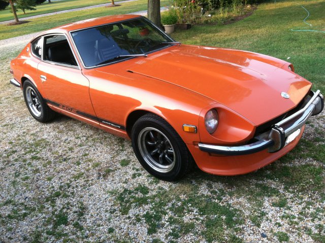

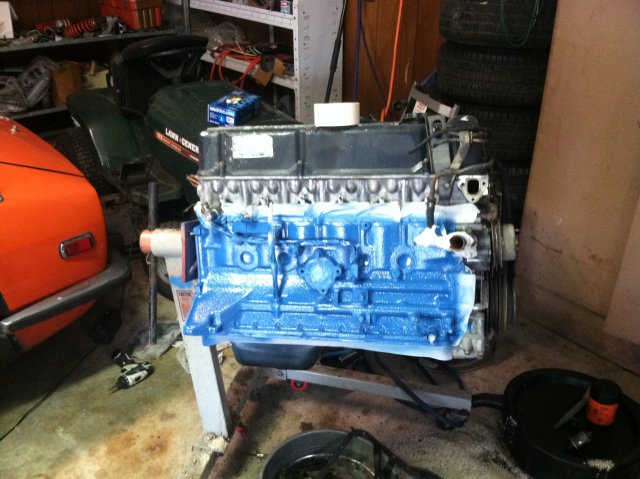

  3. Below is everything i've got. Car its going in, Motor on stand, one side blasted and painted. New oil pan and competition gasket on. I'm about to tear the intake and exhaust manifold off, replace the gasket and paint it. Replace all the gaskets I can, oil pump, water pump, timing set, front and rear main seals and i'll throw it in. We shall see how it goes.

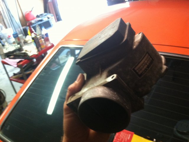

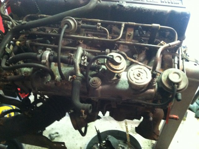

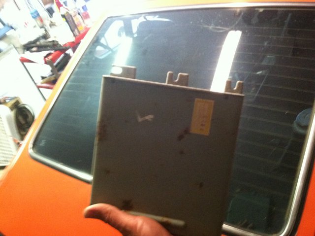

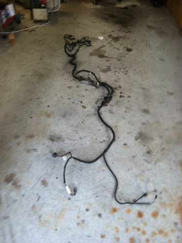

  5. Ok guys, don't blast me, i'm not new to Z cars I own 2 240z's and have been through every aspect of them but I am new to this turbo swap L28ET i'm about to do. I'm in the process of gathering all the inventory for this swap and i'm pretty close to pulling the trigger on installing. What I have is a total engine with all accessories, intake, injectors, distributor. F54 block, P90 head with the big finned intake with egr valve. All vacuum lines etc. Almost like they cut the oil lines and pulled. I have the total engine wiring harness with the injector plugs etc, the main harness. I have the air flow meter, ecu. What I think i'm missing is the coil ignitor, the little transistor but what i'm not sure of is if its on or plugs into the main engine harness or if i need another part of the wiring from the car. Any ideas? I'll post pics tonight of what I have. All i'm trying to find out is if that part of the wiring is separate from the main wiring harness that goes to the ECU. I know I need the ignitor because its not in my box of parts and I see it on the diagrams and see posts about it causing firing issues with people. I'm just trying to find out if I'm on a wild goose chase trying to find another part of the wiring harness. I appreciate everyones help. Mike
