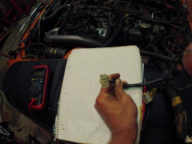

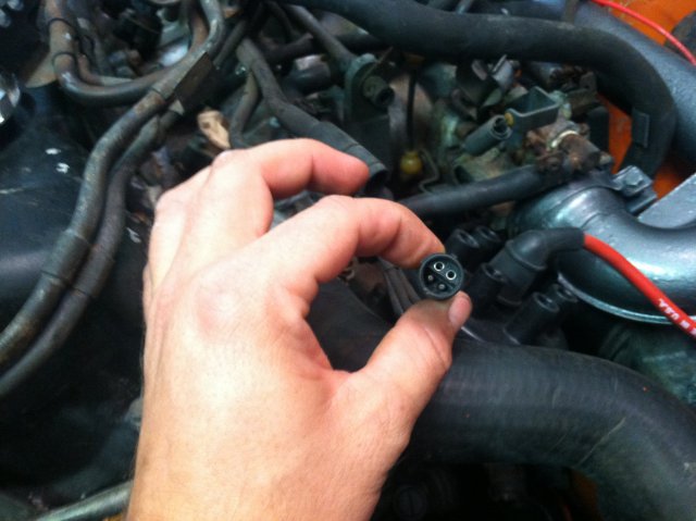

I've scaled these pictures down, they loaded fine at my house and were very clear when viewing. I appreciate any help you guys can offer. Heres what my distributor looks like. Then I have 3 plugs closest to the ecu, one is a T plug very close to the ECU. One is an 8 Pin plug from what i've read is the ignition portion with green/blue, yellow, yellow/white, black, below that row I have yellow, yellow, yellow, black. pic is below I know that i'm supposed to run switched power to the yellow wire in the first row, the yellow with white tracer is my coil trigger, the two ends are ground from what i have read but i'm not sure really, I can't find the links to anything clear as far as diagrams. the bottom part of that plug they said black was ground and the other 3 wires, yl,yl,yl not used? One plug is a smal T plug very close to the ECU, I don't have anything going to it, wire colors are green and not sure blue I think i've read people ground it i've read peope send power to both sides who knows. The other plug has a few blank spots in it but has quite a few leads, one I have traced continuity to another pin as ground on the other what i call "ignitino plug" I havn't tried to do anything with it at the moment. My engine does not have a crank sensor behind the crank pulleys it seems to be the one on the distributor. I have read as much as I can on the post with yadamnfools write up but most all of it refers to an 81, most links are dead and i'm pretty sure what i'm working with is an 82 or 83, I have all the factory molded plugs wired up for the knock sensor, head temp sensor, AFM, distributor, injectors, air regulator on the manifold, and the two plugs for the vacuum solenoids, all grounds are grounded. I'm at the portion where i'm running jumper wires to see if I can get the ECU to light green, and get spark. I have traced wires to find constant hot and ignition hot to jump wherever I need. I have my starter wired up into my old 73 harness, it will crank the motor over, i've previously wired in the alternator upgrade from a zx so it is done with the diode etc and was funtional before the swap. I have not run any power to my coil yet but will when I know the ecu is good and powers up. I'm very understanding if people act like I want to be spoon fed but i've spent 3 days trolling and trying different things very reluctant to send 12volts somewhere it isn't supposed to go. I've printed diagrams, i've read and read. i'll take whatever tounge lashing dished out. I really appreciate anyones help and time pointing to good links or documents for the 82-83 S30 swaps.
what year is this harness, i typed up some questions last night, 20 people look but no one replied so i'm on my own it appears.

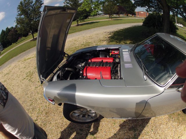

Here's my buddy's car, its a pretty nice V8 swap, arizona z car rear subframe, q45 diff and an LS1.6 speed Pulls nice. All the gauges work, look factory. Recaro seats, nice car I thought it might get someone motivated. It did me, i've got one corner rebuilt on my Z 3 more shocks to go. The fish eye looking pics were took with my GoPro Hero2, it kind of makes pictures look funny.

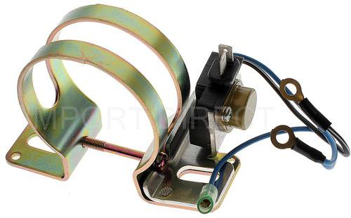

I'm in search of a coil, with bracket, and coil igniotor along with that portion of the wiring harness for an L28ET. I know I could fab something up but i'd much rather just have it plug and play as it is a car i'm getting running to sell. I appreciate any direction you can steer me in as a few companies i'm not naming want an organ donation price for them. Regards, Mike L
