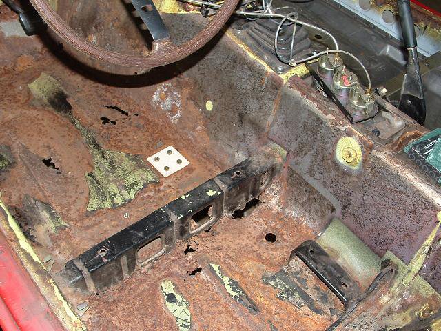

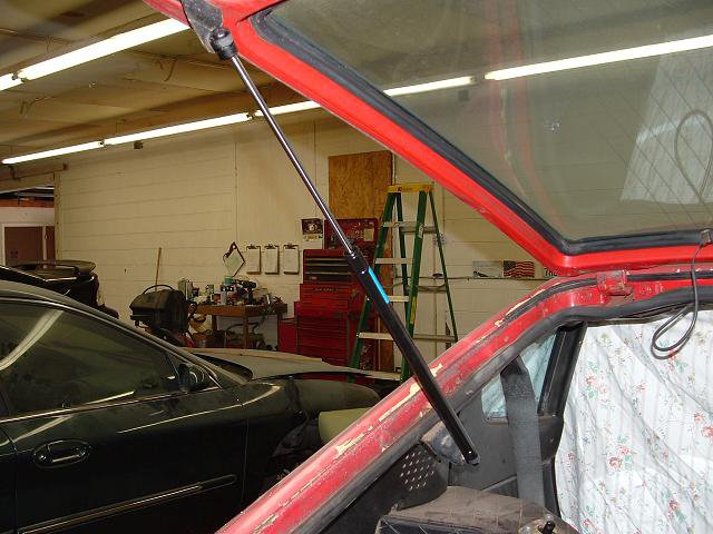

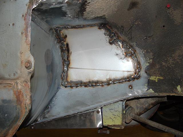

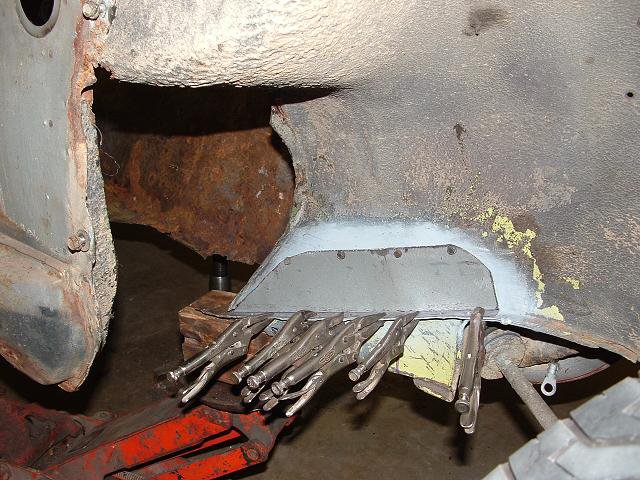

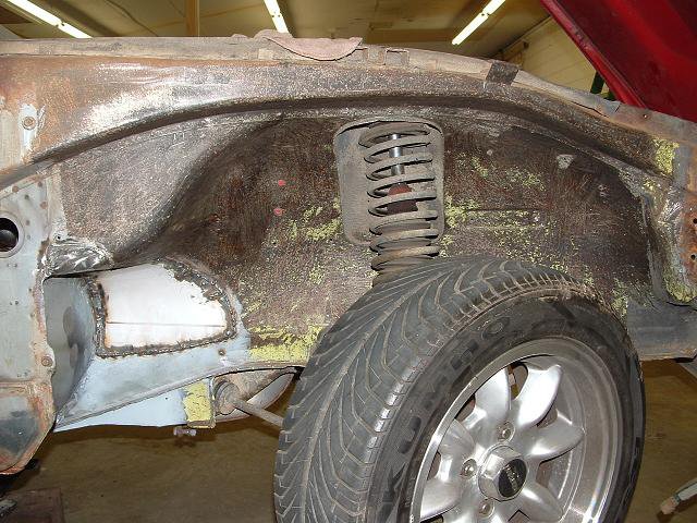

Scraped the undercoating off one wheel well. Holes drilled for new frame rails and seat bracket installed. New $18 hatch strut installed.

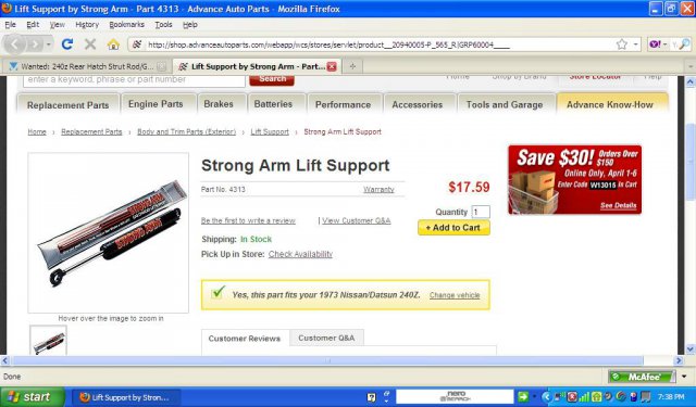

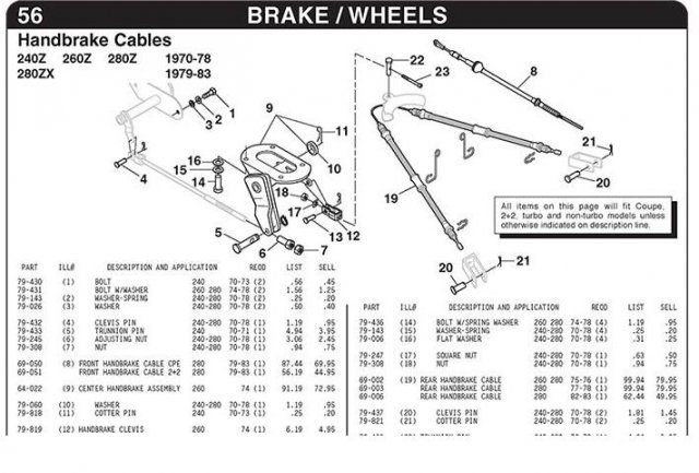

That is a generic picture on there web site. The strut looks just like the one in my car. The only difference is one of the sockets is at a slight angle,it doesn't affect its operation and you don't notice it. I will take a picture tomorrow when I work on the floors.
240Zs have a single strut. 260s and 280s have 2 struts. You can get new ones from Advance for $18.00
Try Advance Auto http://shop.advanceautoparts.com/webapp/wcs/stores/servlet/product__20940005-P_565_R|GRP60004____

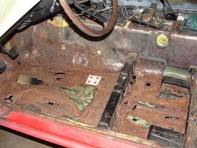

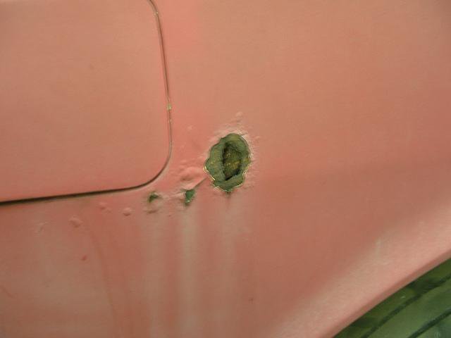

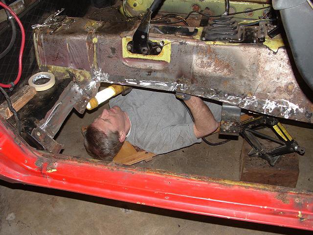

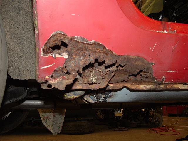

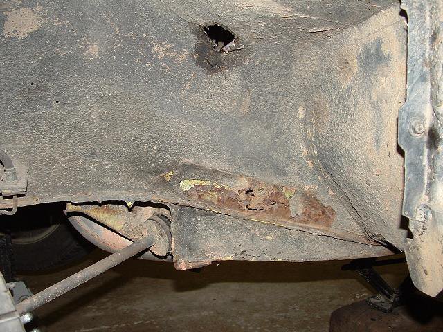

WOW 82BlackNAGoldzx that looks even worse than mine. I haven't worked on the Z in a while but I may work on it tomorrow. If I do I will post some more pix. ModernS30 My friend Kieth did most of the work I just cut parts off and cleaned things.

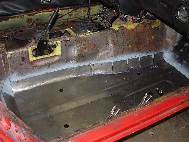

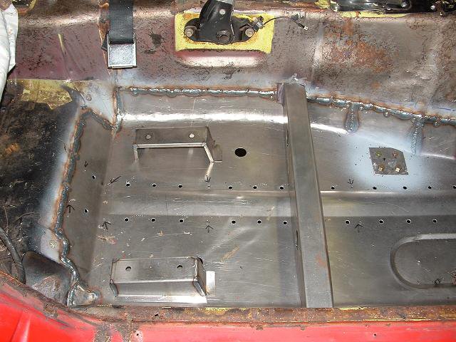

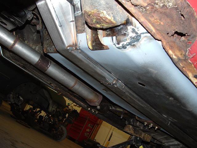

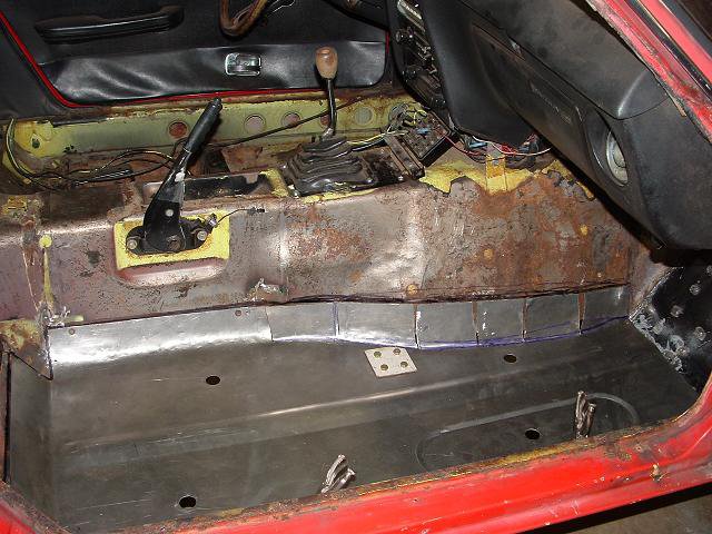

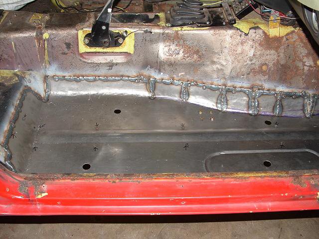

The floors are from Zedd Findings http://www.datsunzparts.ca/NewParts/summary.htm the frame rails are from Bad Dog http://www.baddogparts.com/ the rest of the patches are cut from old car hoods.
Yea but your just a kid.

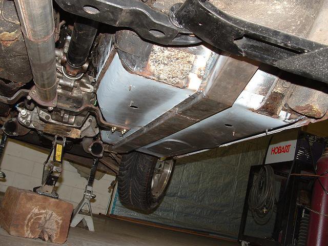

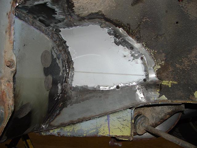

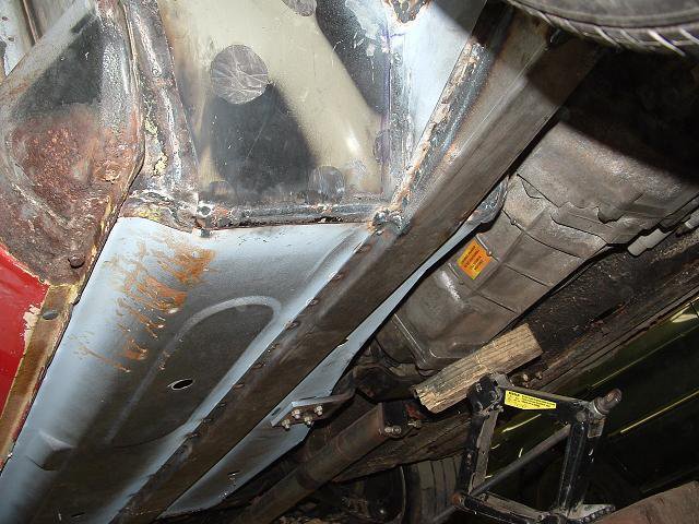

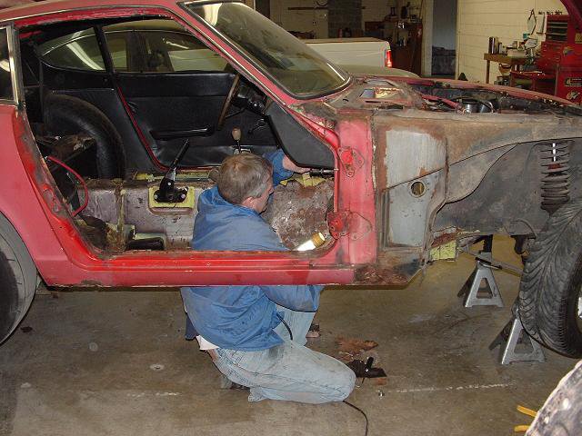

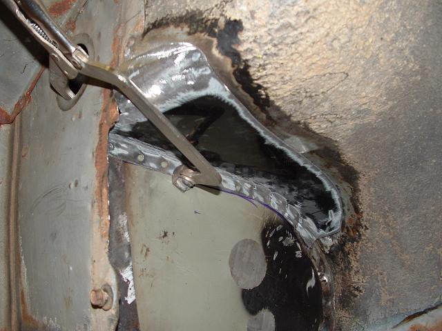

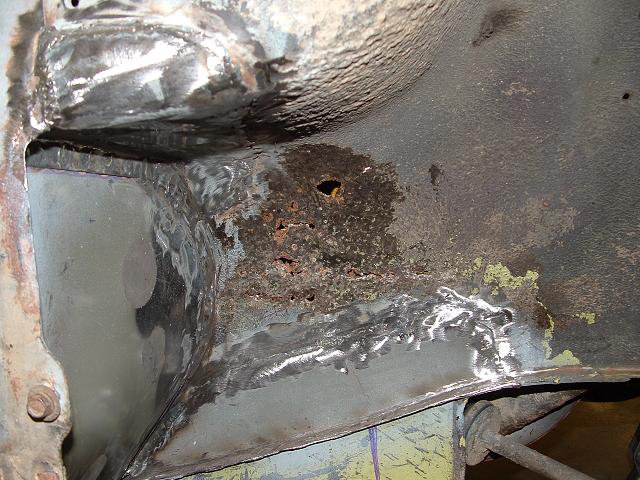

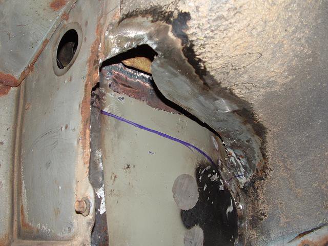

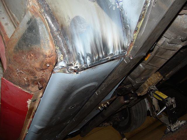

Found some more rust. Another patch. Welded in. We had to reshape the floor to fit the transmission tunnel with the T56. Kieth the bodyman doing the work.

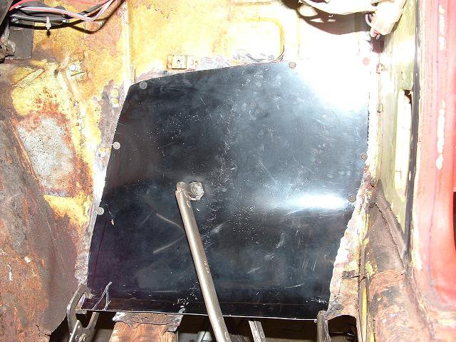

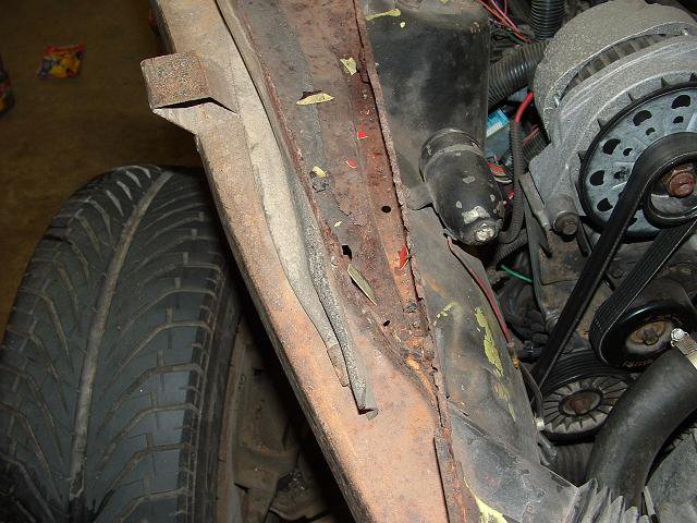

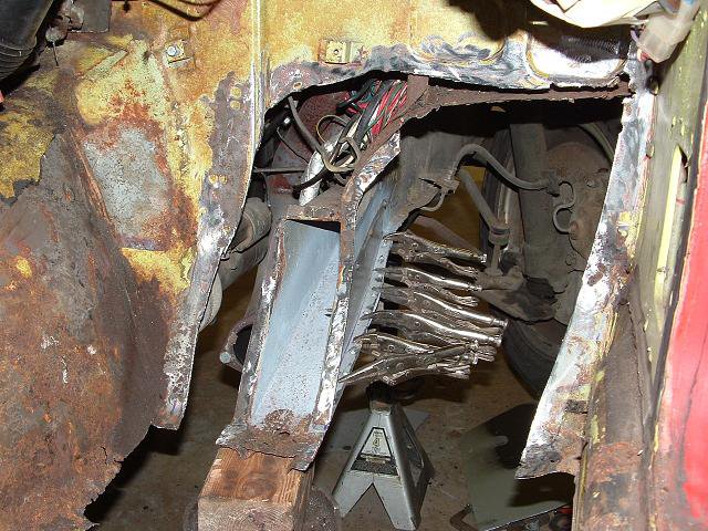

Working on the car. Firewall gone. Firewall fixed. Battery cut out. Battery fixed. Frame fixed. Floor cut out.
