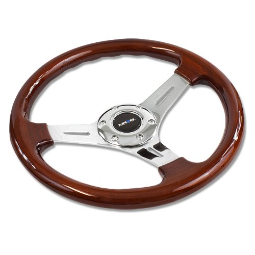

jimmyjones000 Posted December 11, 2012 Author Share Posted December 11, 2012 Gotta thank Gabriel & Gia over at Technotoytuning.com. I pick up some of there pre-assembled coilover's with 200 pound springs in the front and decided to stick with the stock top hats for now though, as I really don't want to cut into the frame. Seem like there would be a few options out there for billet top hats that don't require you to cut into the wheel wells thought. I thinking about getting a few of them machined, has anybody had any luck with this? Hopefully its gonna look like this after its done with a little bit of fender rolling ( photoshop ). Also, busted out the rattle can primer, its more of a "ratsun" now i guess hahah The last item on the list i picked up was a NRG steering wheel and the thin profile quick release. This is gonna be good ..... Quote Link to comment Share on other sites More sharing options...

jimmyjones000 Posted December 27, 2012 Author Share Posted December 27, 2012 A quick update: Installed my Christmas presents from the wife, a Momo adapter and a NRG 330mm steering wheel. I also have a NRG 2.5 quick release coming in a few days. The new wheel makes a huge difference from the old one, and the depth is pretty similar, but I'm not sure how its gonna feel with the added length of the the quick release. Quote Link to comment Share on other sites More sharing options...
