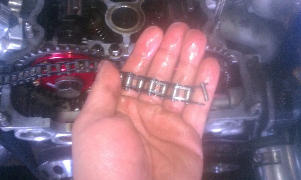

itzgoten Posted August 8, 2011 Share Posted August 8, 2011 Great to see you found your problem. Sucks that it's the frggin chain. Did you break or bend any other components? Quote Link to comment Share on other sites More sharing options...
mr jdm Posted August 9, 2011 Author Share Posted August 9, 2011 I was busy parting out a miata today, all I did was do a compression test and when I got zero on two cylinders I knew it was the chain and just popped the valve cover. I will take the head off probably on wednesday some time and see what I got going on. I am really hoping there isn't major damage. The chain slipped off at only 2,500 rpm. Quote Link to comment Share on other sites More sharing options...
itzgoten Posted August 10, 2011 Share Posted August 10, 2011 Well I'm hoping it'll just be a few bent valves? Also praying that the pistons didn't get damaged.. On a different note.. I own a Miata too! I guess people who like certain cars will have similar taste. I've had a s13, Miata and the Z. Quote Link to comment Share on other sites More sharing options...

mr jdm Posted August 10, 2011 Author Share Posted August 10, 2011 Got the head off just now. No damage to pistons or any of the valves. Hopefully I can have it together tonight with new chain, tensioner, and guides. Time to find another boost controller and hit the dyno again. Quote Link to comment Share on other sites More sharing options...
