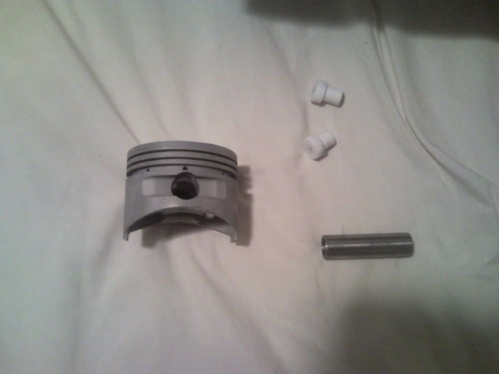

Jordon Posted July 31, 2011 Author Share Posted July 31, 2011 No I do actually mean 3.7 Litre, it sounds outrageous but thats the displacement I will get. The crankshaft has been welded using the submerged arc technique, it is stroked out to +.500" (12.7mm) and the pistons are +.250" (6.35mm)oversized. It equates to 3686 cc. The pistons have a lower pin height and the block will be sleved to accomadate the increased stroke and bore. I don't know if I'm the first to do it but The most I have seen before is 3.2 Litre. I have pictures on my phone of the crank and pistons so when I get that working i will put them up. I didnt know I could use a Z32 tranny. How much more over 500 ft/lbs would it be able to handle? Quote Link to comment Share on other sites More sharing options...

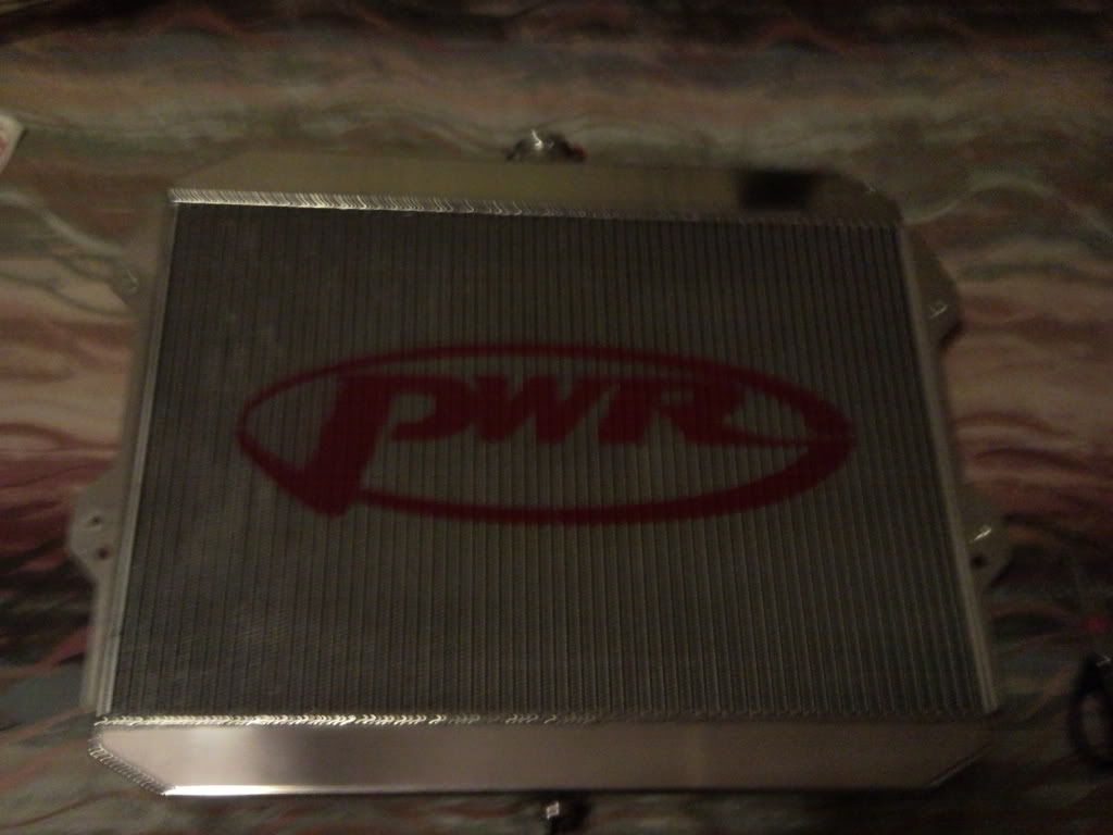

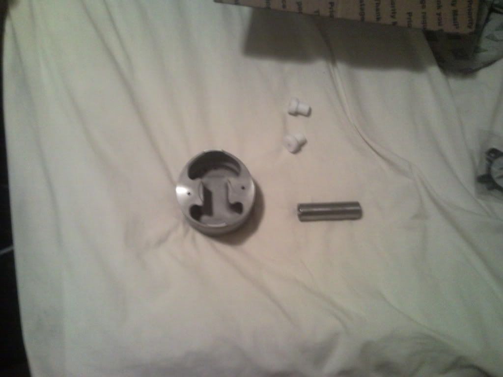

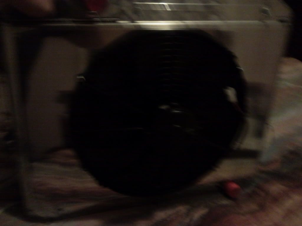

Jordon Posted July 31, 2011 Author Share Posted July 31, 2011 Ok so I got my phone to work for a bit but only got a few photos off. Anyway first theres a few photos of my piston. There ceramic coated with teflon buttons. I couldn't find the crankshaft pictures but they will come later. This is the radiator from PWR, And this is the fan and fan shrowd on the Radiator. I bought a set of wheels a while ago before I was going to do any work to the car. They are 16x8 With a 0 offset. The problem with them is there only 16 inches and the brakes from arizona Z car need 17 inch wheels, I did talk to Dave and he said he could do a 12.2 inch rotor that will fit with a 16 inch wheel. So I will probably go with that unless anyone can give me some feedback on how much braking power the car would need and if the 12.2 rotors would be big enough. There will be more to come. Quote Link to comment Share on other sites More sharing options...

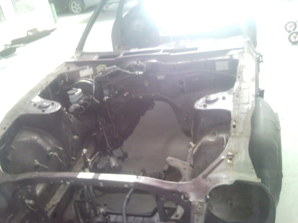

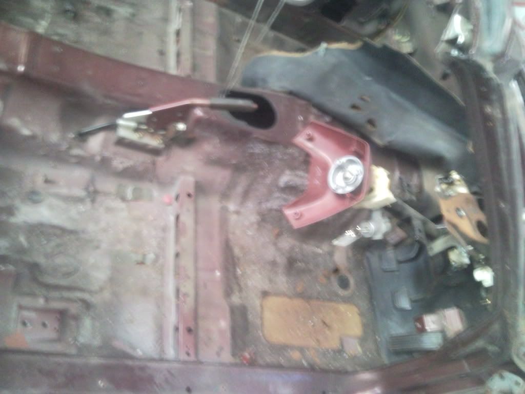

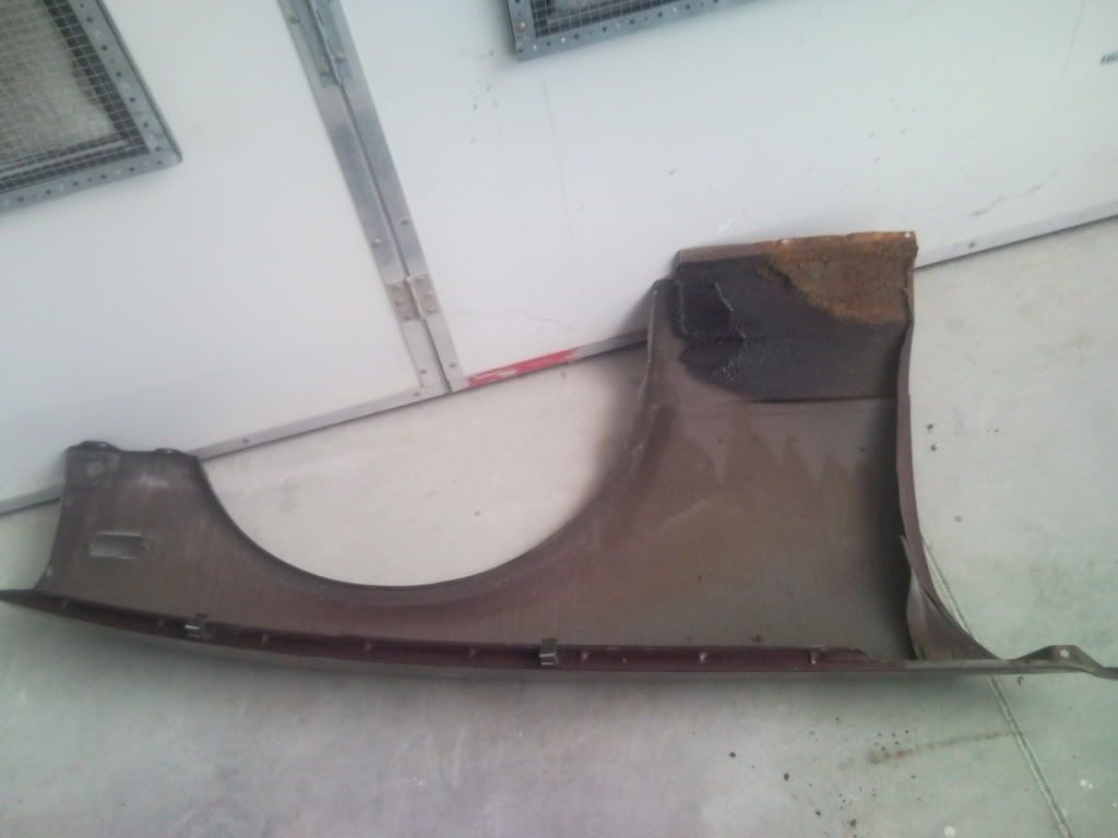

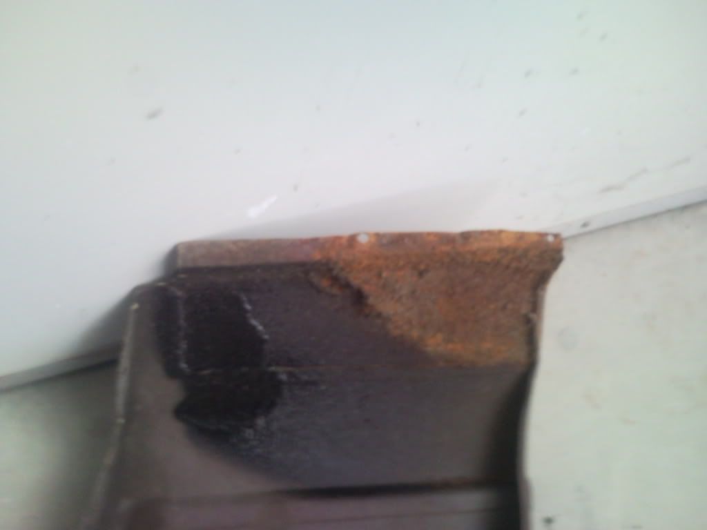

Jordon Posted August 6, 2011 Author Share Posted August 6, 2011 Ok so I'm back for an update. Here are some pictures of the car after I had stripped it and taken it to the panelbeaters/spraypainters. I dropped the car off on thursday to the painters and he started to prep it, remove the last of the trim that I couldn't remove/didn't want to remove/didn't know how to remove, then droped the doors in today (Holy crap they weight alot, gonna get them on the scales when I get them back.) So as I said I got the rust fixed about a year ago, well it turns out that I didnt get it fixed very well at all, it was a bog job and I was told that he would be cutting out the affected areas and welding in metal to fix it, well now the spraypainter is fixing the rust as well as some hail damage in the bonnet and Right front fender panel. Here are some pictures of where the rust was. and what the spray painter has done so far. (This is my Driver side panel, from the outer faceing edge you can see it looks ok (apart from the primer)) (Here is the underside of the Drive side front fender. He has left some of the rust and just poprivited a bit of metal in) (As you can see the rust wasn't even cut out of this side) (Here's a close up) (some rust under the fender on the drivers side) (Also some on the passenger side but you can't really see it, but you can see the rust around the windsreen frame) (Best picture I have of the engine bay) (Finally under the fuel filler there was rust and that was just bogged as well) So as you can see there is a bit of rust, and some more small bits that I don't have photos of. I am pretty annoyed at the guy the did the rust, but I am also annoyed at myself that I didnt give the car a good look over (especially the fenders) after I got the car back from him. I guess I learned a lesson in that one. Anyway, the spraypainter said that he would be taking photos of it as it has done, so hopefully I'll be able to get those, If not my next photos' will be when its finished its paint job. In the meantime I have started ordering various parts for the car, suspension, brakes, brake lines etc so I will get photos of them when I get them. Hopefully I'll have some more updates and news about the car in a week or so. Thanks for reading guys. Quote Link to comment Share on other sites More sharing options...

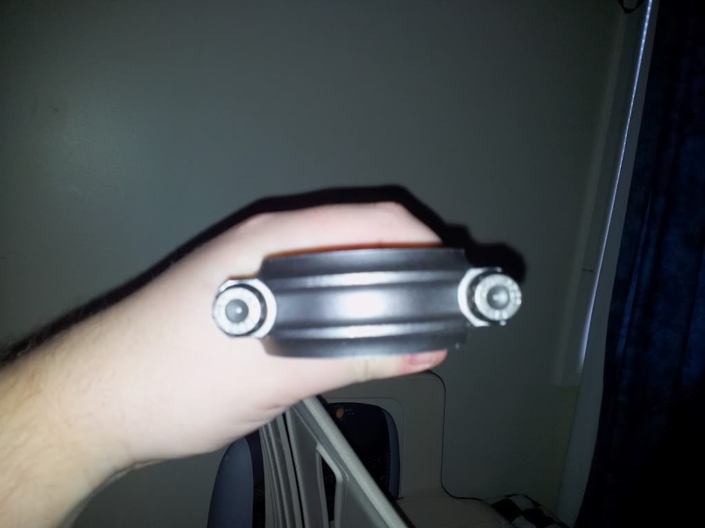

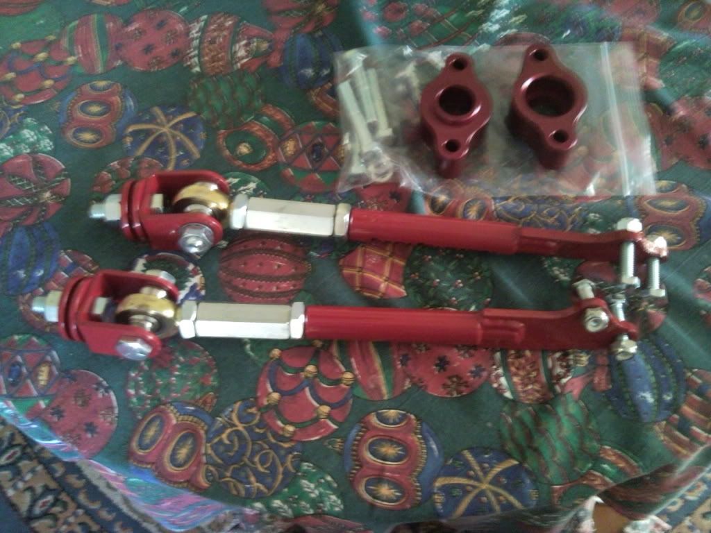

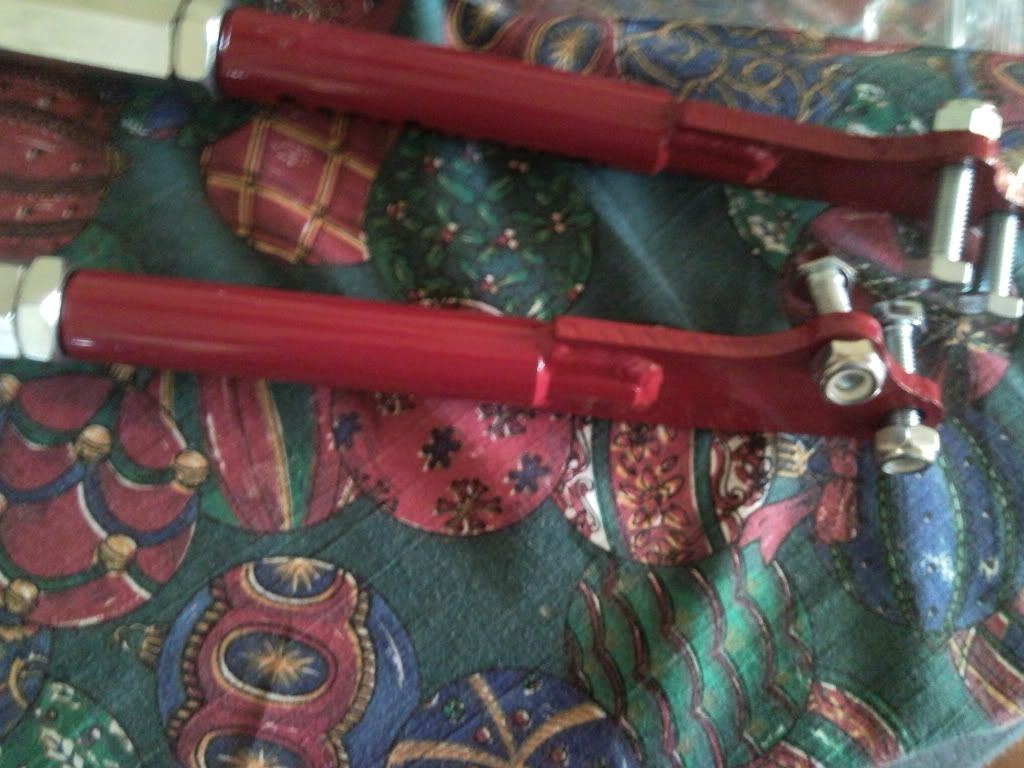

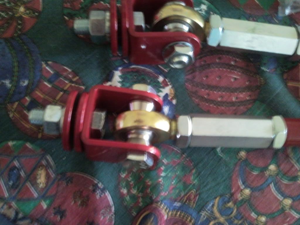

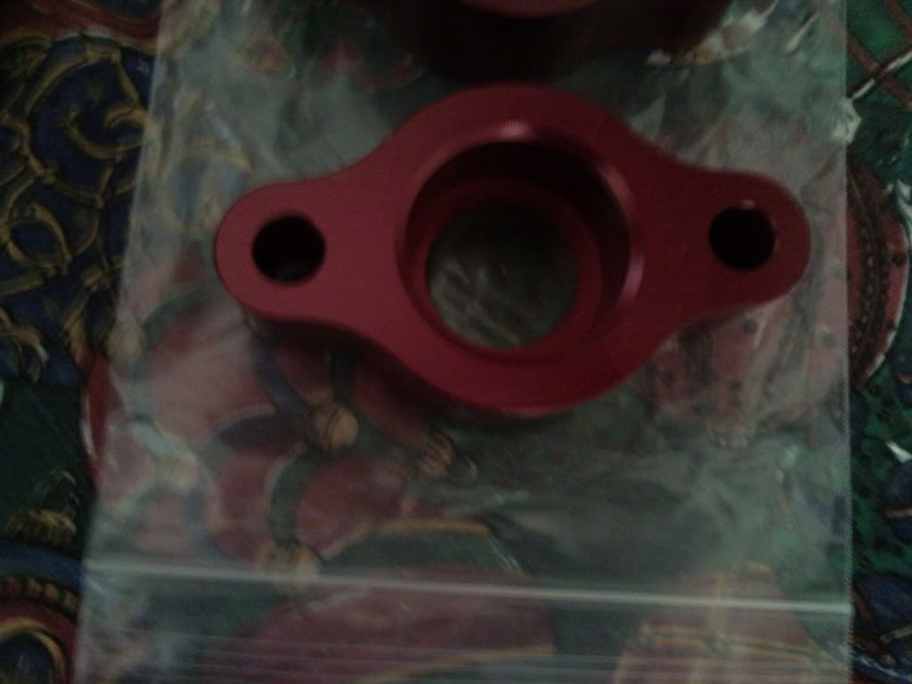

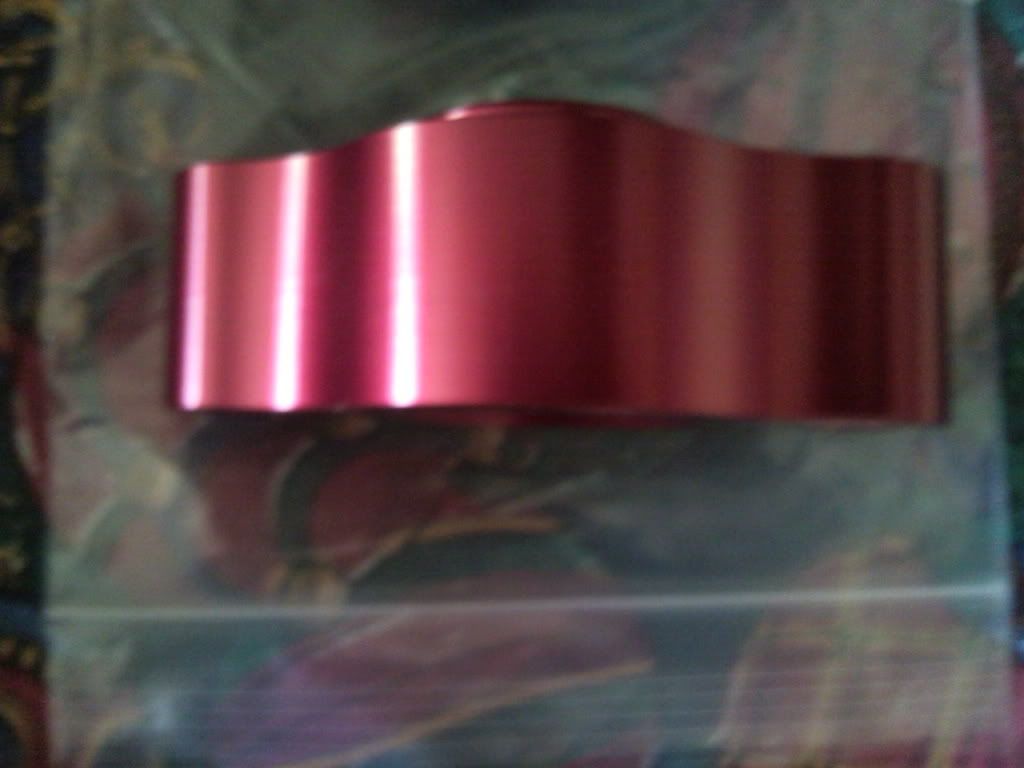

Jordon Posted August 25, 2011 Author Share Posted August 25, 2011 (edited) Hi all, Back for a short update. I have recently been ordering some parts for the car and some are still waiting on arrival but thus far I have recieved my RCA's for the front, The Tension control rods (both rca's and Tension control rods from techno toy tuning). I have also got the tires I was talking about in my last post. I got one of the rear tires and one of the front ones on a wheel each, and from what my panelbeater/spraypainter tells me the rear is fine, it just sticks out a bit from the guards and he is yet to sort out the front. He will be flaring my guards for me instead of bolting some on to make it keep a kind of stock look. I have been a bit sick lately and havent been to see the car but will hopefully be going to see it soon. I am also going to be talking to an engineer about side venting exhaust tomorrow or early next week to find out wether it is legel or not to have that on the car, if it is I will be seriously thinking about it. Some pictures follow and there will be more to come over the next few weeks. A few pictures of the RCA's and, some of the Tension control rods Thanks all for reading. Edited August 25, 2011 by Jordon Quote Link to comment Share on other sites More sharing options...

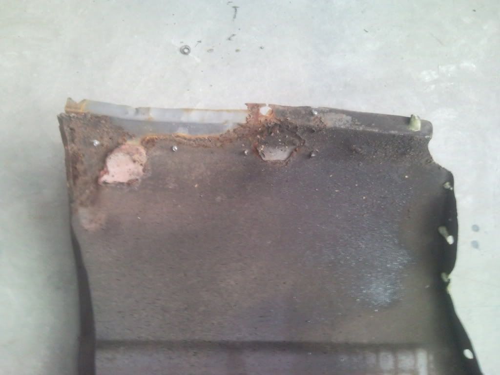

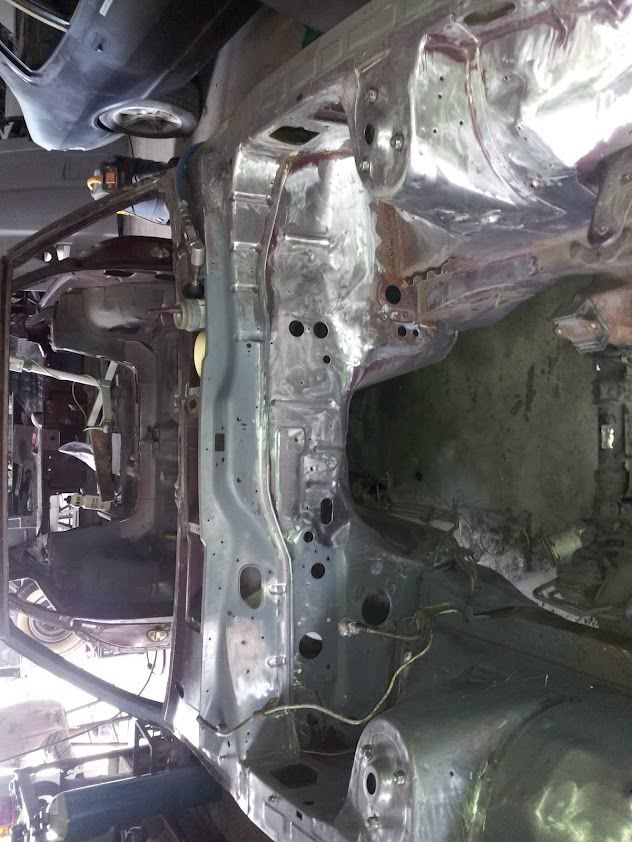

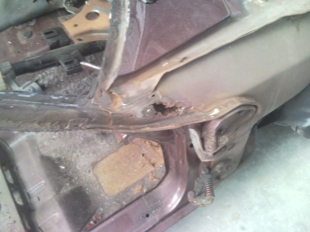

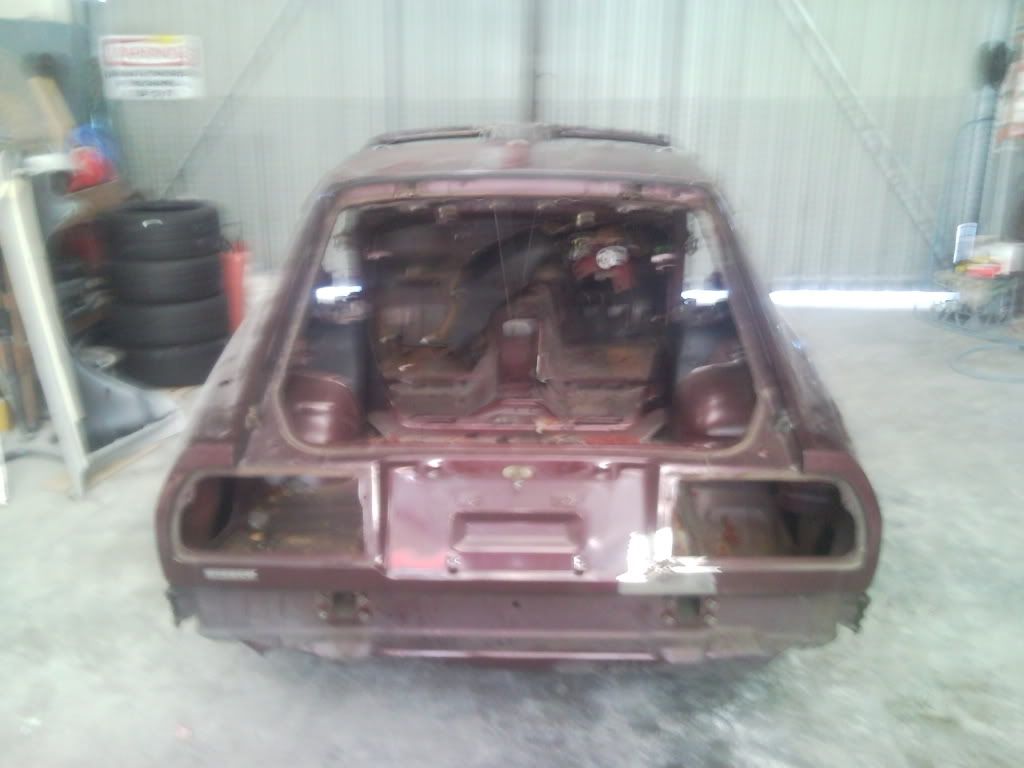

Jordon Posted March 12, 2012 Author Share Posted March 12, 2012 So Hello All Who May be reading. It Has been Over half a year since my last post, Really Not much Has been happening. It is a long and slow process So Far. As A quick Update, the rust has been completely removed, and the body has slowly been prepped for a bare metal respray. I have done some of the work myself, and then my panelbeater has done the Rest. I will have some Pictures Up in the near future When I am able to go and see the car next. I recently Go my new connecting rods as well so I will post some photos of them at the same time. I have recently got a new job so progress on my end has slowed down to a crawl but I aim to have the car in my garage ready to start re-assemby anytime from july. I will hopefully be back in a week or so to post some progress pictures of the car as well as some pictures of parts I have acquired and some plans that have had to be changed in the last 6 Months. Quote Link to comment Share on other sites More sharing options...

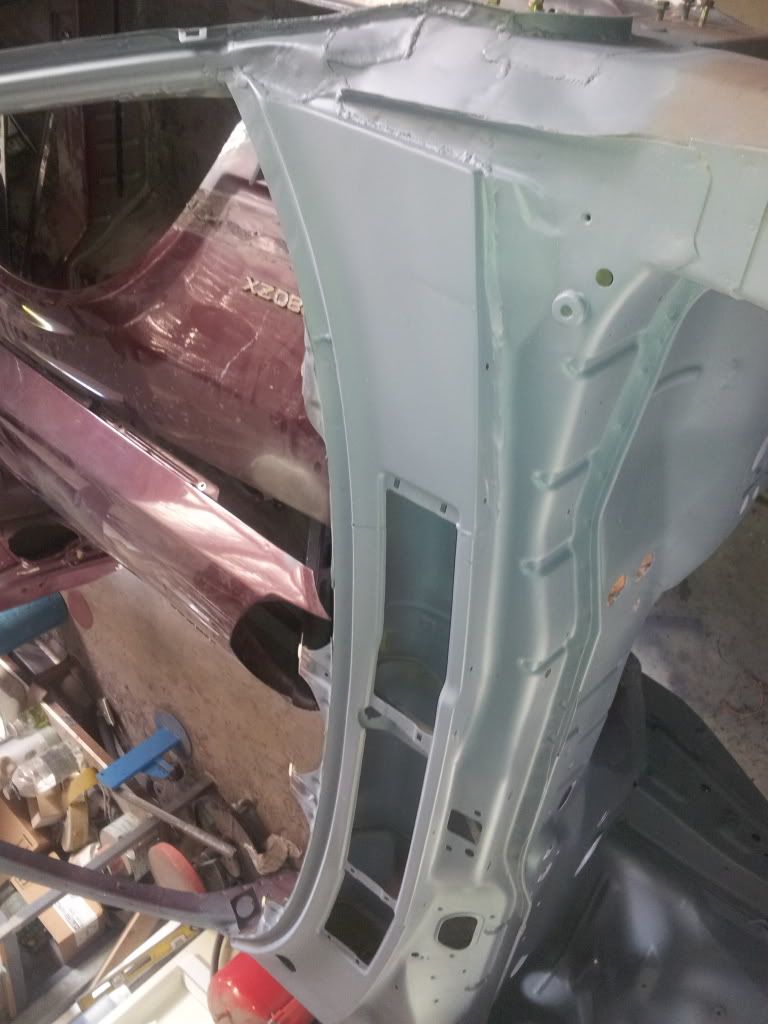

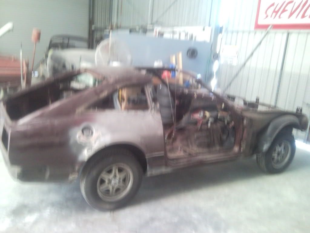

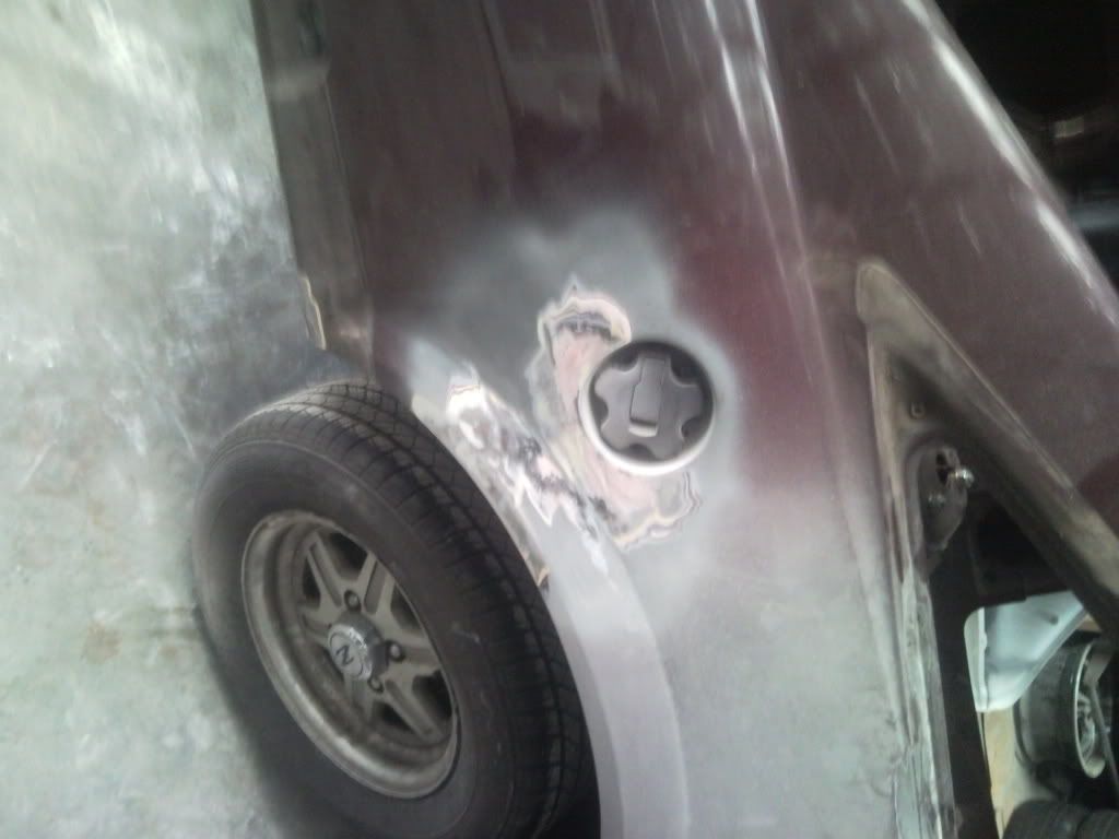

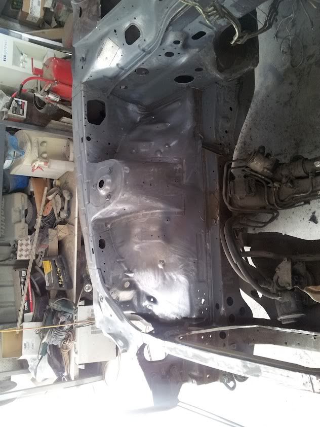

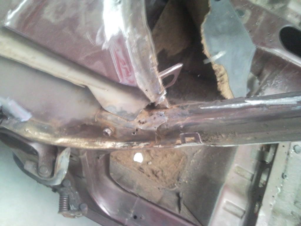

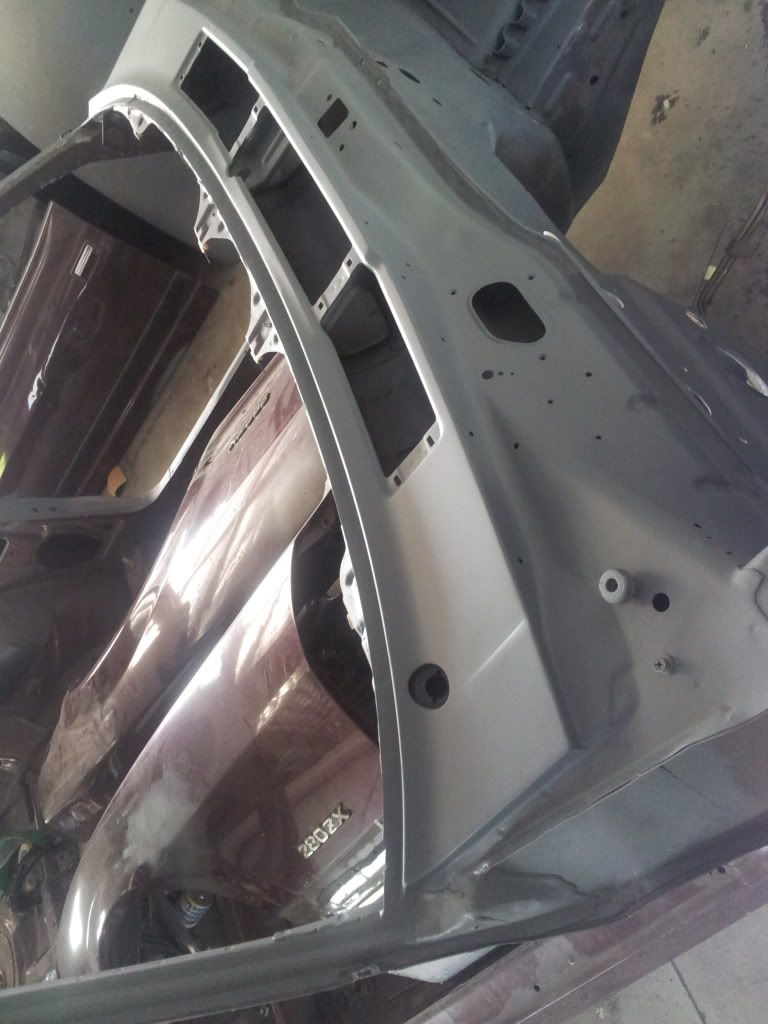

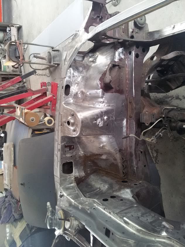

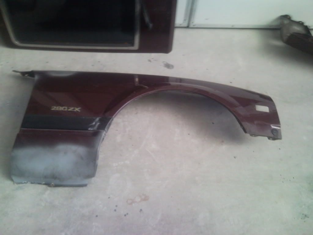

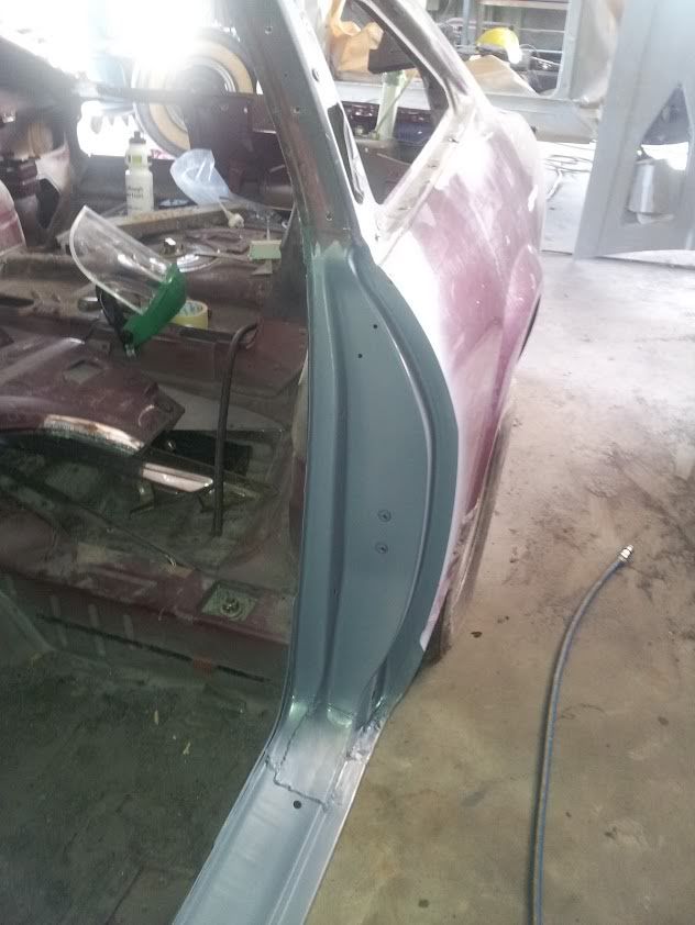

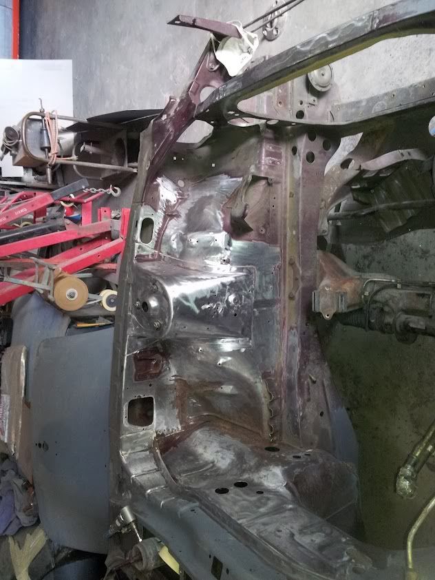

Jordon Posted March 13, 2012 Author Share Posted March 13, 2012 (edited) Ok, So Im back a bit earlier than I expected. Have the day Off work so decided to get all the pictures off my phone that I can and do a full update on where I am at. So since my last post in August of last year, the car has been taken to the panel beater/spray painter. In about December of last year I went to the panel beaters and while he was working on the fenders and sorting out the rust that had to be removed he let me save myself a bit of money and work on stripping the car down and getting it to bare metal. So Basically I got the Engine Bay down to bare metal and Primed to avoid rust as best as possible. After I got that done I started on the area between the engine bay and windshield (As shown below) Then after that I started on the door Jam and the targa top area. So basically I got a bit done and then christmas came around and then I got my new job. So now the rest of the work is up to the panelbeater. As of the end of january when I visited the last of the rust was being removed and the areas being prepped for priming. (Will have pictures next time I go to see the car) Also since last year I have gotten the connecting rods. They are Chrome Moly H-beam Conrods and came with ARP Rod bolts. (picures below) Sorry for all the photos, If there are too many I can cut it down, just let me know. Anyway, next on the agenda I will be buying a lightened kamerei flywheel and then the bottom end of the block will be prepped for the machine work for sleeving and bottom end assembly and balancing. I will keep this thread updated a bit more regularily from now on as things will hopefully be going a bit quicker from here on out. Edited March 13, 2012 by Jordon Quote Link to comment Share on other sites More sharing options...
