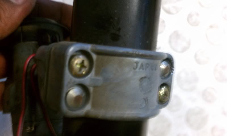

Rimal310 Posted August 17, 2011 Share Posted August 17, 2011 i am trying to remove the ignition assembly and came across these 2 screws that i am kind of clueless on how to remove. I thought they were caps over the screws but am not able to remove them any help will be much appreciated. Thanks in advance! Quote Link to comment Share on other sites More sharing options...
Miles Posted August 17, 2011 Share Posted August 17, 2011 (edited) Those are anit-withdrawal screws. You will have to drill the heads off. Start by center punching the heads then drill a small pilot hole in each head. Then switch to a drill bit that is a little larger then the diameter then the threaded portion of the screw. The bit has to be big enough to allow the cap portion of the screw to completely fall off. Just use normal screws when you replace the ignition switch. Edited August 18, 2011 by Miles Quote Link to comment Share on other sites More sharing options...
JSM Posted August 17, 2011 Share Posted August 17, 2011 This is what I did. Grab your dremel and cut two straight lines into each head. Then simply use a flat head screw driver and remove the bolts. If you don't care about the lock, use a air cut off tool. Makes the line a bit wider for a bigger screw driver! Quote Link to comment Share on other sites More sharing options...
zgeezer Posted August 18, 2011 Share Posted August 18, 2011 Those are anit-withdrawal screws. You will have to drill the heads off. Start by center punching the heads then drill a small pilot hole in each head. Then switch to a drill bit that is a little larger then the diameter then the threaded portion of the screw. The bit has to be big enough to allow the cap portion of the screw to completely fall off. Just use normal screws when you replace the ignition switch. These screws are soft metal. Use a very small chisel, flat bladed screwdriver, or small pointed center punch and place it at the outer edge of the screw at a right angle and tap it with a hammer. This is the way the wrench monkies at my favorite JY do it. Otherwise just dremel a slot and use a screwdriver. g Quote Link to comment Share on other sites More sharing options...
Rimal310 Posted August 18, 2011 Author Share Posted August 18, 2011 Thanks for the tips guys!!! ill go the dremel route today since i do have a dremel sitting at home. Quote Link to comment Share on other sites More sharing options...
