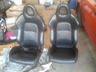

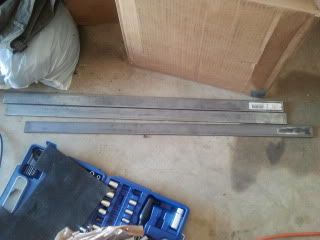

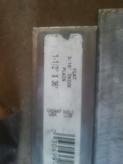

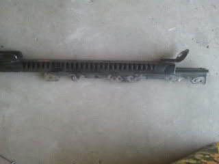

Arif Posted August 18, 2011 Share Posted August 18, 2011 (edited) I've been looking at how others have installed their s2000 seats in thier Zs. As discussed before, the transmission tunnel is too wide to mount the seats with their rails on the 280Z. I didn't want to bash my transmission tunnel in order to get them to fit and I couldn't find a local shop that was interested in welding the brackets like misterz's old s2000 seats. So I headed to home depot and bought metal stock that were 3/16" thick (the others were too thin and flexed easily), 1 1/2" wide and 36" in length. I also bought some nuts and bolts. The seats I'll be installing. Still need to be cleaned after grinding off the rivets holding the brackets to the rails Here's the brackets after the rails have been cut off Here's the rails that were cut off. I won't be using them because I plan to use the stock frame rails These are the metal stock I got from home depot that I'll be using to mount the brackets to the stock frame rails Since I'm removing my Miata seats I'll be heading to the pick and pull to grab a set of stock frame rails. Then I'll bend the metal stock, drill the necessary holes and bolt the seats in. Stay tuned. Edited August 18, 2011 by Arif Quote Link to comment Share on other sites More sharing options...

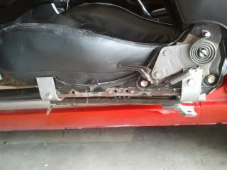

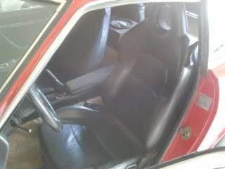

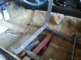

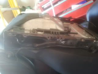

Arif Posted August 25, 2011 Author Share Posted August 25, 2011 I went over to a friends house to bend the metal on his vise. Here is what they look like: Once the metal was cut I bolted them to the stock frame rails: Here is the metal bolted to the seat bracket: The finished product: After finishing the driver's seat I've accomplished my original goal of installing the S2000 seats without bashing the transmission tunnel or welding(used locktite). The process was simple just a lot of measuring, drilling and putting the seat in and out to test fit them. I anticipate the passenger seat will go a lot faster since the measurements are close and I know what I'm doing now. Quote Link to comment Share on other sites More sharing options...

Arif Posted September 23, 2011 Author Share Posted September 23, 2011 I used a drill with a cut off wheel. I think I went through 2 or 3 discs before I got the rails off the seats. It goes easier if you cut off the rivets that attach the rails to the frame of the seats. After the head is cut off of the rivets I just used a hammer and screwdriver to push the rest of it out. I'm assuming you talking about the connector that the seat belt clicks into. My S2000 seats didn't come with seat belt connectors so I used the stock ones. They are so comfortable after you get used to the higher seating position. BTW My driver's side armrest is pushing into the seat when the door is closed. I think I'm going to remove the armrest and cut about 1/2 off of it and reinstall it. The seat belt guide on the side of the seat also rubs so I'm going to cut part of that so it clears. Good luck installing them. You won't regret it. Quote Link to comment Share on other sites More sharing options...

DuoWing Posted September 30, 2011 Share Posted September 30, 2011 One more question, I can't tell from your pic, did you just cut off most of that slide adjustment handle on the bottom of the S2000 seats? I also finished removing the rails from my driver's seat. Is kind of a pain. Basically I just completely removed the seat bracket/rails from my seat, drilled pretty far through the rivets, then using vice grips crushed the one end until it pretty much twisted off, then I was able to then hammer the crap out of the rivets. Quote Link to comment Share on other sites More sharing options...
