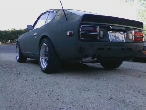

Drax240z Posted September 16, 2011 Share Posted September 16, 2011 205/50R15 on my car. They are small diameter, but I've been reasonably happy with that size with DOT race rubber on them... Gap is deceiving in the photo as I'm braking and turning left. Quote Link to comment Share on other sites More sharing options...
