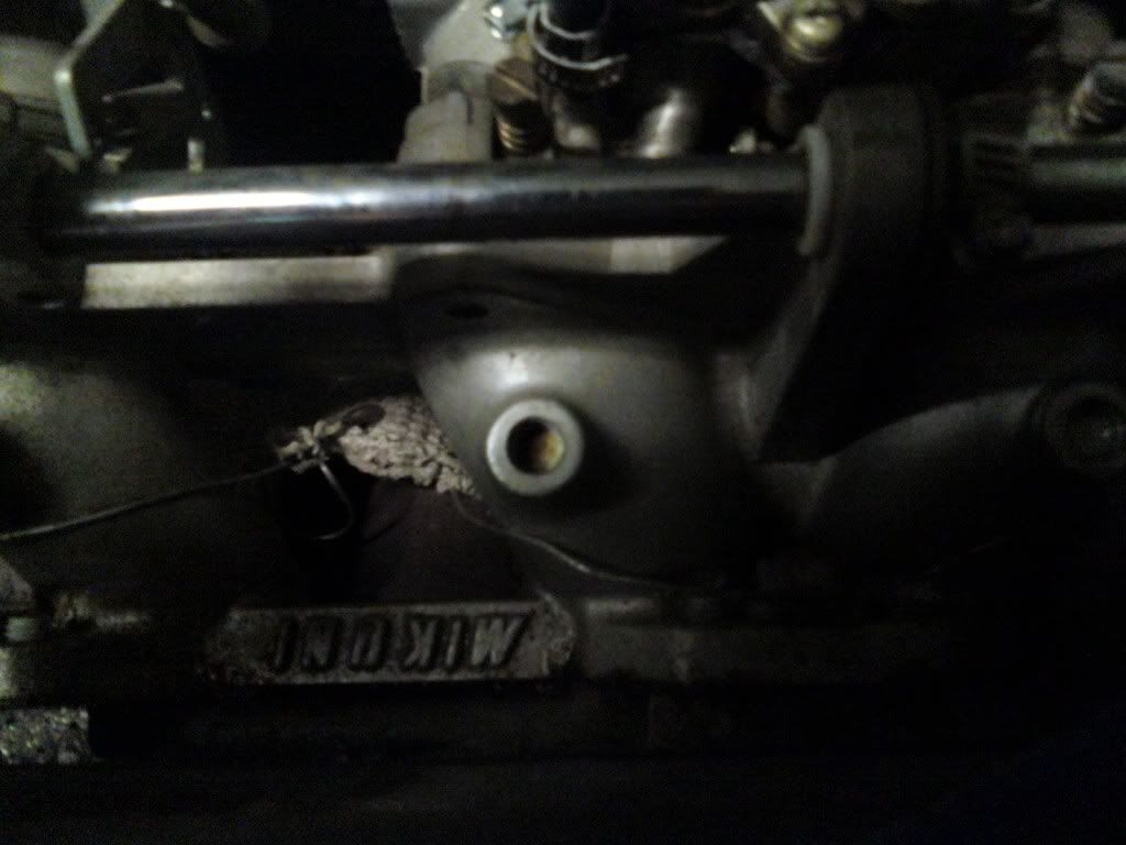

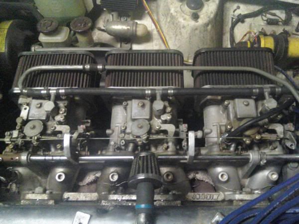

I do have the Mikuni manifold, and on closer inspection with better light, it turns out I have some type of semi-soft plastic looking stuff sealing the port, not metal. It just looked metal on the one port I checked. It's soft enough to press the tip of a knife into with a bit of pressure. I'm assuming these were sealed to prevent a vacuum leak?
Here's a couple pics:
One pic shows overall, I have the allen screws out, but you can't really tell much about them.
Closer pic - turns out it's not solid, it's a white-ish sealant looking material, but very stiff. I can get the tip of a knife blade to dig in.
JM

Update: drilled center of sealant out big enough for the tip of my vacuum gauge. Worked fine, no problems checking vacuum & syncing with the vacuum gauge.
