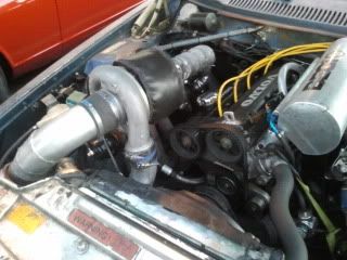

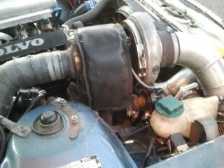

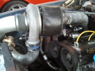

Arif Posted September 24, 2011 Share Posted September 24, 2011 (edited) I went to the local car show tonight and saw this strange looking Volvo with a HUGE turbo sitting on top of the engine. So I park next to him and check out his set up. Here are the details: Volvo 2.4L engine with 11:1 compression, Vovlo/Holstet truck turbo, custom exhaust manifold and dual wastegates. He's running 100% ethanol on this thing. The reason for the dual wastegates is because he's separated the exhaust gases from cylinders 1 and 4 from 2 and 3. This way the turbo sees exhaust gasses in synch rather than all 4 cylinders. According to the owner (who used to work at Bell Engineering aka Corky Bell's shop) another benefit is turbo lag is greatly reduced despite the size of the turbo on a rather small engine. Enjoy the pics: Edited September 24, 2011 by Arif Quote Link to comment Share on other sites More sharing options...

260DET Posted September 28, 2011 Share Posted September 28, 2011 Divided housing turbo's are not uncommon eg VG30ET, although most have a single wastegate. It is a good idea and does work well. Quote Link to comment Share on other sites More sharing options...
