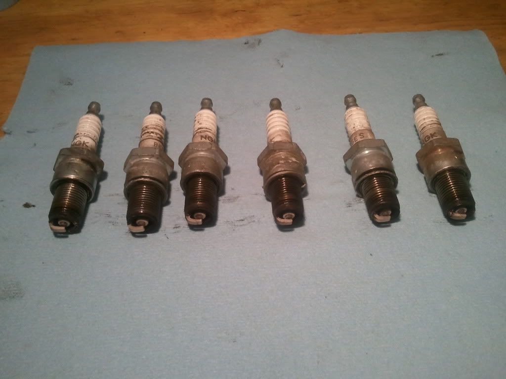

I went ahead and called O'Reilly and got the 3903s. After pulling my old plugs, they look okay, certainly not fouled, but I wanted to get a second opinion, before I put in the $$ Iridiums. Also, if I'm going to gap them below 0.030 anyway, should I have just put in those other plugs already set to 0.031? I've read about people filing down the ground electrode so it doesn't "cover up" the center electrode so much.
So, I know the threads look oily, and the ground electrodes look white and the center electrode looks about the right color. I think this means my burn is pretty good. What do you guys see?
