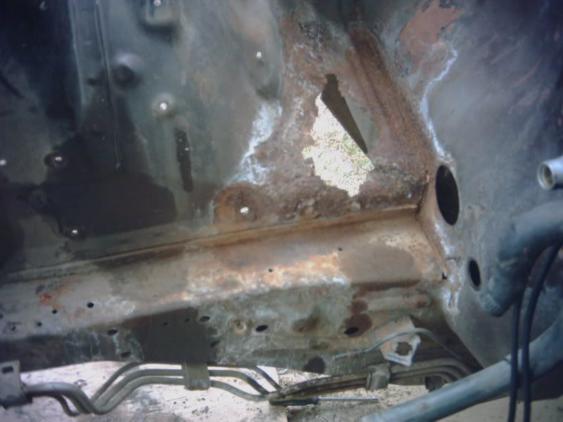

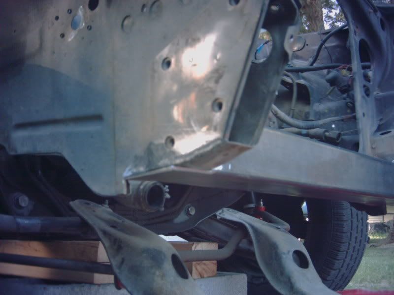

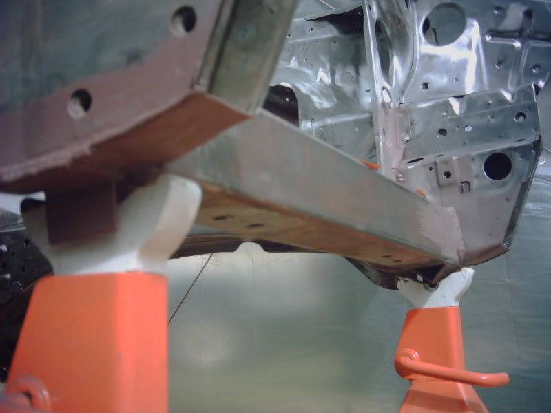

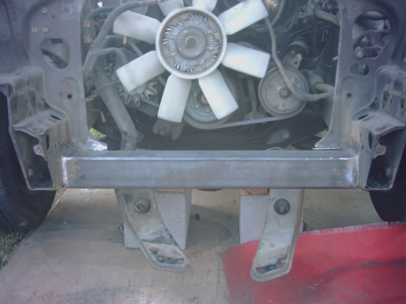

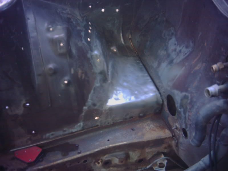

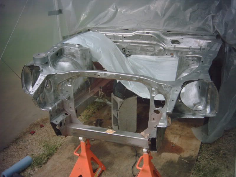

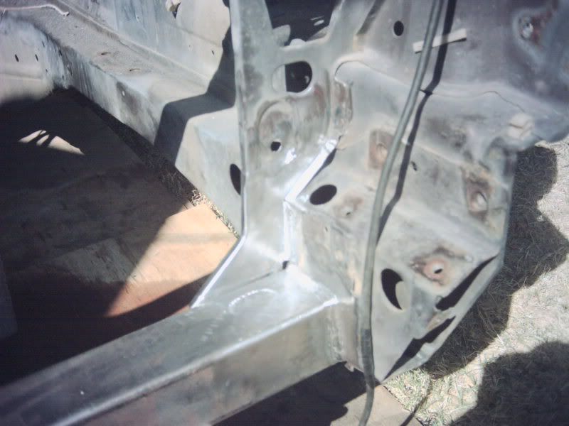

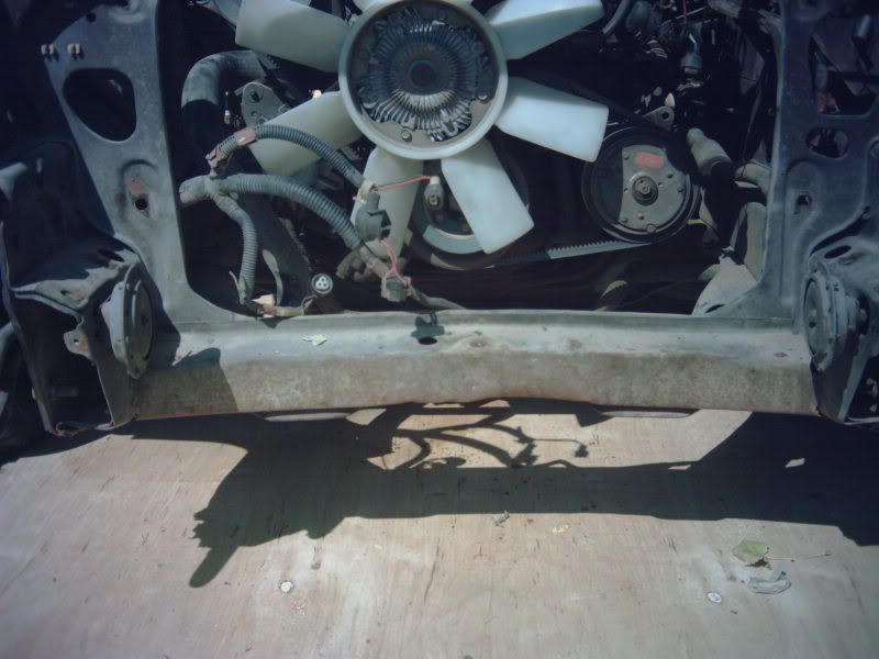

yarddogg77 Posted January 7, 2012 Share Posted January 7, 2012 (edited) Here's a few pis of what I had to do to the front stamped steel cross member on my 280ZX. The PO must have either hit something or tried to jack it up under there. I replaced the stamped steel with 3"x3"x1/8" square tubing. It don't think it hurt to strengthen things a little to. I had thought about adding an X brace but will do strut tower braces later instead. Old one. New one. I had to cut out the lower radiator support to grind the welds which I wasn't to thrilled with. Here's the new piece I made to fill it. Here's the coolest thing about it, jack points! All Done. Edited January 7, 2012 by yarddogg77 Quote Link to comment Share on other sites More sharing options...

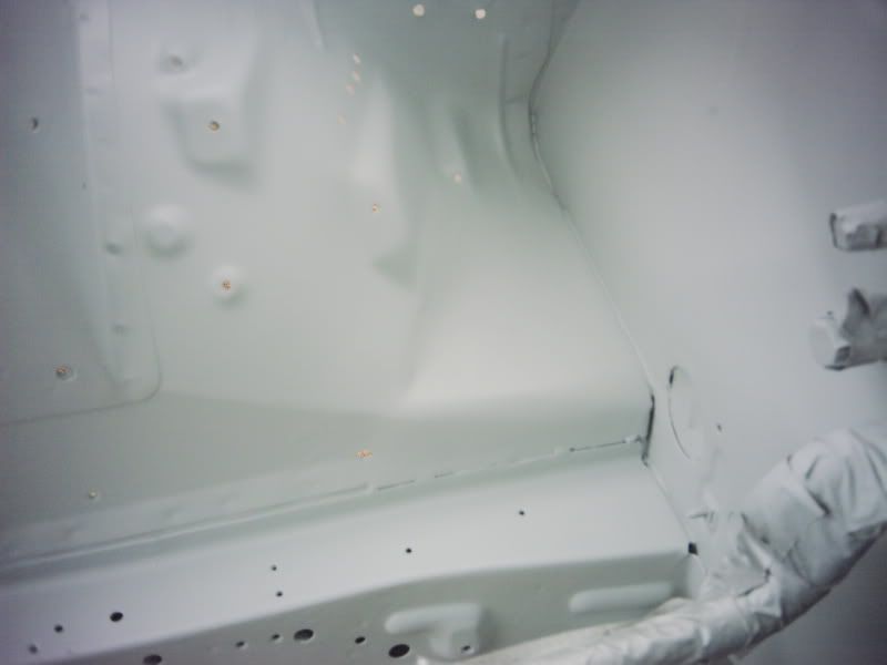

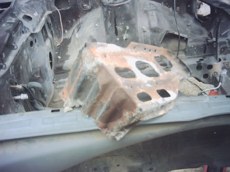

yarddogg77 Posted January 7, 2012 Author Share Posted January 7, 2012 The PO also let the battery boil over for who knows how long so I had to replace some sheet metal under there. Here's the piece I welded back in. I would've preferred a custom cut from a junk yard, but I thought I'd try to sculpt one myself. It didn't turn out to great. At least it's hard to see with the battery in. Here it is after sand blasting a little JB for fill around the welds, lots of think coats of Epoxy Zinc rich primer, and finally Urethane Auto Primer. Looks okay in the end. Here's what's left of the battery tray. I've already cut the bottom off and will use a few pieces of small tubing to remount it to the car. Pics soon. Quote Link to comment Share on other sites More sharing options...
