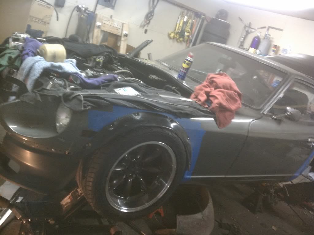

You have to do some serious trimming up front. Kiss your side markers goodbye, and prepare to cut whatever bumper or air dam you have.
This is with 1-2* of camber
I went ahead and put it out to 5*, so I need to cut some more of the bumper. This is about ride height, maybe a little low.
Tires are Yokahama S-drives 275-40-17
Is your camber from lower control arms or camber tops?
I have a little negative camber just from longer lower control arms, and mine don't stick out anywhere near that far. I have classic datsun ZGs, and Hankook Ventus Z214s semi slicks.
I also didn't have to remove my front indicator. How high up did you mount the flares?
