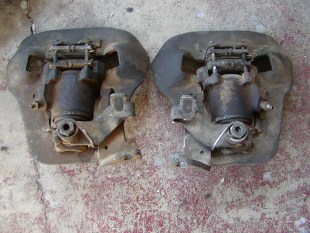

duragg Posted July 8, 2012 Author Share Posted July 8, 2012 240z. Picked up S12W front calipers and rear 280ZX rotors and calipers today. Quote Link to comment Share on other sites More sharing options...
