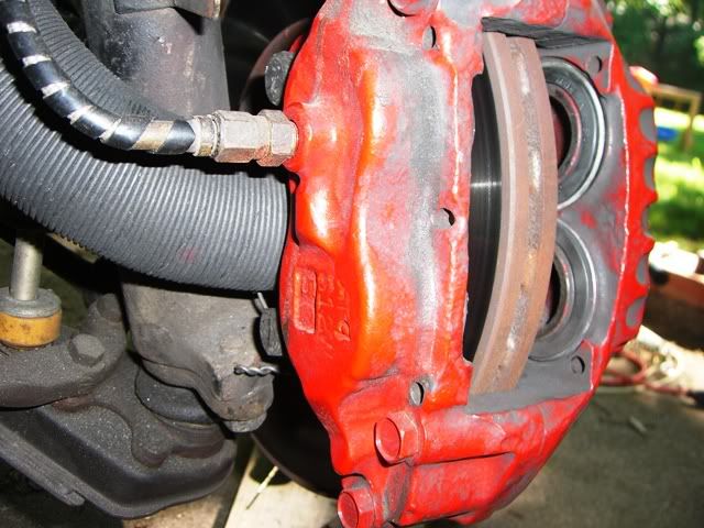

I used the large piston front calipers on vented disks.

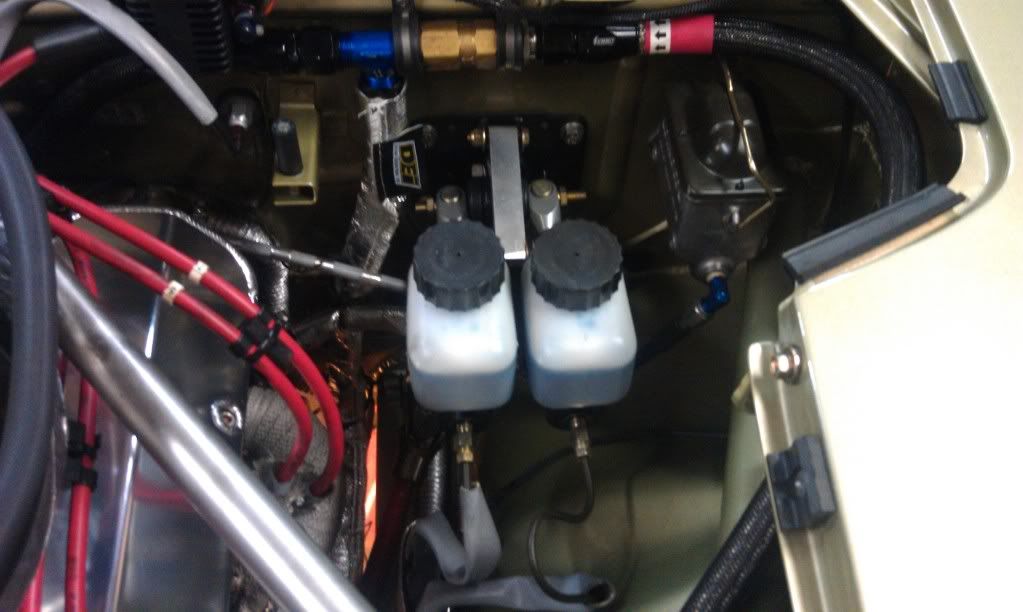

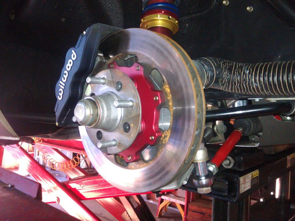

I have since moved to a V8 car with AZC brakes with John Coffey's brake balance bar MC with no booster. That works very well and offers unprecedented bias adjustment in addition to unlimited pad choices.
