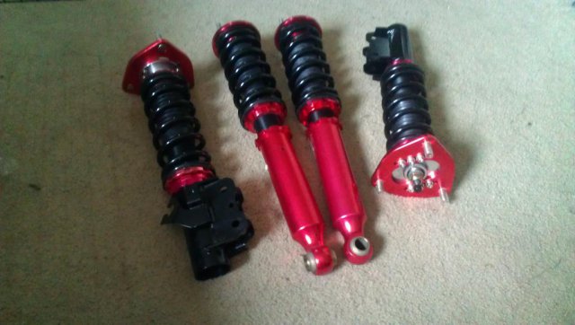

CaptainJoe87 Posted July 4, 2013 Author Share Posted July 4, 2013 Check out what finally came in the mail! Just gotta get the fronts milled and welded. Quote Link to comment Share on other sites More sharing options...
BluDestiny Posted July 5, 2013 Share Posted July 5, 2013 (edited) How much did they run you? Also the rears look ike they're for an s14, but maybe it's just the length of the tube. Those are s13 coilovers right? Edited July 5, 2013 by BluDestiny Quote Link to comment Share on other sites More sharing options...
CaptainJoe87 Posted July 6, 2013 Author Share Posted July 6, 2013 Yep, s13 coilovers, $550 shipped. Gonna get some new rotors, ceramic pads, stainless brake lines, and maybe a bushing kit. That way when its all back together it will be good to go. I was looking at the adjustable tc rods from technotoy but I'm not really sure if I need them or not. Quote Link to comment Share on other sites More sharing options...

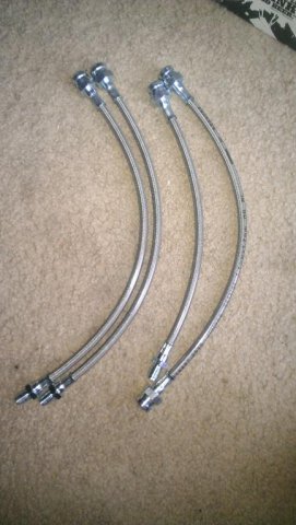

CaptainJoe87 Posted July 19, 2013 Author Share Posted July 19, 2013 I ordered steel brake lines the other day and when I got them they looked like this. The two for the front look right but I haven't been under the car to see if the rears are right. Anyone know what they are supposed to look like and if these look right? Thanks Quote Link to comment Share on other sites More sharing options...
BluDestiny Posted July 20, 2013 Share Posted July 20, 2013 I know the early ZX only has 4 rubber lines, while the later model has 6. not sure if the other rear hose is correct though. It's been like a year since I've redid my brakes Quote Link to comment Share on other sites More sharing options...

CaptainJoe87 Posted July 31, 2013 Author Share Posted July 31, 2013 Got my rear coilovers in today. Woot! Fronts in tomorrow hopefully. I really hope these settle a little bit more because I'm still at 24.5" from fender to ground. Quote Link to comment Share on other sites More sharing options...

CaptainJoe87 Posted August 3, 2013 Author Share Posted August 3, 2013 (edited) I did. I have about 1.5" I can still come down in the rear without taking collars off. I used the stock top hats as opposed to drilling holes so that alone gives me an extra 2" of height as opposed to the ones on the coils. Just got the fronts on yesterday and they are totally slammed out, still have all the collars on them too and my front fenders are 22" from the ground. The rears settled a bit more so I'm 23.75" each rear and last night I was 22" fronts. All the vitals still have about a three finger gap from the road too. (Oil pan, frame, stuff like that.) Had to run 1/4" spacers up front to get the tires to spin. It looks good, so I will take some pictures asap. I'm waiting on ordering my wheels for now. Gotta make sure I get the right backspacing or spacers. I am leaning towards Rota rbs pretty hard right now. Side note, there is a turbo zx at the junk yard and it is kinda hard not to go pull all the turbo parts and get sidetracked on my build. If anyone needs turbo stuff, it looked all there. Oh, and my exhaust scrapes everywhere... Hahaha the header doesn't run perfectly even with the frame, it comes down a bit so ill either hope to catch it on a speed bump and bend it up, or go out with a hammer or something to prevent myself from scraping a hole in it. Edited August 3, 2013 by CaptainJoe87 Quote Link to comment Share on other sites More sharing options...
