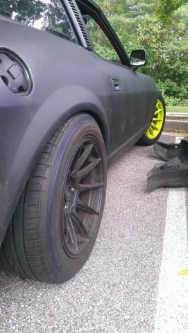

CaptainJoe87 Posted August 6, 2013 Author Share Posted August 6, 2013 Yea, I measured it yesterday. Stock wheels are 14x6 +12 making them 4" backspace. Mine have some beefy 205's on them I think and even with a 1/4" spacer up front they still rub tire. But with some tire stretch and a 1/4" spacer the Rota rbs should fit fine. The only issue now is that racinglab.com has the 17x9.5's on back order for about a month. I want to start looking around but I want to find something with a deep lip at a similar price. No more group buy prices on the rotas so its $1028 shipped now... Know any other brands to start looking at? Quote Link to comment Share on other sites More sharing options...

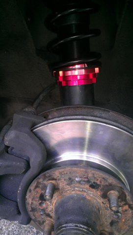

BluDestiny Posted August 6, 2013 Share Posted August 6, 2013 Not in your price range. I'd just start lurking on zilvia for some random wheels to show up. As for the 6spokes's, I had them on my zx with 235's (came with them) and they cleared shocks/springs. They shouldn't be rubbing anything except maybe the coilvoer perch. Do you have any pics of the coilovers installed? Quote Link to comment Share on other sites More sharing options...

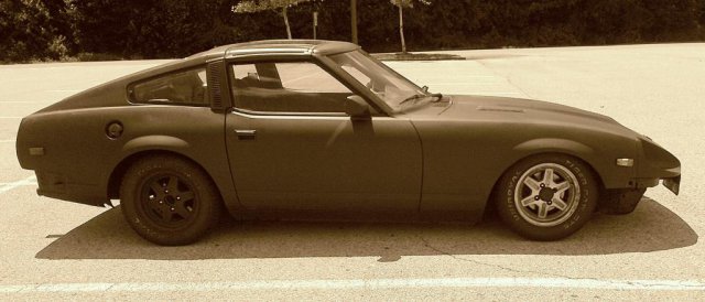

CaptainJoe87 Posted August 6, 2013 Author Share Posted August 6, 2013 The tire rubs one of the coils, but I still have my 1" spacers I might throw on. I did get bored and curious today so I put this guy back on. Not sure if I want to keep it on again but we will see. Quote Link to comment Share on other sites More sharing options...

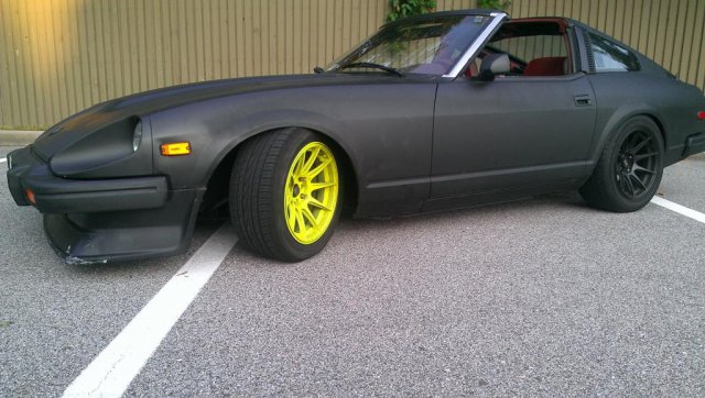

CaptainJoe87 Posted August 7, 2013 Author Share Posted August 7, 2013 I forgot to take a picture of the coils but I did get this one. Dumped the back out so its more even with the front and 1" spacers all around. No more rub up front and I think it looks pretty damn good. Hahaha Quote Link to comment Share on other sites More sharing options...
CaptainJoe87 Posted August 7, 2013 Author Share Posted August 7, 2013 I lied. It'd not the best picture though. Quote Link to comment Share on other sites More sharing options...

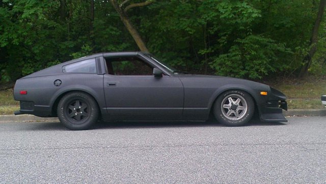

CaptainJoe87 Posted August 17, 2013 Author Share Posted August 17, 2013 Had to raise it up a bit in the front and adjust the camber a bit, but I got the xxr 527's back on there with 1" spacers. Had to roll all 4 fenders hammer style so I didn't rub. The rears however have 1.25" of spacer on them. All in all I think it came out well and driveable. Hahaha Quote Link to comment Share on other sites More sharing options...

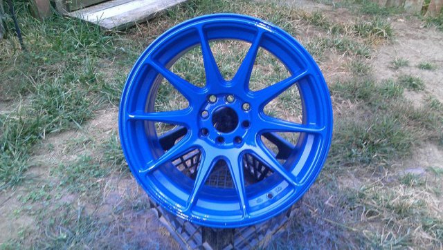

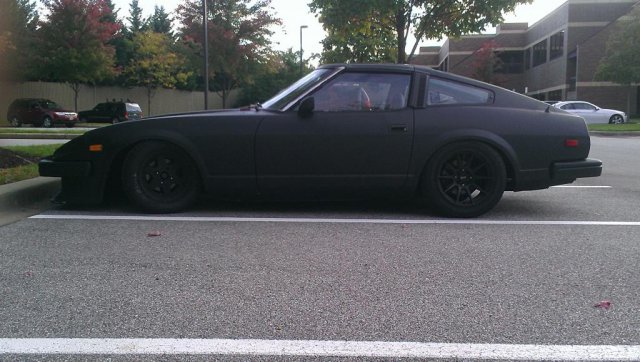

CaptainJoe87 Posted October 23, 2013 Author Share Posted October 23, 2013 Took the lock collars off the rears today in an attemp to sit closer to even. Not too bad but still want to get it lower. Also got two of the four xxrs painted again, just sand paper and krylon. Other than that, I've started pulling all the faded red plastics out of the inside. Not quite sure what the end goal is with that, but stripped looks better than cracked faded junk. Throwing a really awesome front bumper idea around with a buddy that does really good fiberglass work. We have also been kicking the idea of a fiberglass dash around so ill keep everyone posted on that too. Quote Link to comment Share on other sites More sharing options...
