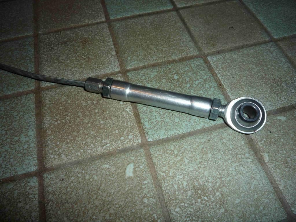

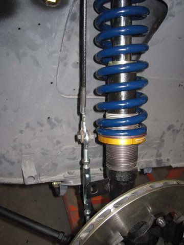

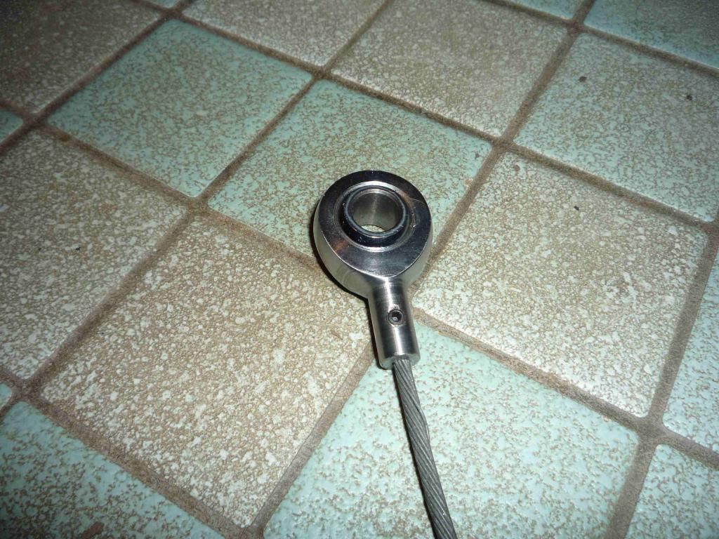

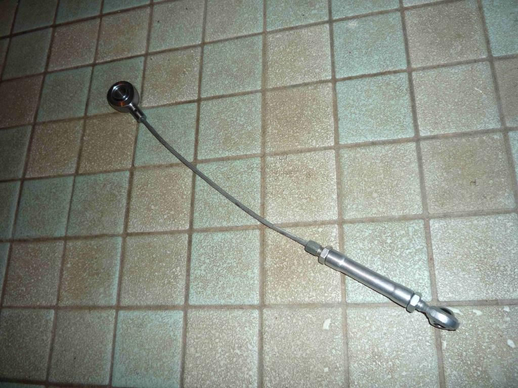

old-git Posted April 9, 2013 Share Posted April 9, 2013 Not fitted to a Z, but here is my offering. Handbrake cable attached to rod end and home made turnbuckle. Cable is held into rod end with a grub screw (cable is puhed into a recess opposite grub screw so held very securely) so length can be adjusted when first fitted to the car and fine adjustment is taken care of by the turnbuckle. Quote Link to comment Share on other sites More sharing options...
RebekahsZ Posted April 9, 2013 Author Share Posted April 9, 2013 What on the car do you attach it to? Quote Link to comment Share on other sites More sharing options...
