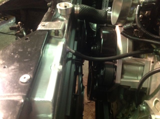

MaxxAction Posted August 21, 2014 Author Share Posted August 21, 2014 So... I finished my swap about 6 weeks ago. No turbos, yet. Cool story of how I came by this motor. I saw this motor on ebay, and called the guy. He said he took it in on trade towards a race motor he built, and it's just been sitting in his shop for the last three years.The guy gives me the address, and tells me to come to the back of the building. I had no idea what this place was.I pull into this place, and I can see through the bay doors on the side all these huge mills and machines. Turns out, it is a machine shop that makes exotic parts for NASCAR engines, wrist pins, retainers, locks, etc, and for companies like Ferrea, CP, Wiseco. And they build engines for SCCA, and Trans-Am racing teams. This place was incredible.He showed me around, and as we are walking past these tables, I see work orders for Joe Gibbs Racing, Burger King Racing, Ferrea, CP. He shows me a set of rods and pistons out of a Nascar engine, a blank billet that is getting carved into a nascar cylinder head. As you can imagine, I am walking around with a semi-stiffy this whole time.Those nascar engines use what's called a "ring Seal" piston, no skirt. The rods are absolutely amazing, made of some material I have never heard of, and cost about a thousand dollars apiece.Now when he rebuilds these motors for the road race teams, they just install all new stuff, and discard the old, even if it is perfectly serviceable. He has boxes and boxes of forged rods, pistons, valves, valve springs, cams, etc.So finally, we go to the back corner of his shop to check out the motor after I wipe the drool off the corners of my mouth. I ask him to pull the plugs so I can look at the bores, turn the motor over a couple times, etc.We get the plugs out, go to turn the motor, and it won't turn. Looked a little closer, and one of the cylinders was full of water. Shit.So he kinda freaks out. Apologizing all over himself, telling me that the the motor was running, seemingly well, three years ago when it came in his shop, that he took it in on trade towards a racing motor but never touched it cause the road race motors are all LS-6 four inch bore motors, he couldn't use the block, so it just sat. He said he knew the guy, and the car, and had no idea anything was wrong with the engine (his buddy took advantage of him sounds like to me) and that he can't understand how this happened.So we talk about it for awhile, and he sticks his hand out and grabs mine and shakes it, and tells me that he's going to put it back together for me with parts outta their shop, and sell it to me for the same price. He said it was abusy time for them, and it would take a couple of months (it was actually about four months) but that he would get it done. I offer to give him some money to start on it, he says "no, you drove all the way over here, and this is not how I do things, I am going to make this right. I'll send you some pics when I get started on it, and you can come pick it up when it's done." The motor was completely gone through top to bottom. New bearings, rings, Mahle Pistons, a set of crower forged rods, a 575 int/574 exh total lift, 224/224 duration 112 centerline cam, mild porting on the heads, Gm performance 600 lift springs, all new gaskets, ready to roll. Talk about stepping in shit and smelling like a rose. Anyway, I got the motor back in may, and earnestly started working on getting the car ready to accept it. You can see in this pic how I set up the cooling system. The water pump is off of a c6 vette, which flows a little better, and picks up about 2.5 inches of clearance. The radiator is a perfromance model for a Sentra Spec-v, and I had the inlet modified to line up with the waterpump outlet. I had to trim the core support, and cut the stock radiator brackets out in the bottom of the core support to make it fit. The fans are Felx-a-lite fans for a Jeep CJ7, supposed to be good for 2800 cfm. The fan works fine, but the radiator is actually right on the edge of keeping the motor cool. I am going to add an 11x11x2 heat exchanger on the heater core circuit with an 8 inch fan on it, which should give me the extra cooling CI I need to solve the problem. I had to fabricate the heater hoses, radiator hoses, throttle cable bracket, vacuum and PCV system, etc. Last week I fabbed up this air box to draw cool air from outside the bay cause these damn engines run so hot that it was saturating the IAT and throwing my idle into oscillation. I still need to add a cover of some sort to the hole in the fender well. Overall I am very pleased with the results. I still need to get it to a reputable tuner to get it dialed in right, but even with the tuning I have been able to do just driving it, it pulls very hard. I don't think it is as high of HP as the VG was when it was right, but I have about 1500 miles on it so far, and no mechanical issues. Gotta be some kind of record. Quote Link to comment Share on other sites More sharing options...
