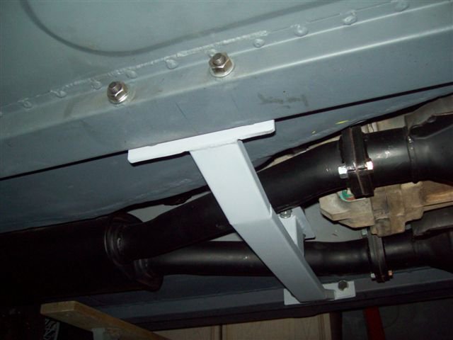

While I have the car upside down, I am thinking of welding a few cross braces from one to the other. Maybe a weld in drive shaft loop...??? Anyone here done it?

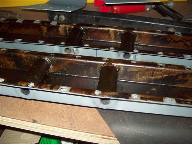

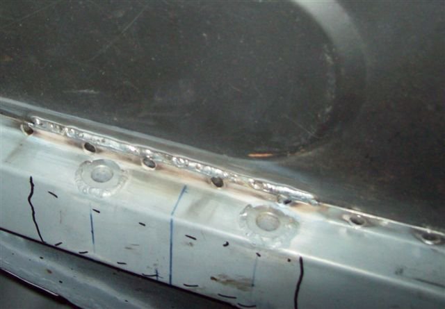

That said for piece of mind, I cut 1/8" steel plates to reinforce the front frame rails with the floor Baddog rails at the junction of the dog leg and also welded the edge to the firewall.
I then welded in the custom T56 mount to the floor pan and the Baddog rails, the center section of the mount has 2 large bolts on each side. (The drawings for this T56 mount are on this site, if you can't find it I have it)
I then fabricated a 3 point front strut bar brace and a triangulated rear strut bar brace. I also welded in more plate to the front frame rails for the large sway bar mounts.
