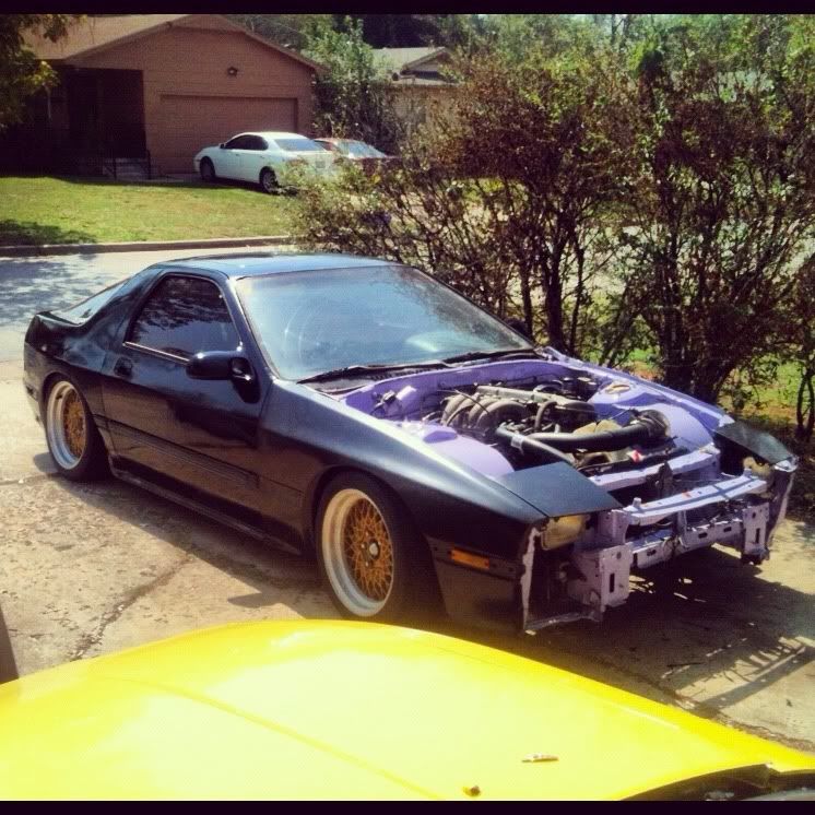

And here's a couple pics of my RX-7 if anyone's interested haha
