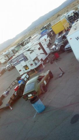

duragg Posted November 3, 2013 Author Share Posted November 3, 2013 First time at Chuckwalla, qualifying for Saturday race.. Lap 4: Powpowpowpowpow... so I let off, then tried again... powpowpowPOW Pulled off to infield and took the hook. Found Dustributor now turns at random and useless times. Done for 2013, thx to "The Probe" for all your help and unstoppable enthusiasm. Quote Link to comment Share on other sites More sharing options...
