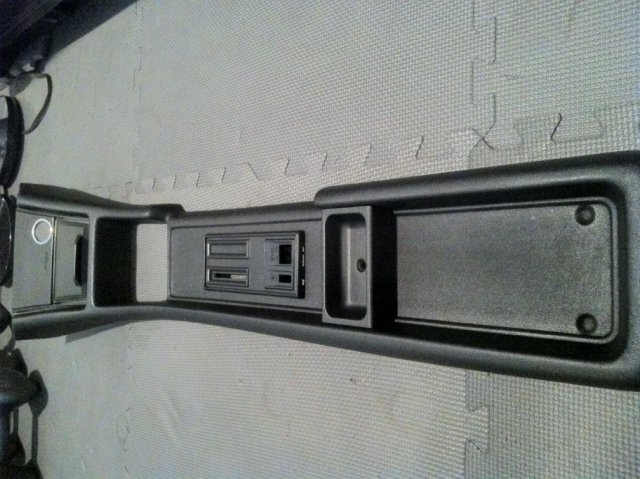

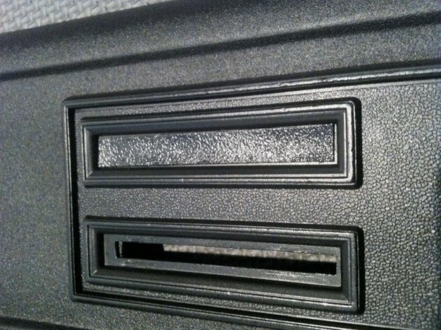

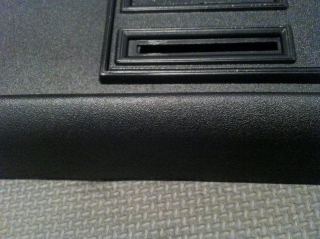

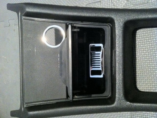

nix240z Posted July 30, 2013 Author Share Posted July 30, 2013 center console pics, which do not show how really nice this console looks. NOS ashtray... I was even able to duplicated the tape... zero stress cracks... Quote Link to comment Share on other sites More sharing options...

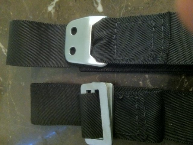

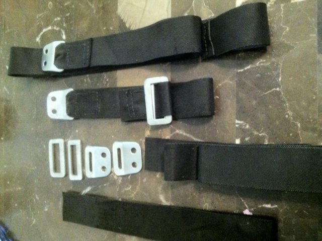

nix240z Posted August 10, 2013 Author Share Posted August 10, 2013 refurbished the luggage/cargo straps. Completely disassembled the straps, refinished the hardware with zinc plating. I dyed the straps black and hand stitched them back together. Quote Link to comment Share on other sites More sharing options...
1 tuff z Posted August 11, 2013 Share Posted August 11, 2013 Nice. I have a few spare luggage strap sets that I've hung onto to do as you did... Quote Link to comment Share on other sites More sharing options...

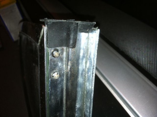

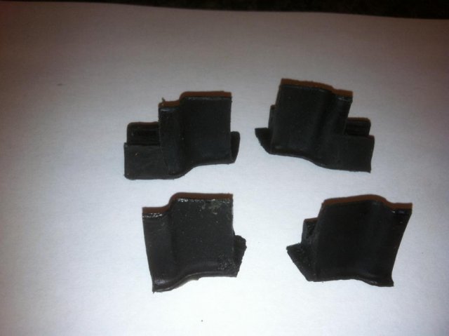

nix240z Posted August 13, 2013 Author Share Posted August 13, 2013 (edited) A Project within a project, that is how I roll .... Another item that I had to make, it's the upper rubber for both the right and left quarter windows... Edited August 13, 2013 by nix240z Quote Link to comment Share on other sites More sharing options...

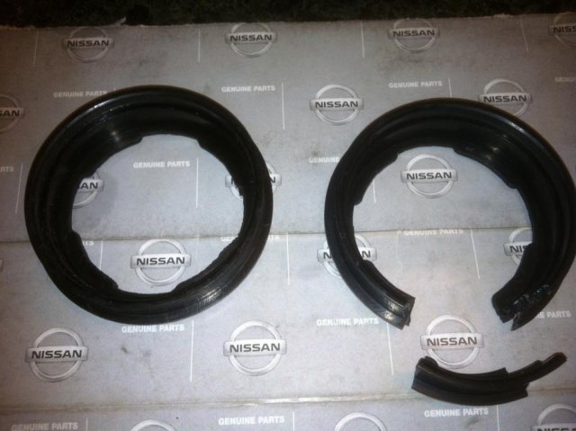

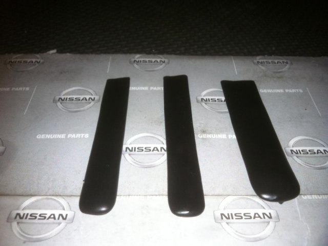

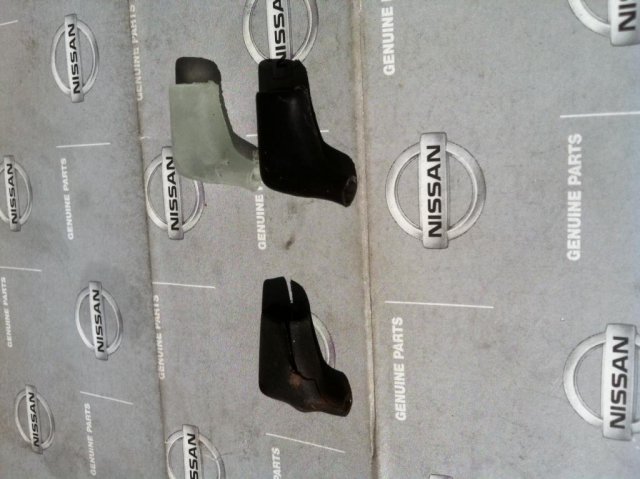

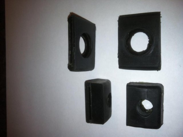

nix240z Posted September 3, 2013 Author Share Posted September 3, 2013 (edited) If I could ever stop making rubber parts, I might get some work done on the car. But at this point is all about the fine detail. Made the correct upper quarter window rubber for build date of 7-71.. Both type show here, early and later style. Made the correct bumper to fender shims for the front and rear. Made the correct headlight bucket wire rubber insulator, that old cracked up thing of a insulator just would not work for me. Edited September 3, 2013 by nix240z Quote Link to comment Share on other sites More sharing options...

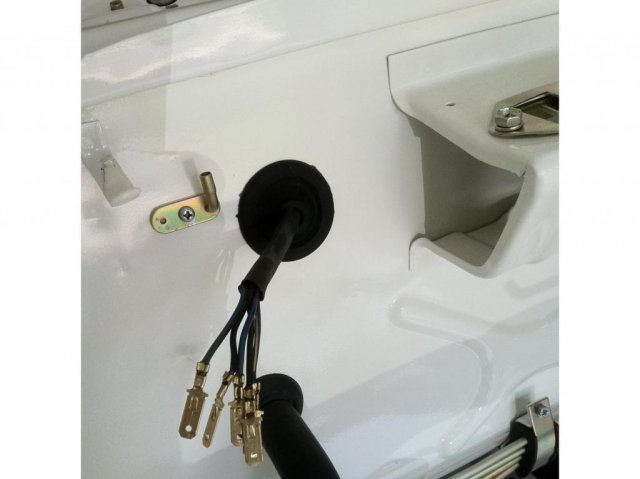

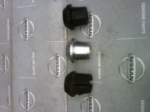

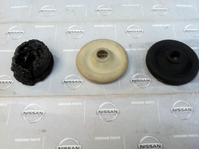

nix240z Posted September 8, 2013 Author Share Posted September 8, 2013 Machined, molded and produced a new wiper motor wire rubber insulator. Quote Link to comment Share on other sites More sharing options...

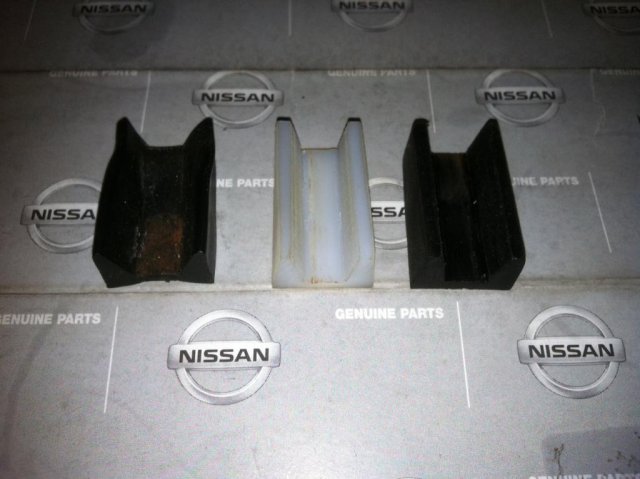

nix240z Posted September 11, 2013 Author Share Posted September 11, 2013 Went to check the condition of the inner door lower window bumper, Well I had one and the other one was missing. Yes you guessed it, I made one. So replace your missing or worn out bumper. Quote Link to comment Share on other sites More sharing options...

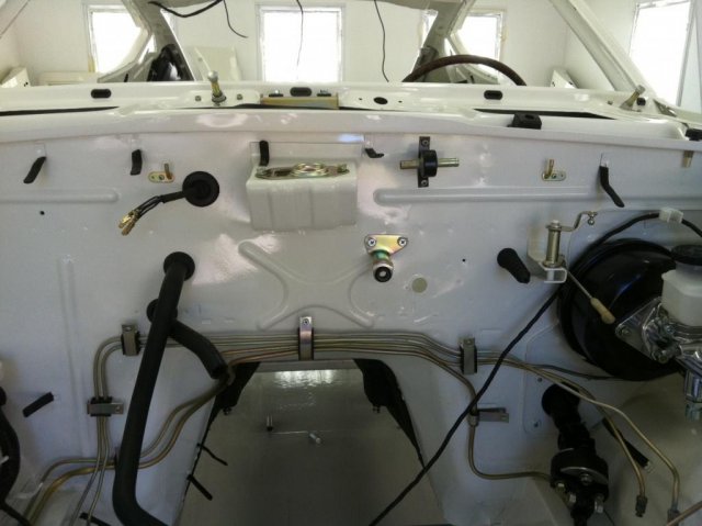

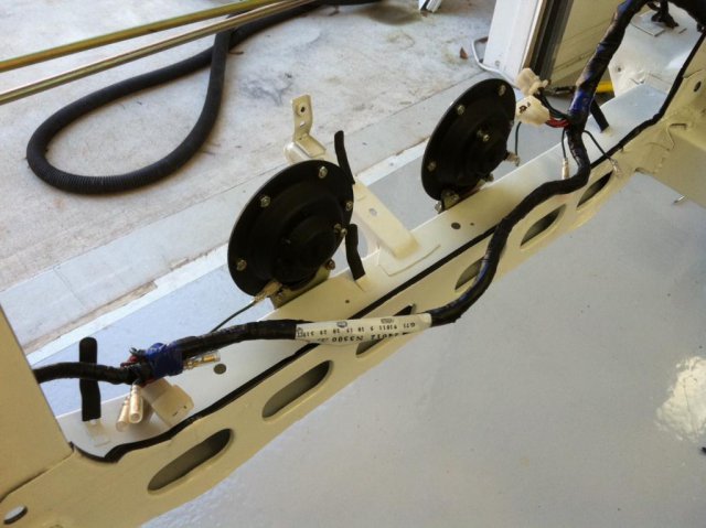

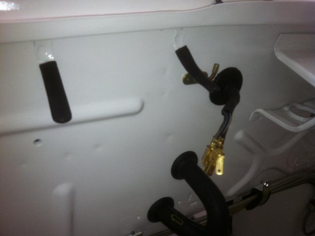

nix240z Posted September 25, 2013 Author Share Posted September 25, 2013 Made the rubber coating on the wire harness bundle wraps that are predominately found in the engine bay. These are very hard to make since the sidewall is very thin. There is a total of 19 skinny and 2 wider type. I don't think I can make the ones for the main wiring harness. Quote Link to comment Share on other sites More sharing options...

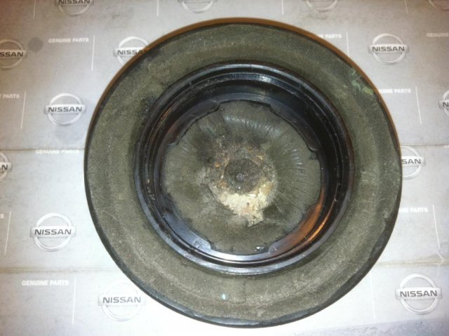

nix240z Posted September 25, 2013 Author Share Posted September 25, 2013 Just making parts that are no longer or ever available from Nissan. Steve, you are z urethane/rubber master! Tired of gluing your horn pad back on, I know I was.... reproduction of the original plastic insert that always cracks. A high performance urethane with very high compressive strength and tensile strength. Shore D Hardness; 85. Very easy to cut out the old cracked or broken insert and epoxy glue the new reproduction of the original back in. Quote Link to comment Share on other sites More sharing options...

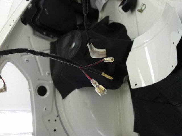

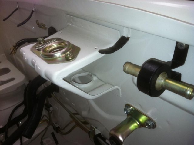

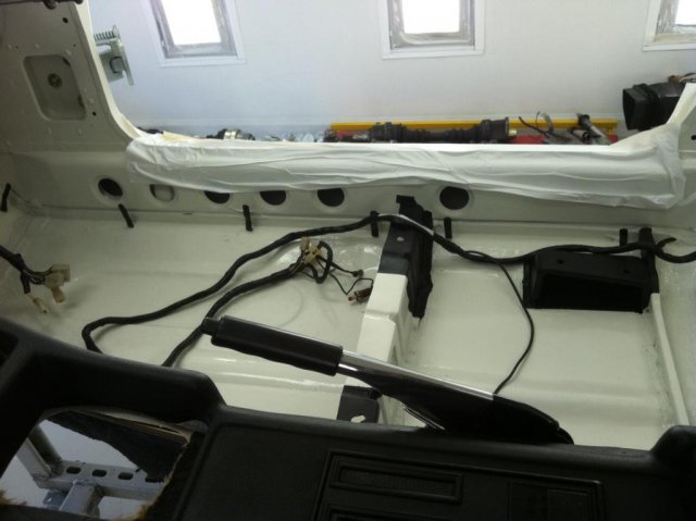

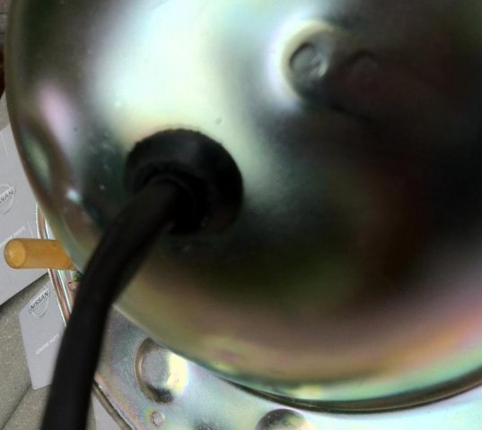

nix240z Posted October 20, 2013 Author Share Posted October 20, 2013 All in the tiny details at this point in my build. I have replaced all 40+ rubber tabs that hold the wires to the body. I had to reweld a few tabs that broke off while moving the tabs. Welding after Paint so I had to be very careful while doing this. I could not stand looking at the yellow/worn out defrost wire boot, so I molded my own in clear and also a black version. I went with the clear version, just like the original. The one on the bottom is the original and above are my reproductions. Quote Link to comment Share on other sites More sharing options...
