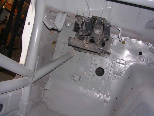

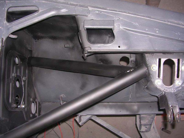

RebekahsZ Posted August 14, 2013 Share Posted August 14, 2013 Getting closer to building new rollbar. I'm listening to and hearing all the stuff about hitting my head. AND, I don't think I'm likely to get the car under 10 seconds in the quarter with the way I'm tearing things up with just my current power level, so I would be NHRA legal to 9.99 with just a 6-point rollbar that includes door bars. I really want to try to get some chassis stiffening (doors don't close well). Anybody have any pointers on where to make the forward leg of the door bar attach to the Z chassis? I'm torn between attaching it to the inner rocker panel vs. attaching it to as far as possible down in the footwell. Post pictures of your favorite design. Quote Link to comment Share on other sites More sharing options...
JMortensen Posted August 14, 2013 Share Posted August 14, 2013 The problem with door bars is getting access to weld around the whole tube. I ended up cutting holes in the fenderwells and in the door jamb for access. If you want foot protection I think my bar from the bottom of the A tube pillar to the front strut tower does double duty and gives decent foot protection and adds to the chassis quite a bit. In your case, just do a dash hoop like you would see in an older convertible, then run the bar from the bottom of that to the strut tower. Might have to be a little choosy with your placement to avoid the brake and clutch masters. Quote Link to comment Share on other sites More sharing options...

johnc Posted August 16, 2013 Share Posted August 16, 2013 Another door bar issue is that the NHRA style of 6 point cage with the door bar up into the footwell is:There is no lateral support for the front of that bar in a vehicle to vehicle side impact. The front of that bar is going to bend inward with the rocker panel and floor pan and take out your legs. With a full roll cage you have the front hoop and knee bar to transfer load across the car. If you can build a low front hoop/knee bar structure behind the dash that will help a lot with side impact safety. Quote Link to comment Share on other sites More sharing options...
RebekahsZ Posted August 16, 2013 Share Posted August 16, 2013 Yes sir, we have discussed that before and I agree. This darn car is so full of compromises and the rollbar/cage will be a compromise too. Realistically with my lifestyle, this is a drag/autocross/2track day a year/drive to work to keep battery charged car. I'd like to stiffen up some but the minimum rule book I will try to confirm to is NHRA/IHRA for drag. I want to have heat again someday and a radio, so that makes a knee bar unlikely. I recall our discussions about roll cages and smacking the head. And I REALLY don't want to pull my dash (I hurt for weeks after working under there). So I think I'm gonna do the best I can with a six point (plus every pound costs hp). So, I'm really looking at where I should attach the forward legs to stiffen best if that is all I do. Rocker? Firewall? Junction of rocker and firewall down in the corner of the foot well? Quote Link to comment Share on other sites More sharing options...
JMortensen Posted August 16, 2013 Share Posted August 16, 2013 Use lighter tube for the stiffeners. Mine are 1.625 x .065. 1.08 lb per foot. Quote Link to comment Share on other sites More sharing options...
