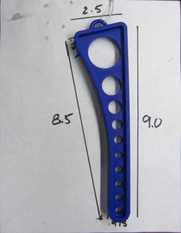

I received the Powerbuilt timing chain wedge tool today from ToolSmith. Nice piece. Its rubbery and appears well made.
I've attached a nice pdf with a picture of the tool scaled to real size so you guys anxious to make one of your own can do it easily.
Print it to 8.5 x 11 paper with NO scaling or centering or margins, or whatever your printer driver would like you to use. The real dimensions are on the picture as well for comparison.
The only part that didn't scale very close to reality is the width of the skinny part of the bottom. It is 0.975 inch wide, not the 1" that comes out on the paper print. There is some photographic distortion from paralax I'm sure.
Enjoy!
(Edit) seeing that photo, the difference in the one I had stolen was at the botom end, maybe the bottom two holes up, the thing was a smidge wider--when it went past the tensioner, you felt that wider part pass and it got easier to drop in. I guess it kept inadvertent snagging of the pull wire from easily dislodging it. it would lift a bit, then get snug.,.
