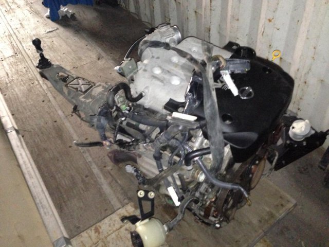

I just wanted to drop in here and say that there will soon be a new VQ swap here on HBZ. I was going to build a mild L28 and triples, but I recently found a deal I couldn't pass up on a VQ pullout and will be assembling the car over the next few months.

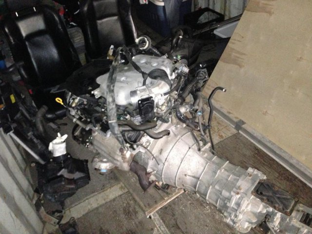

A guy building a drift 350z sold me his 80k mile VQ, harness, pedal, ECU, radiator and fans, trans, driveshaft, NATS and key, and a pair of leather seats for $1700 delivered to my door!

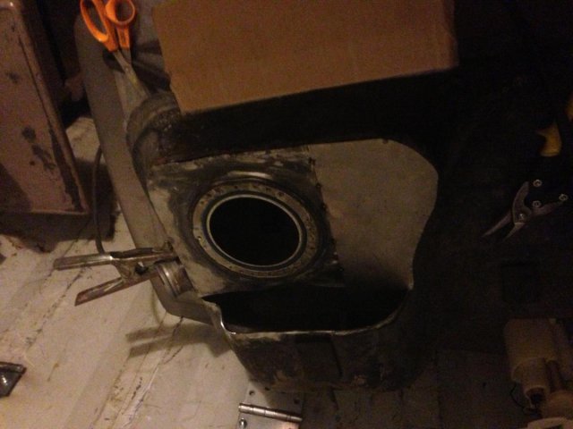

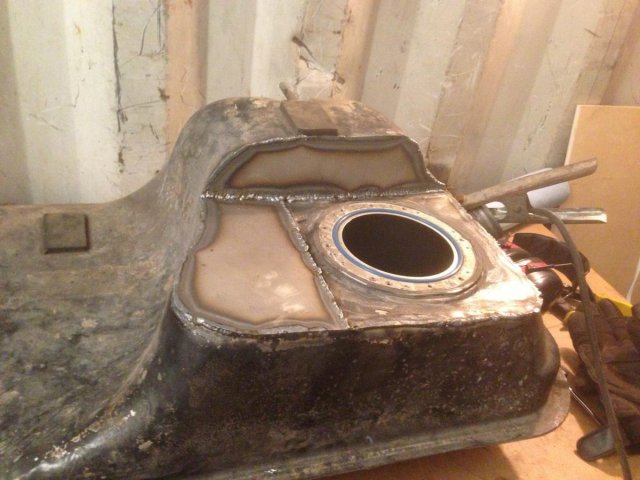

350z gas tank and pump are on the way, I hope to cut out the mounting flange for the pump and weld it into a baffled 76 tank I'm picking up.

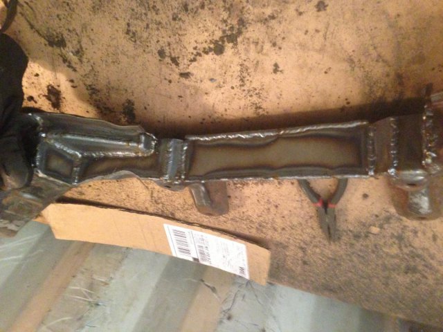

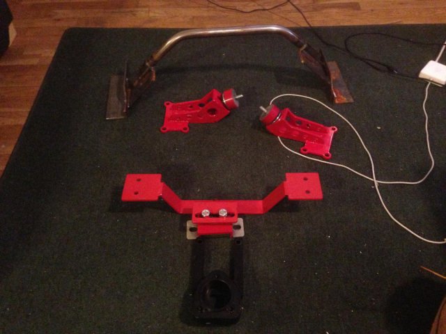

Finally, I also have mounts now.
Getting there!

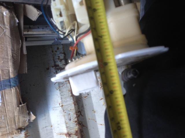

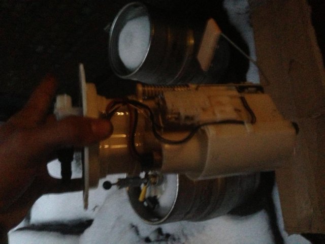

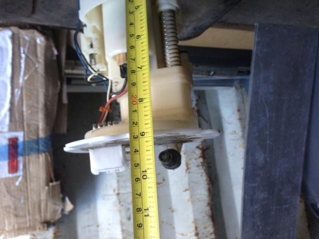

Got the 350z tank and pump. The pump assembly has a spring loaded base that acts like a little surge tank. I haven't looked at it too closely, but it seems to be locally fed as well as fed by a line hat runs to the other side of the tank. The spring action gives an inch or two of play with the mounting height, and running that other line to a baffle box should avoid any starvation issues, the fuel pump itself draws from the surge box. The tank is thankfully metal so welding in the flange should be straightforward. Looking good so far.
nice,  I hope that the height won't be a problem.  I was thinking a mounting ring from the plumbing aisle at lowes might work to reenforce the tank where the pump will mount.  I think the diameter is about 5"...   Yeah you'll need a BCU, but from what I understand any BCU from the same year will work.

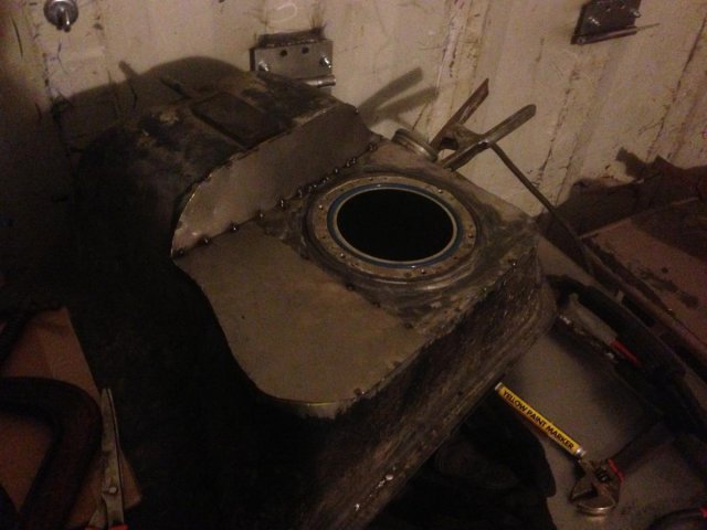

Just a little update here I have the pump and tank in the same place now. As it stands it looks like the tank is about 11" deep at the top. The pump can range from 8" to 9" with the spring loaded base, so it looks like I'll be sinking the mounting ring for the pump a couple inches into the tank. This works out for the best anyway because it'll allow me to make a nice channel for the wire and fuel line to exit the area.
I'm going to be using a 240z tank because the guy I was going to buy a 280 tank from stood me up, wasting a half day of my time and a bunch of gas and toll money. I'll probably make a couple of baffled boxes for the pump  and secondary draw tube to sit in.

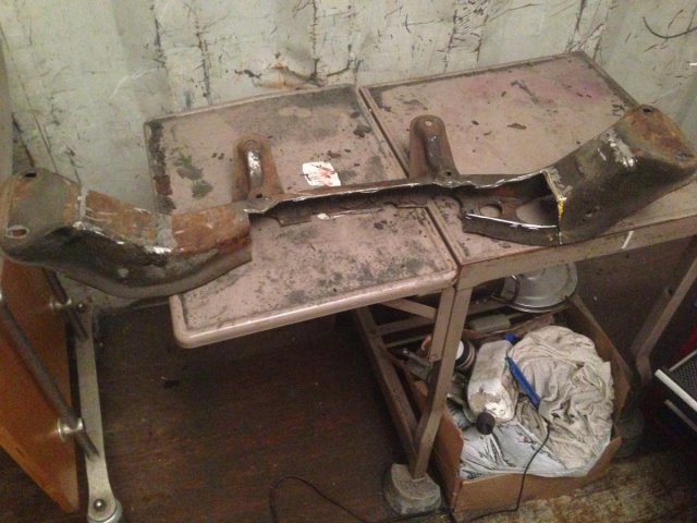

I also found an extra crossmember so I can start chopping that up before I tear my car apart.

Your mounts came out looking pretty sweet.  Did you have them plasma or laser cut?  What'd that run you if you don't mind my asking.
The Crossmember mods: There's a lot that has to be cut out of it. Austin's and Myron's builds  show it pretty well.  The HR I'm doing has a different cut out required since the bottom pan is different, not to mention the oil filter is much more forward.  That's one good thing about the DE engine. though that Plenum at the top is a pain.

Yeah the tank will be pretty involved. If my car was fuel injected to begin with and i had a pump, regulator and fuel injection tank already I would just stick with that. Lacking all that this should work though.
The mounts are mckinney. I ended up coming across a great deal on a used set here on HBZ with the shorter shifter mount. The pricing i got for the mounts came to about 200-300 anyway, which didn't make too much financial sense. I priced it with a water jet and laser cutting.
Yeah I have a good idea what needs to go from austin's build.

Another little update here. Friday night I brought the engine and trans to EvilC's shop. I had an hour to kill so I stripped the wiring harness, power steering pump and AC pump off of the engine. That's a nice 30 pounds off of the engine! I brought the mounts there as well. Car should be moving in the next week or so.

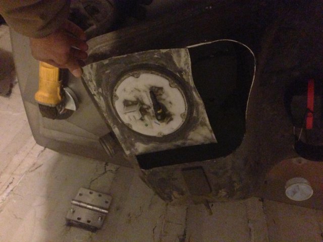

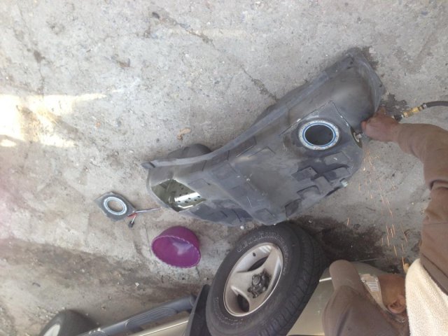

I also cut the mounting flanges out of the 350z tank. I'll be bringing them to my shop and cutting my my 240z tank up this week.

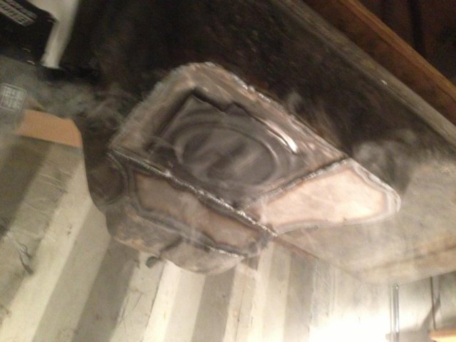

Bought a cheap smoke machine to check for pinhole leaks in my tank. Found a few and sealed them up. Will go over the area with a sealant as a final measure but otherwise I should be good to go.

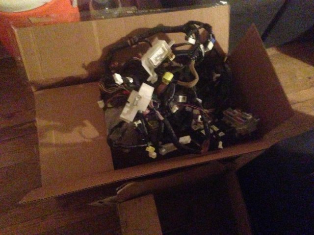

I also sent out my wire harness to get cut down and reflashed.
