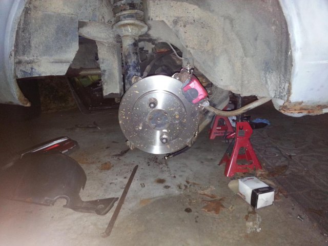

two4d Posted January 24, 2013 Share Posted January 24, 2013 Well, my computer decided to stop working this week while im gathering everything to do the rear disk conversion on my 280z. I'm fairly certain I had all my info I needed on the forums. Its a pain to do exhaustive searches on forums from my phone, so I'm appealing for help on here. Im using the modern motorsports rear brackets and 240sx calipers. I got zx rotors snd I believe theyre the wrong size. The caliper and pad are only contacting about 50% of the rotor. What rotors should I be using? Quote Link to comment Share on other sites More sharing options...
JMortensen Posted January 24, 2013 Share Posted January 24, 2013 You should be able to find this on MM's site, but I believe that you should be using the early 300ZX rotor. Quote Link to comment Share on other sites More sharing options...
SUNNY Z Posted January 24, 2013 Share Posted January 24, 2013 I thought they were just S13 240sx rotors...? no? Quote Link to comment Share on other sites More sharing options...
