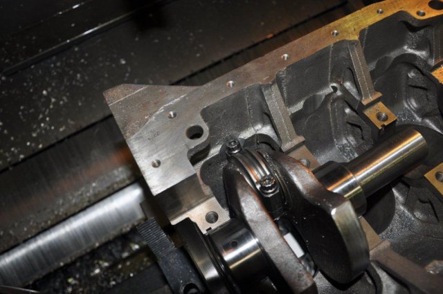

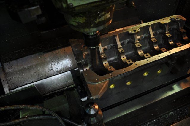

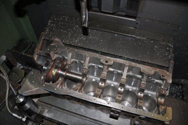

PMC raceengines Posted February 10, 2013 Share Posted February 10, 2013 I do my engines with a mill now and i leave at least 1.2mm , i also made a crank and rod with the big stroke to check , so i did not have to fit the good crank in a dirty block , Quote Link to comment Share on other sites More sharing options...
PMC raceengines Posted February 10, 2013 Share Posted February 10, 2013 By the way the pics are a 96mm stroke with honda rod ... Quote Link to comment Share on other sites More sharing options...
